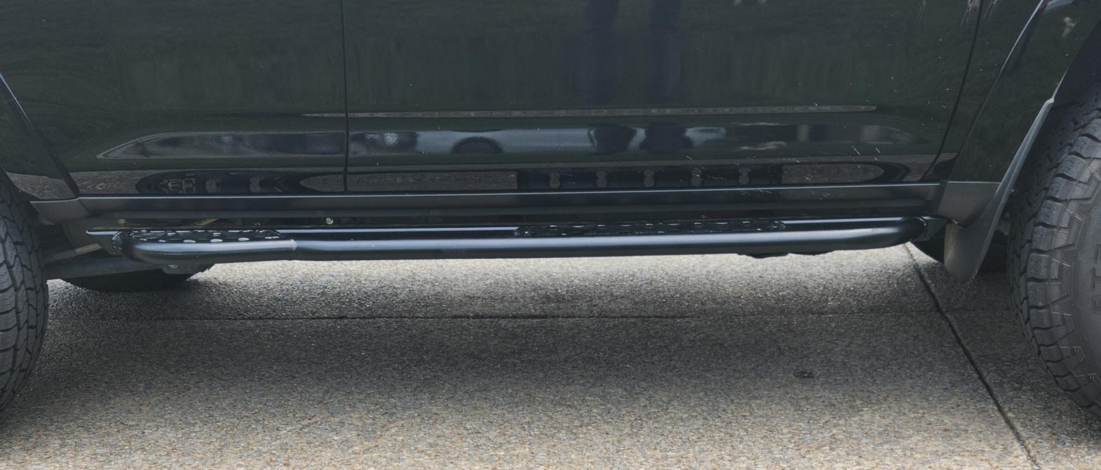

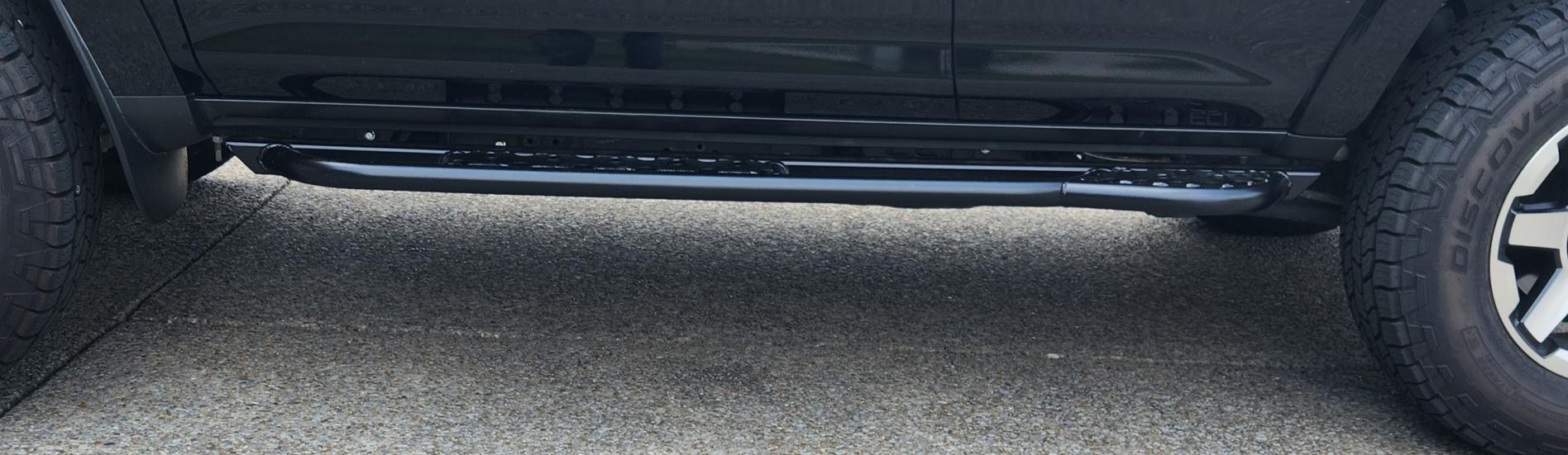

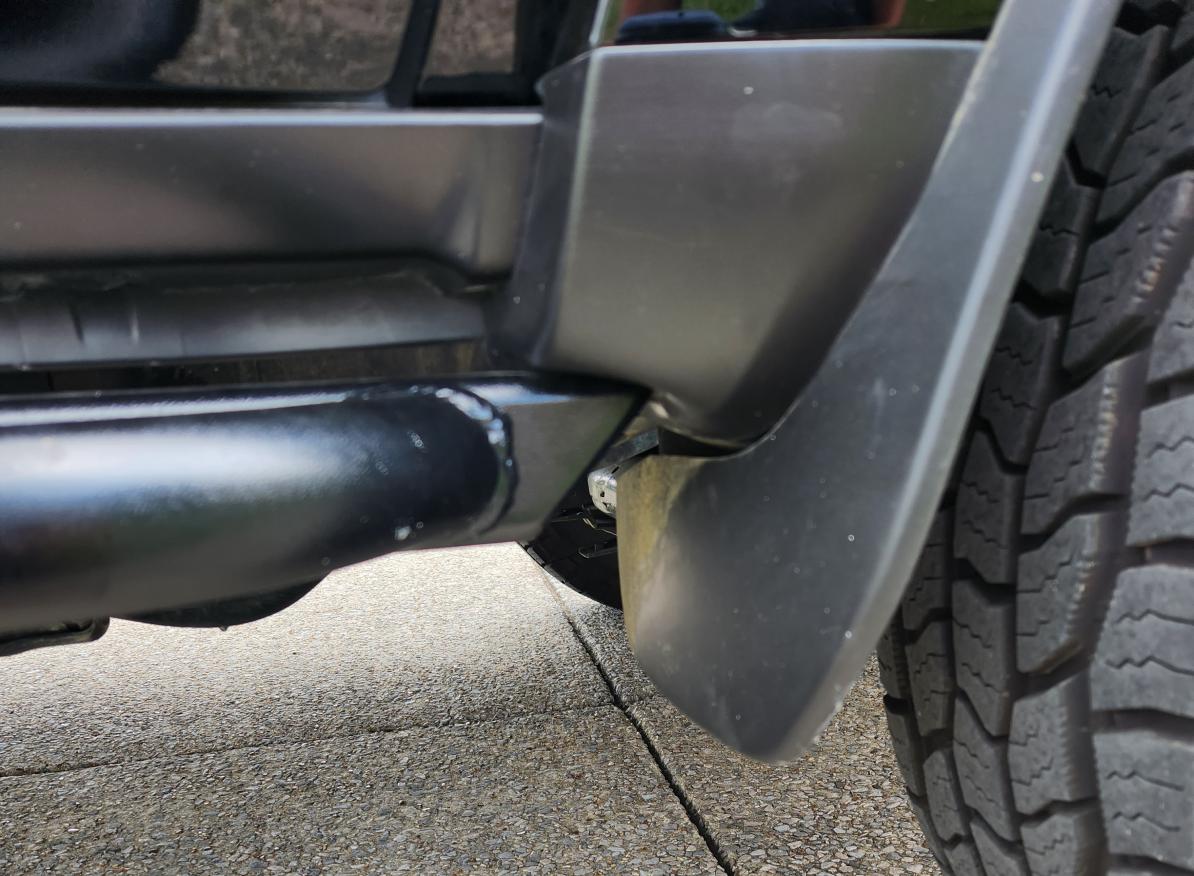

So I installed my sliders on my 2023 4runner TRD ORP and the fitment is off or I installed wrong. The driver side fits perfectly but on the passenger side the slider sits too far forward and high and crushes the plastic muflap trim. There is a little adjustability and I've moved them as far back and low as possible and still no luck. Am I missing something. It appears to be causing a creaking noise when driving on that side and I'm guessing it's the crushed plastic mudflap contact on the slider.ive reached out to SSO to see what they say and will update you guys. Just seeing if this had been an issue before.

At this point, I would remove them. You are only damaging more parts.
Reevaluate and if you installed them correctly, then reach out to SSO.
Update:
Contacted SSO and sent them pics. Appears the wrong legs were attached to the passenger side. They are sending me a new one this week. So extremely happy with their customer service so far. Love their design and they seem rock solid with great customer service. So I'm pretty happy with the way its been handled.
