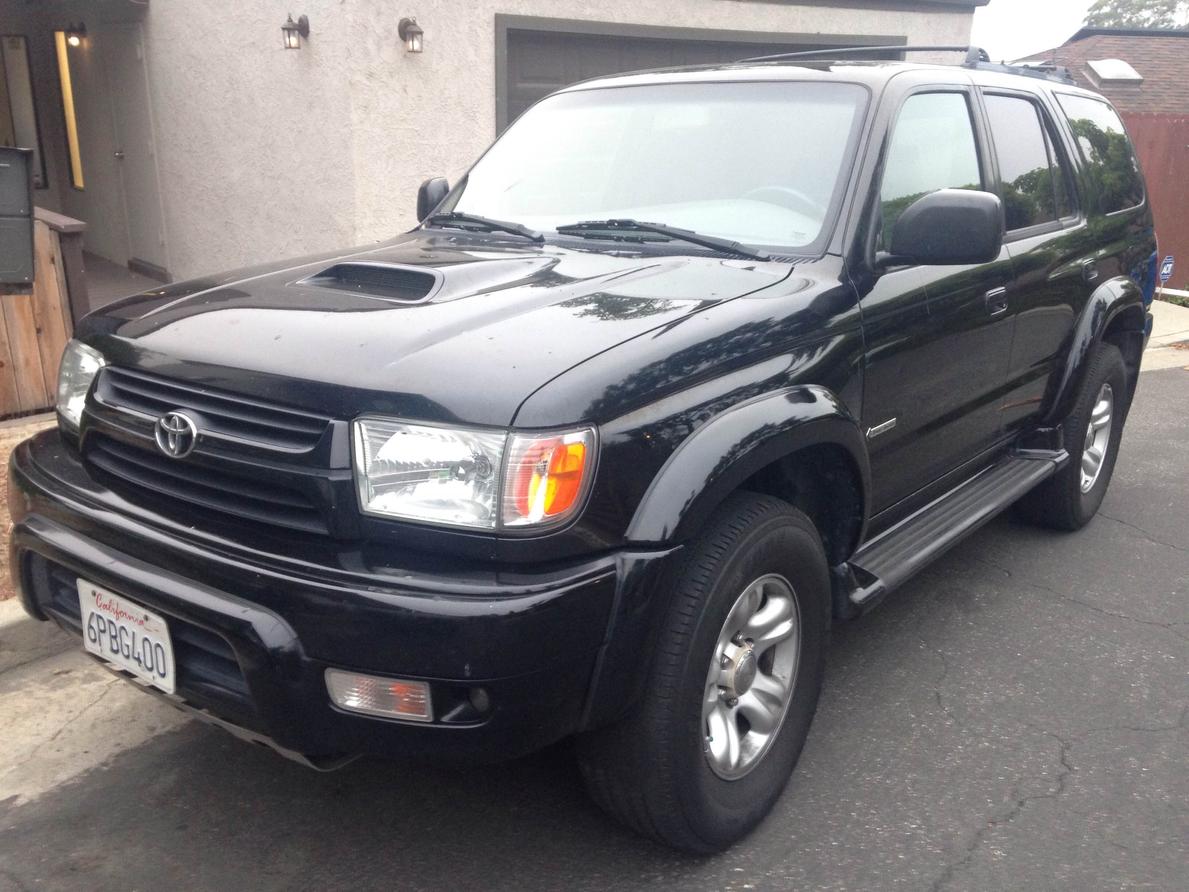

I picked up a 2002 4Runner 4wd last week to explore off roading. I got her up from the original owner for $5000, 215k, all original paint, rust free underbody, totally virgin, never seen dirt
Until......

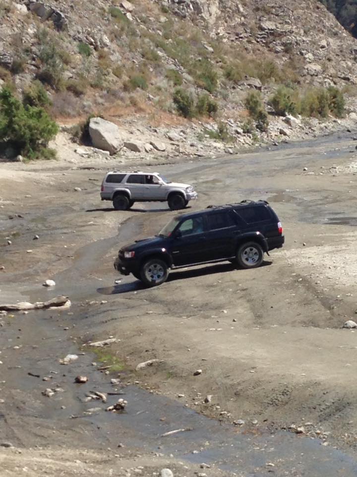

This past weekend :) With bald tires and all. Poor truck had it way too easy all these years.
Current plans are to keep it relatively stock, with just tires (265/75r16 Copper ATP's on the way), rock sliders and external trans cooler / factory cooler bypass.
I was hoping for some input on a few things.... Anything else I should be carrying or changing on her. I'm totally new to off roading, so even the obvious would be helpful.

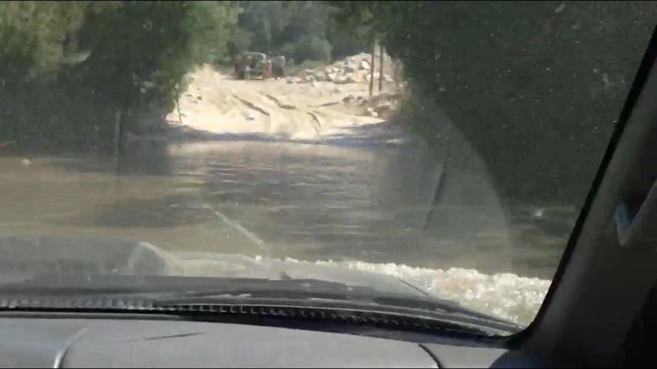

If you were fording water that deep with bone stock truck, I'd highly recommend checking or draining your diffs and T-case. Especially the rear. It's probably got water in it. That's not good. Maybe add an extended rear breather to your list.
I feel bad for all these trucks that ford water all the time. Causes failed wheel bearings, starters, and diffs fool with water. NTM is a pain to clean when mudding. I stick to studying dry unless 100% necessary.
Shows you how much of a noob I am, I totally forgot there area breathers all on gear housings.
