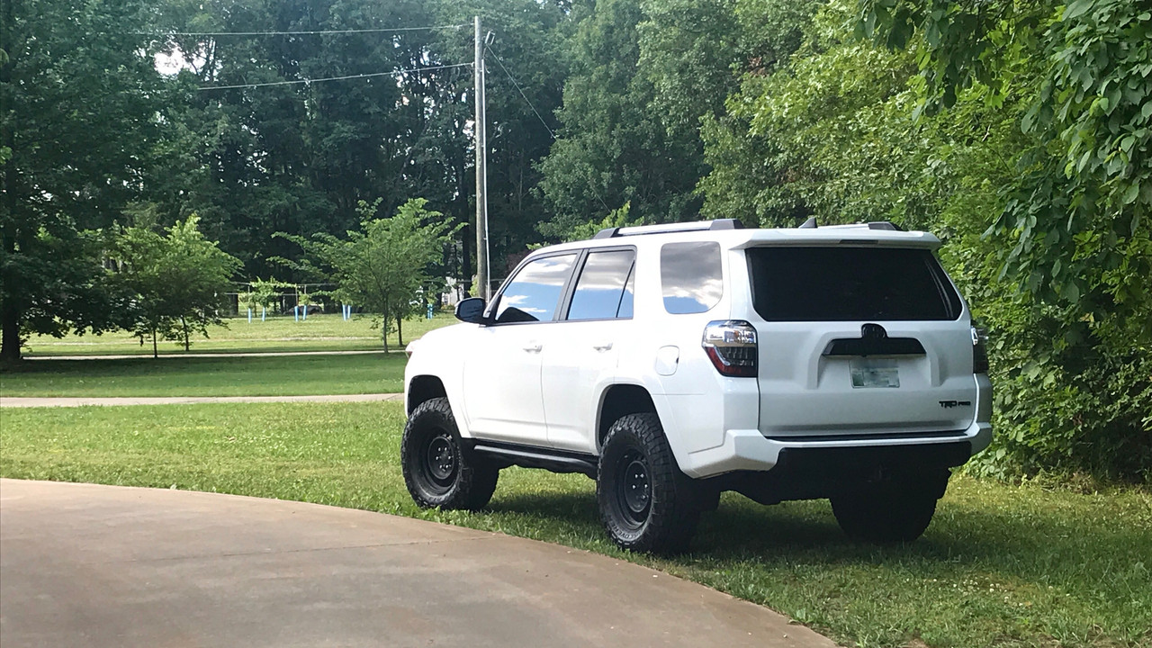

I want to bump this and see if anyone can confirm or deny if the FJ center caps will secure correctly to the T4R wheels, these will be for a set of Jeep 255 KMs to go on my 2015 Tacoma.
And the offset is the same for the T4R rims correct? Just a stance difference as in wider stance by .5 inch or 1" for thr whole track.
Toyota lists 2 different steel spares for the T4R
42611-35400 are the 17x7"
42611-35430 are the 17x7.5"
FJ is listed as 32611-45330 17x7.5"
Also does anyone know the difference in the FJ wheel and the 7.5" T4R wheel?
From pics online I don't see much at all.

Late to the thread, but yes, the FJ caps do fit on the 17 x 7 4Runner wheels.
FJ Steelies
