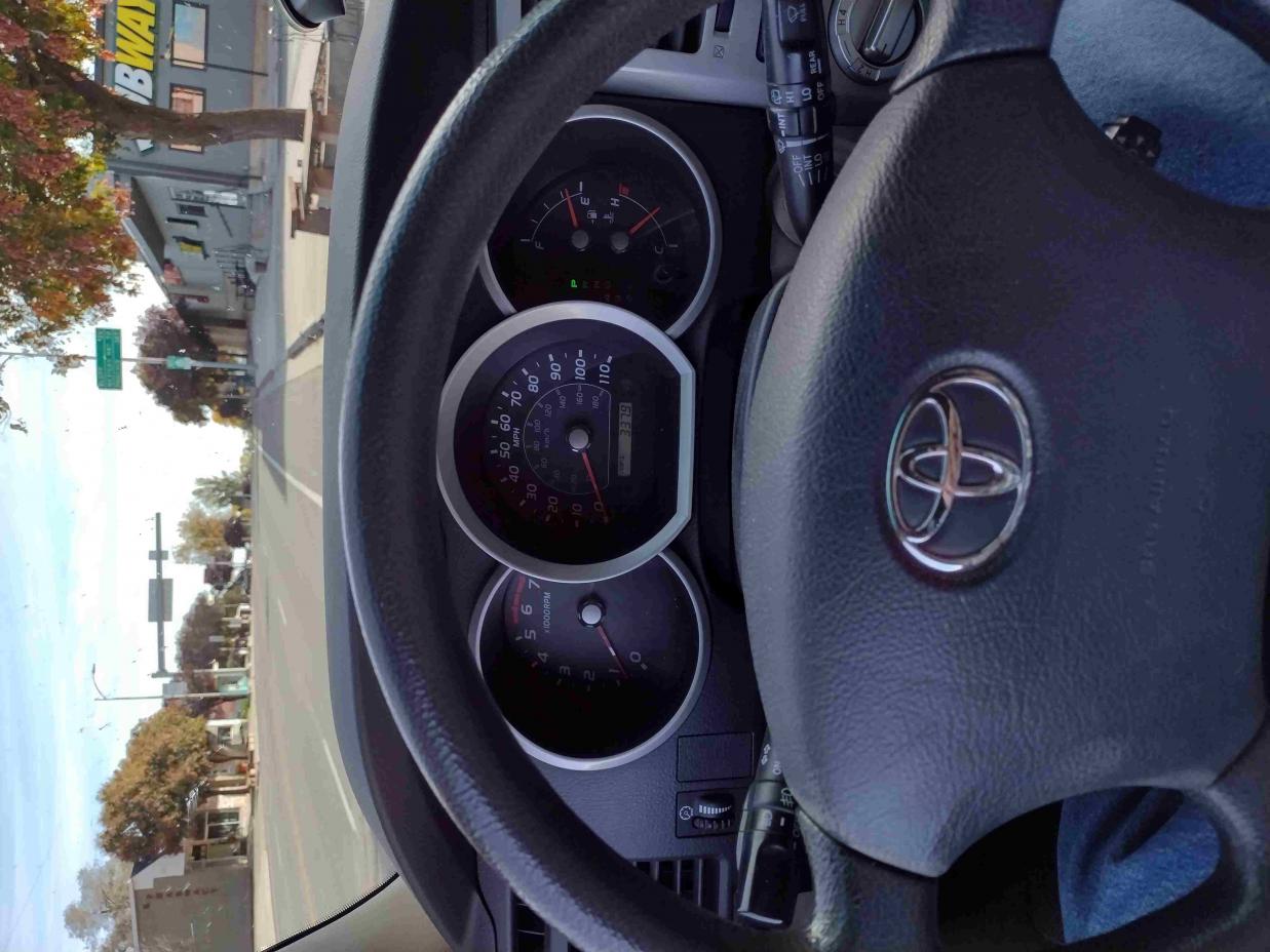

Just back from a trip to Utah. Truck ran great, got ~22-23 mpg overall. We did some minor off road trails, none of which required 4WD and none of the trails had anything that could have bent, bashed or damaged anything. On the way home, I noticed the steering wheel Off center to the right. Prior to this it was perfectly centered. (pic attached) There are no indications of anything wrong. No shimmy, shake or vibration. Steering tracks true (1/2 mile w/both hands off the wheel stayed in lane) No new or unusual noises. Before I take it to the alignment shop what should I check?

It's always good to have your alignment settings marked in some manner so when something like this happens you can easily check and see if anything moved. Maybe a rock banged one of your tie rods? Do you know what your toe setting was before you went out?
Swap the front tires and see if the symptom goes to the other side. If a tire belt has slipped or broken it can cause a pull to the side. Just because the car stays in the lane it doesn't mean you are in alignment. I'd swap the tires and if that doesn't do anything then I would have an alignment done.
Got the alignment done. No big difference in the before & after specs. He said he couldn't tell what moved. Oh well.....

I've heard rumor steering racks can skip teeth though I would assume this would be mostly during offroading. Probably not worth worrying about at this point with it fixed.
