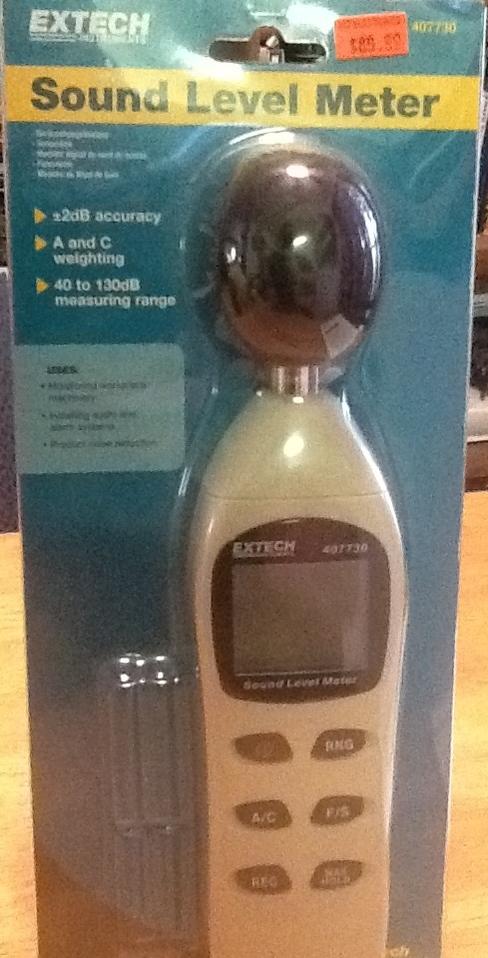

So I brought home a sound level meter that we use at work and tested 'em. Just wanted to share my findings of this not-so-technical testing. Meter is a Extech (made by FLIR Systems) sound level meter, 40 to 130db range, accurate to +/- 2 dB. Model 407730 if you think it's important enough to know.

Meter to front grill distance, 10 feet
dB average, 3 honks= 87
Meter to grill, 6 feet
Meter to grill, 3 feet
dB average, 3 honks= 89
Meter to grill, 0 feet (right up in mah grill)
DB average, 3 honks= 89
Nothing exciting, nothing suprising. Just thought it might help if someone were curious and looking for the info.

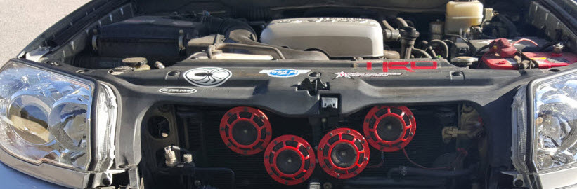

I bought the Hella horns about 10 years ago, got a second set just for fun.
I can tell you they piss people off when you blow them because i always get flicked off, even if the person i am blowing them at is to blame.
I think i got them from Susquehanna motorsports... rallylights.com or something like that. The sets i have are the actual German made ones. Now I think they are made in China.
With what I'm seeing, four horns is likely the route I'm going to go. I wonder what a set of sharptones and supertones all going off at the same time would sound like? :)

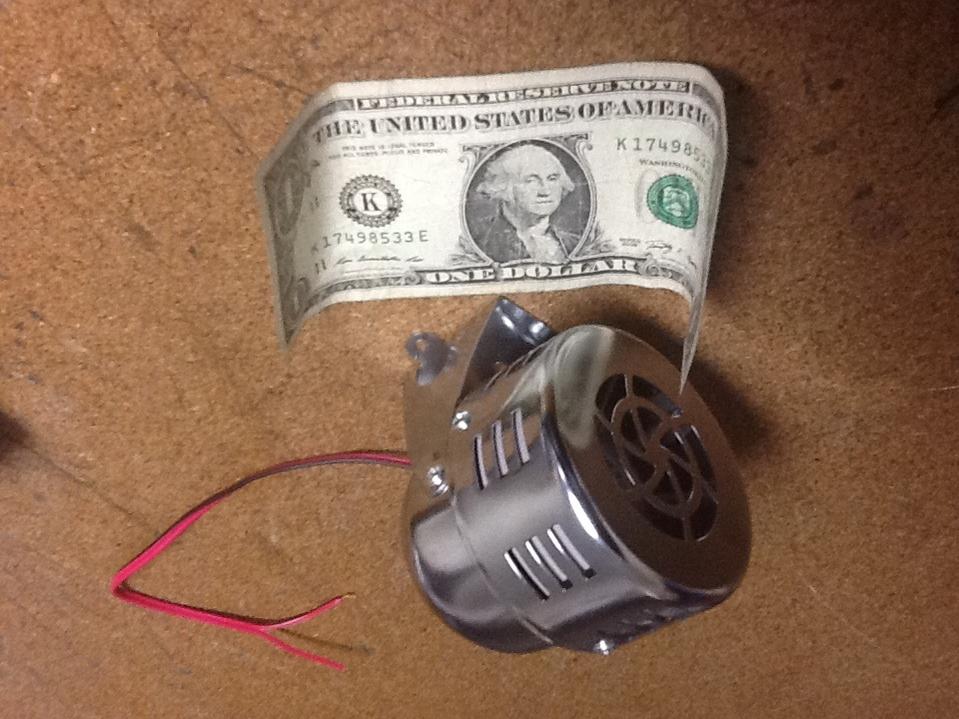

Another option I came across in my search for replacement horns that are louder, wont kill my wallet and are NOT train horns: I found an inexpensive air raid siren on FleaBay. Advertised as 130db, with "much loud, very big noise".. Their words, not mine. Anyway, shipped to my door it was less than $10 bucks. Why not, I'll give it a shot.
Well, it arrived. I must not have read all of the details or they possibly omitted the fact: this siren is a whopping 3" diameter. Physical presence, very underwhelming. Also, judging by the construction, I'm not sure I would trust it in a wet environment.. But there's bound to be some cubby in my engine compartment that it could be mounted to avoid that, right? (shrug)
It's definitely louder that it looks though, and pretty shrill to boot.
I used the same meter that I used to measure my OEM horns:
129dB @ 1'
109dB @ 3'
108dB @ 6'
106dB @ 10'
I made a short video that I'll try to get uploaded tonight. I'm not digging this for a horn replacement, but if someone were just looking to augment what they had it could be worthwhile. It takes a split second for the little turbine inside the siren to get up to full speed, so I don't think it would add much with the occasional short beeps I use to keep someone's attention where it needs to be. Hell, it would definitely be loud and annoying enough for a backup alarm!
The search continues!

old pic of mines
