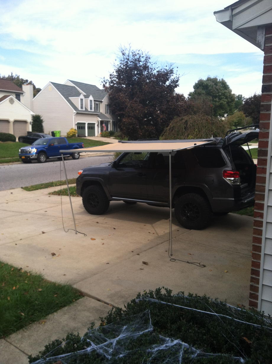

Aren't these awnings great! I love my ARB.
Except- driving down the road with the windows open- "jinglejinglejinglejinglejinglejinglejingleJINGLE!!" GOD- make it stop already!
LOL - The zippers make the jingle sound. I was zip-tying them, or tucking them inside the awning- but that left a gap between the zippers that must've looked like a Holiday Inn for stinkbugs...

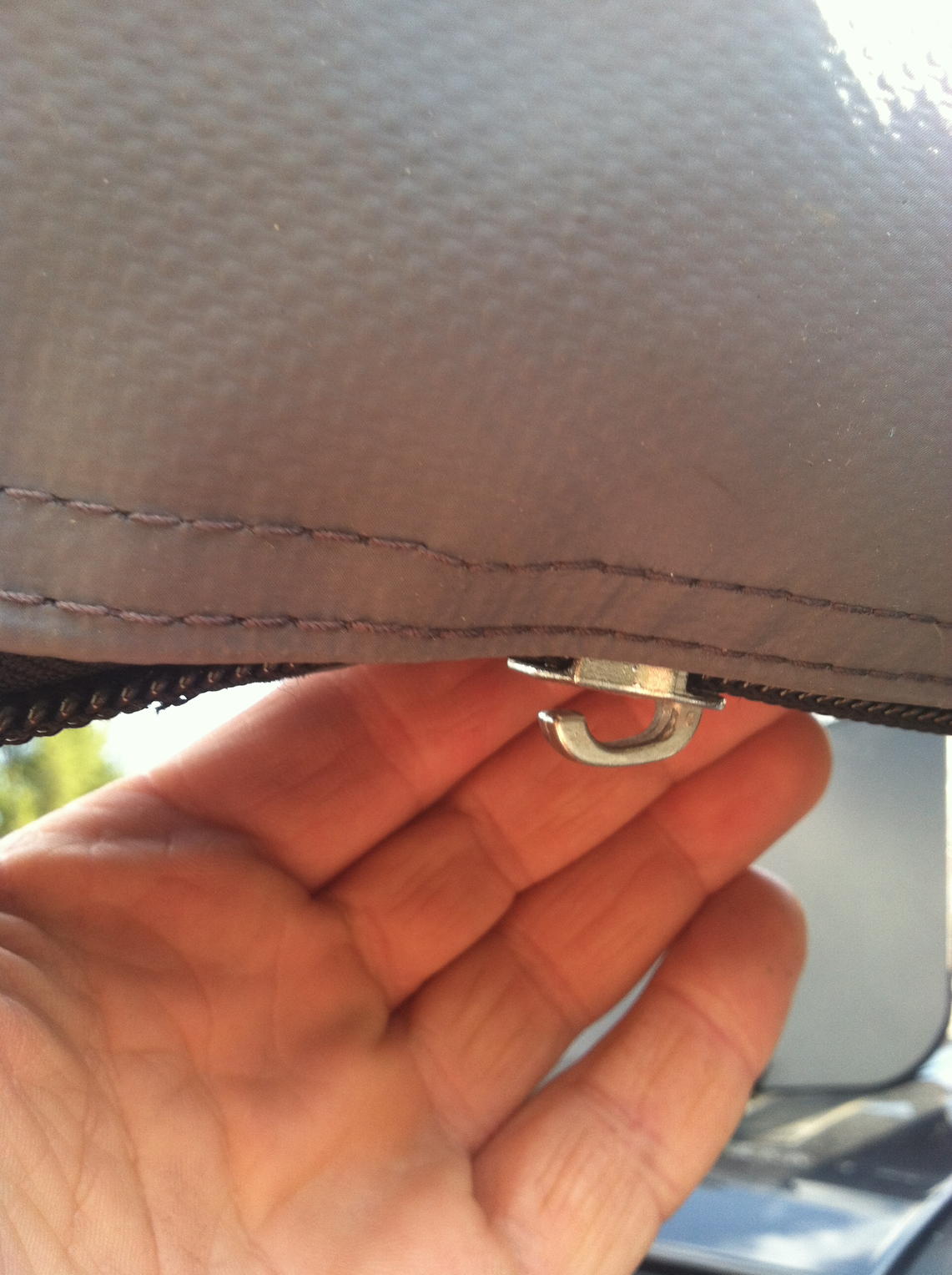

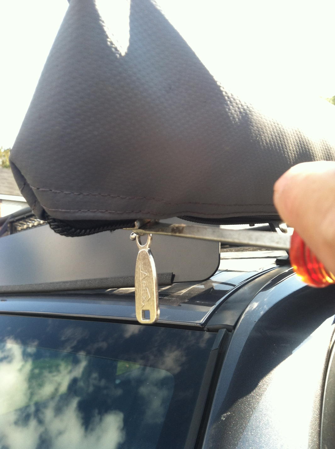

First you need to remove the zipper handles. Carefully pry the catch open- just a little bit more than needed to get the handle off. Like this:

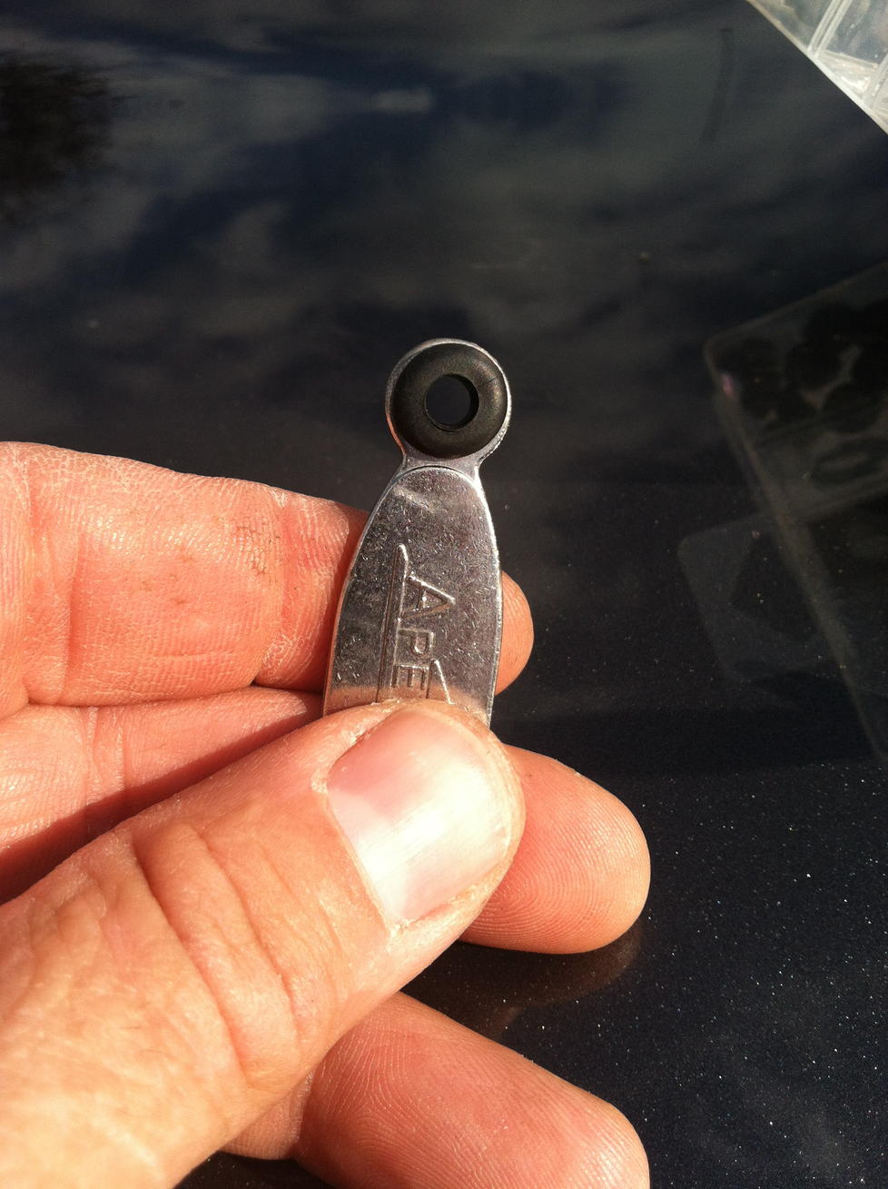

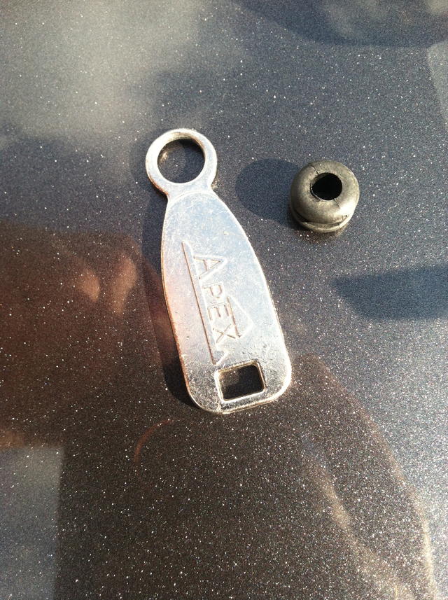

Attach the rubber grommet and slide the zipper back on (an angle works best).

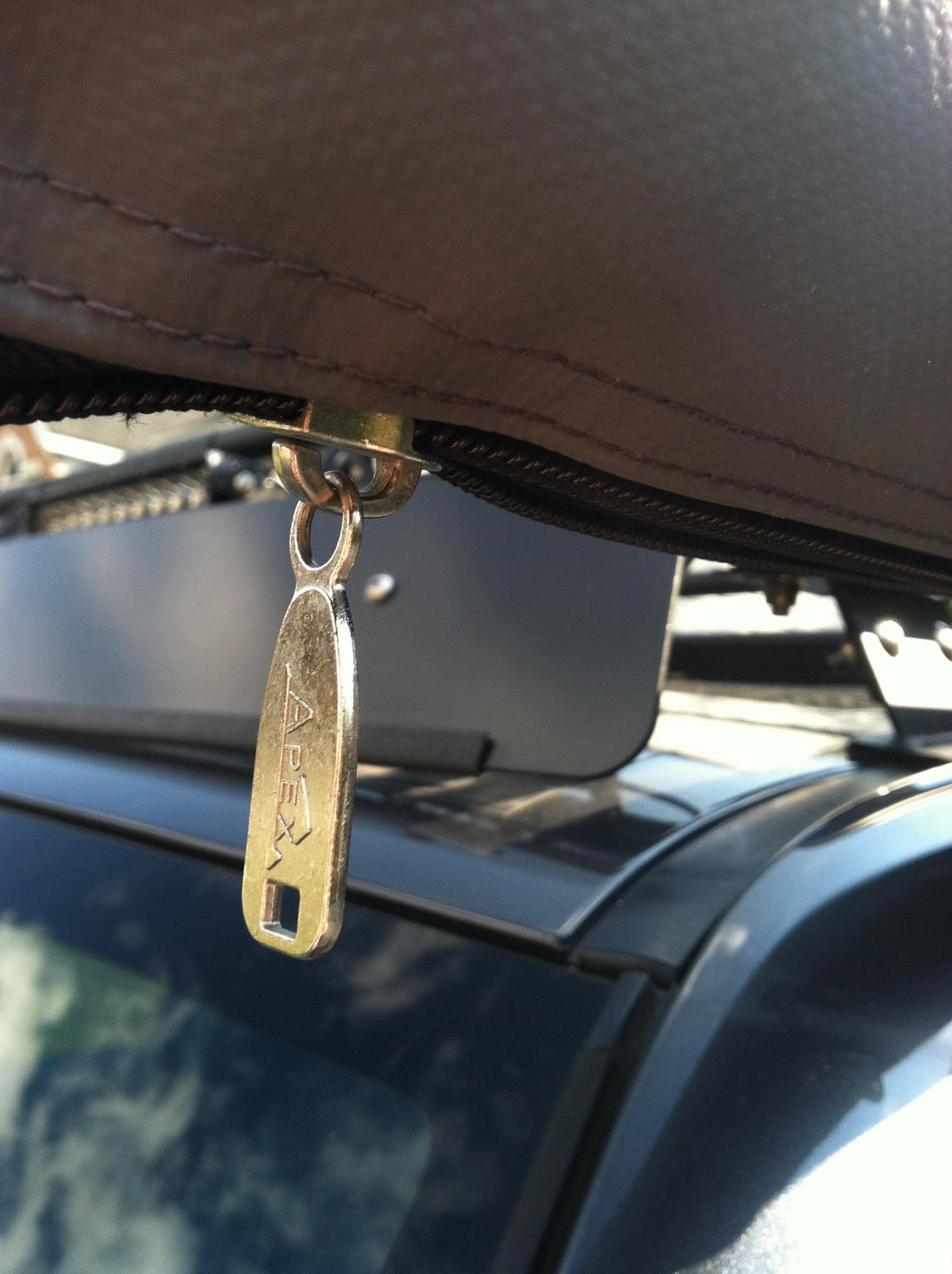

Now- be careful with the plastic zipper(!) and crimp the catch back down with some pliers like so:
All done.
Hear that?
Exactly.
