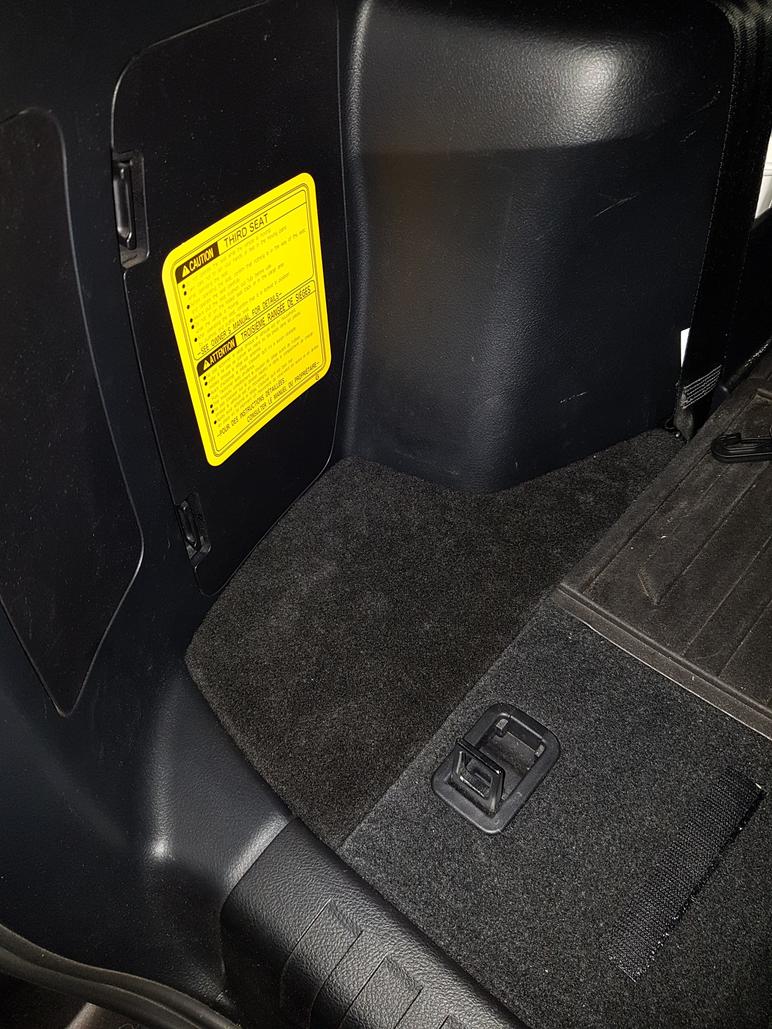

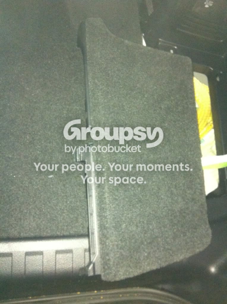

Anyway, there are two compartments that toyota did not care to make useful for us. They are on the sides of the third row seats by the back tail gate. The floor plastic (with carpet covering) is independent of the hinged floor covering the seat bottom in the middle of the cargo area. To get the side floor covers off: Pull up on the side plastic starting at the front near the 3rd row seat belt. Pull on the outside and hinge up toward the center of the cargo area. You have to pull hard.

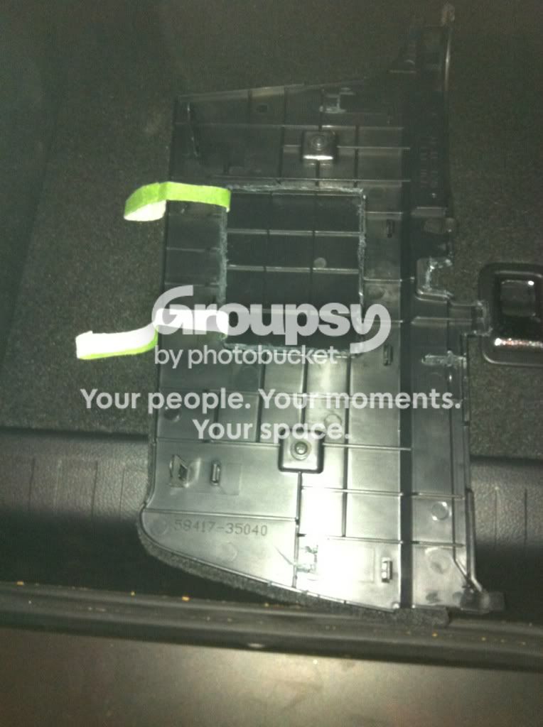

After you remove the plastic false-floor panel, start to cut with a dremel. Cut off the center support leg (tube), cut the stepped clip that fits under the tie-down anchor (don't cut the whole clip, just the step portion) trim down the front long piece of plastic, and trim off two of the punch clips (long thin clips). Leave the two clips that are on the outside edge of the panel.
I have left the cut edges rough in this picture.

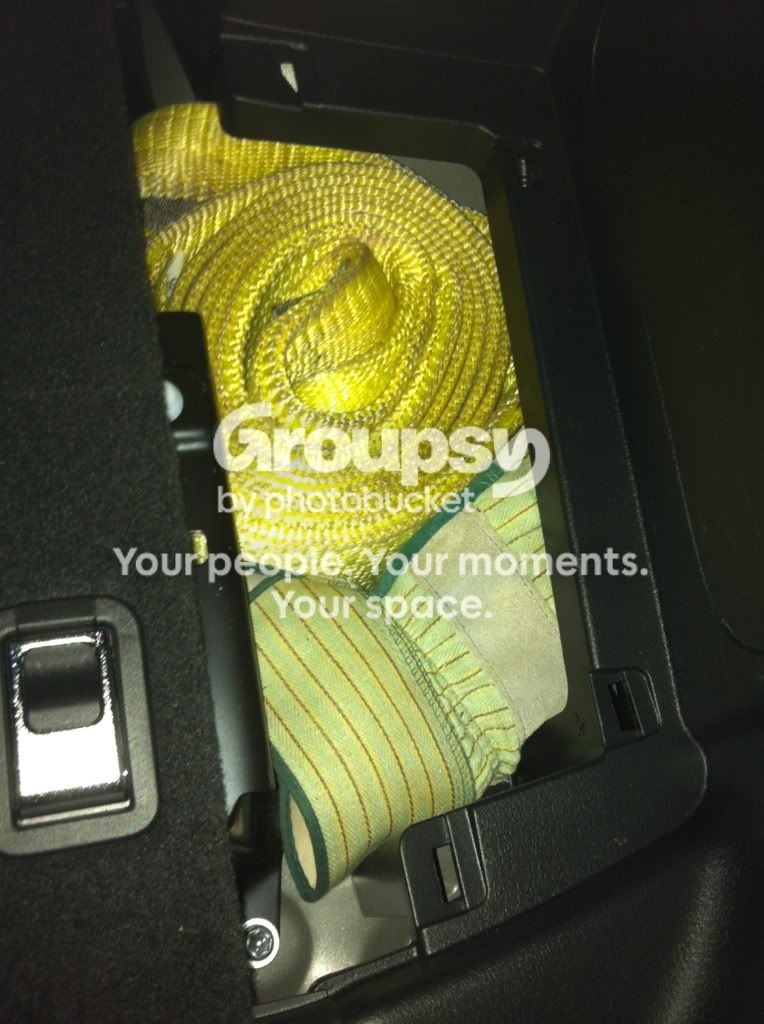

Thread two flat pieces of ribbon or rope between the two panel pieces (through the center hole where the support leg used to be) out to the outer side of the panel.
Now you should be able to slide the flattened tabs under the center portion of the cargo area, keep the rope loops up so you can use them to lift the panel, and now push the panel down at the outside edge until the two outer clips snap closed.
Repeat on the other side.
You now have two hidden compartments for less-used stuff.

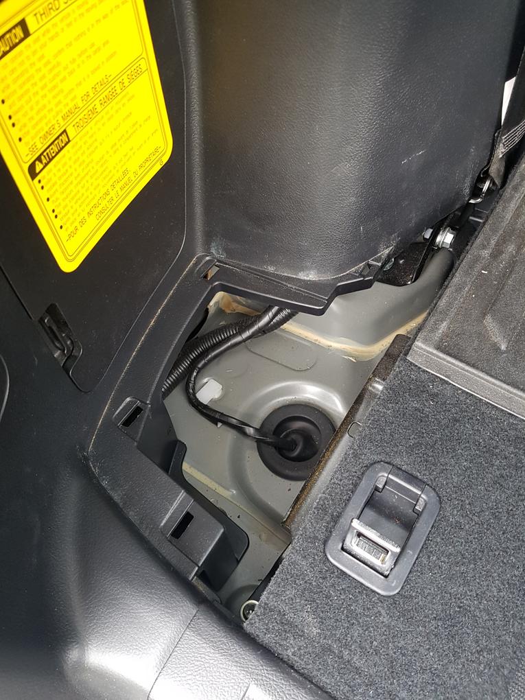

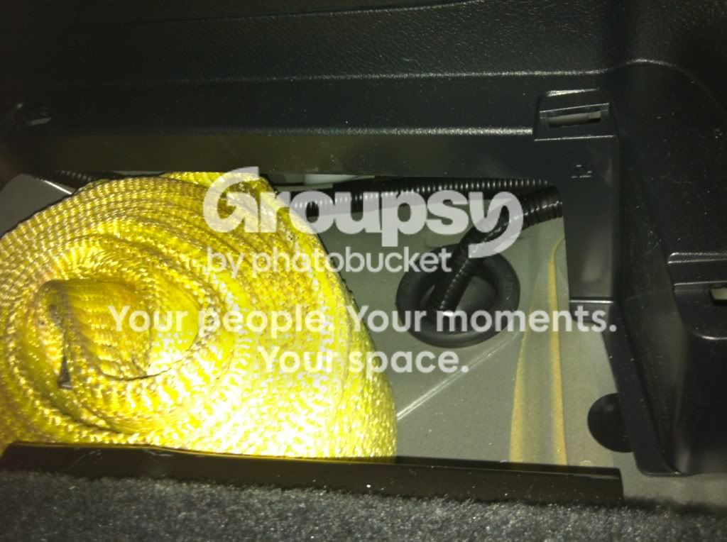

Once you pull the panel, you can see there is a decent amount of space being wasted in the corners.

I cut the "stepped" portion of the middle left tab in this picture so the left side of the lid slides easily under the middle panel. I also cutout the female "tab" that would slide into the button near the tab.
ca306267.jpg~original

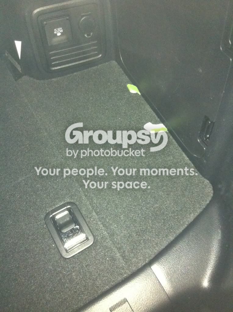

Finished product (with temporary ribbon)

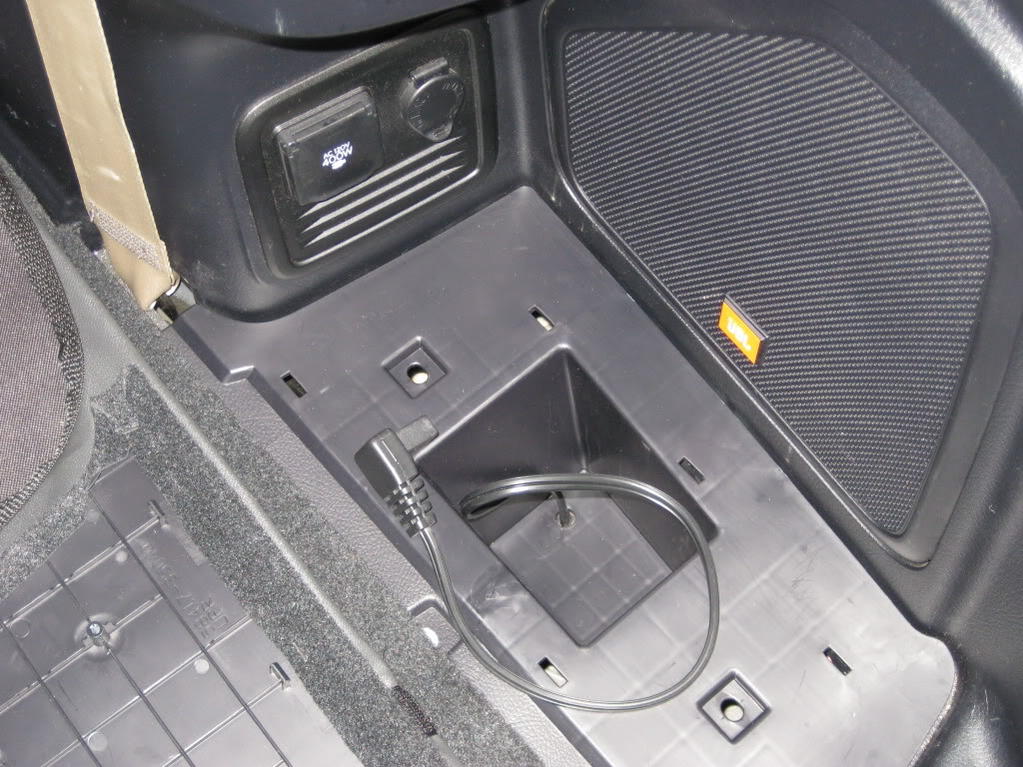

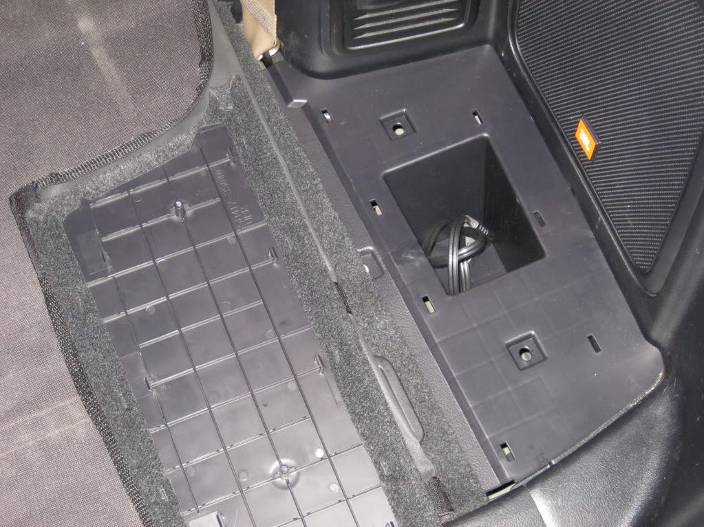

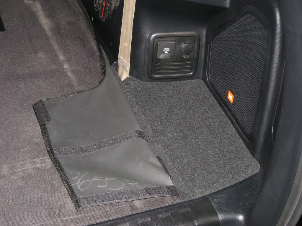

I'm pretty sure he's talking about this, right?
Pics from Kingpin's build thread...
That is the same area. These pictures show removing the upper piece of plastic cover. I removed both and cut out the depression (what I called a leg) that is in these pictures.
If you pull up on the floor panel from the front, the whole unit (two pieces screwed together) will come out together. Once it is out, you could remove the two screws that hold the upper piece of plastic and have access to the small depression as shown in the pictures.
I wanted to get to the unused area below the plastic false-floor.

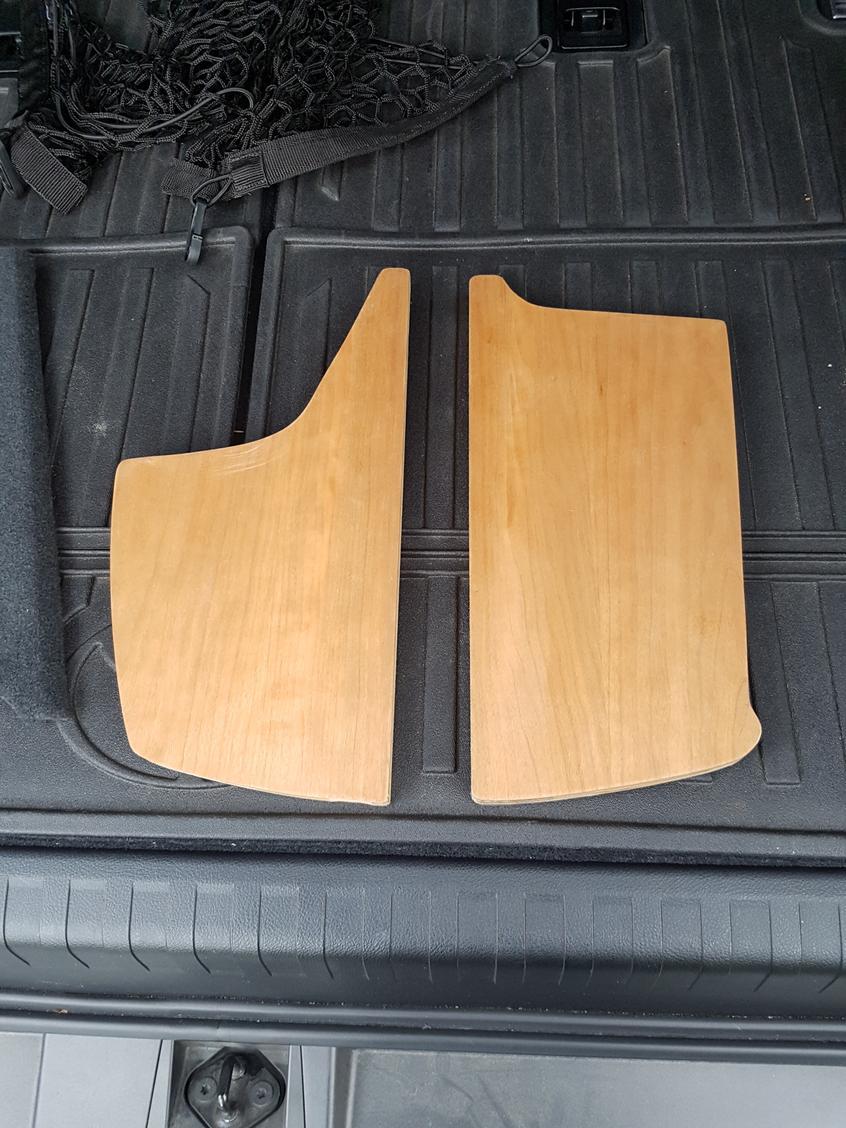

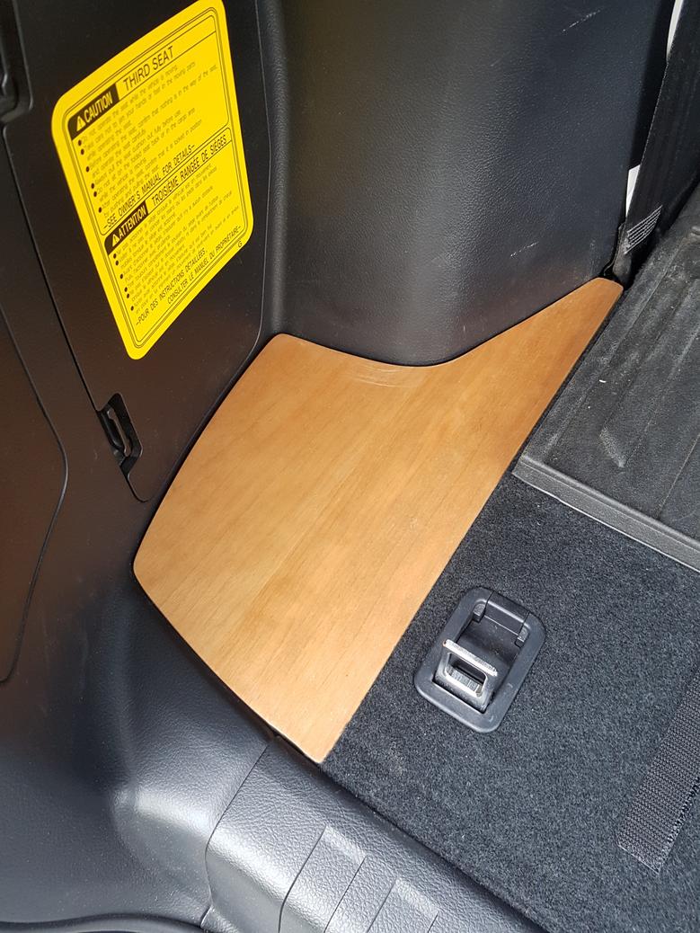

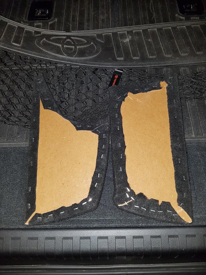

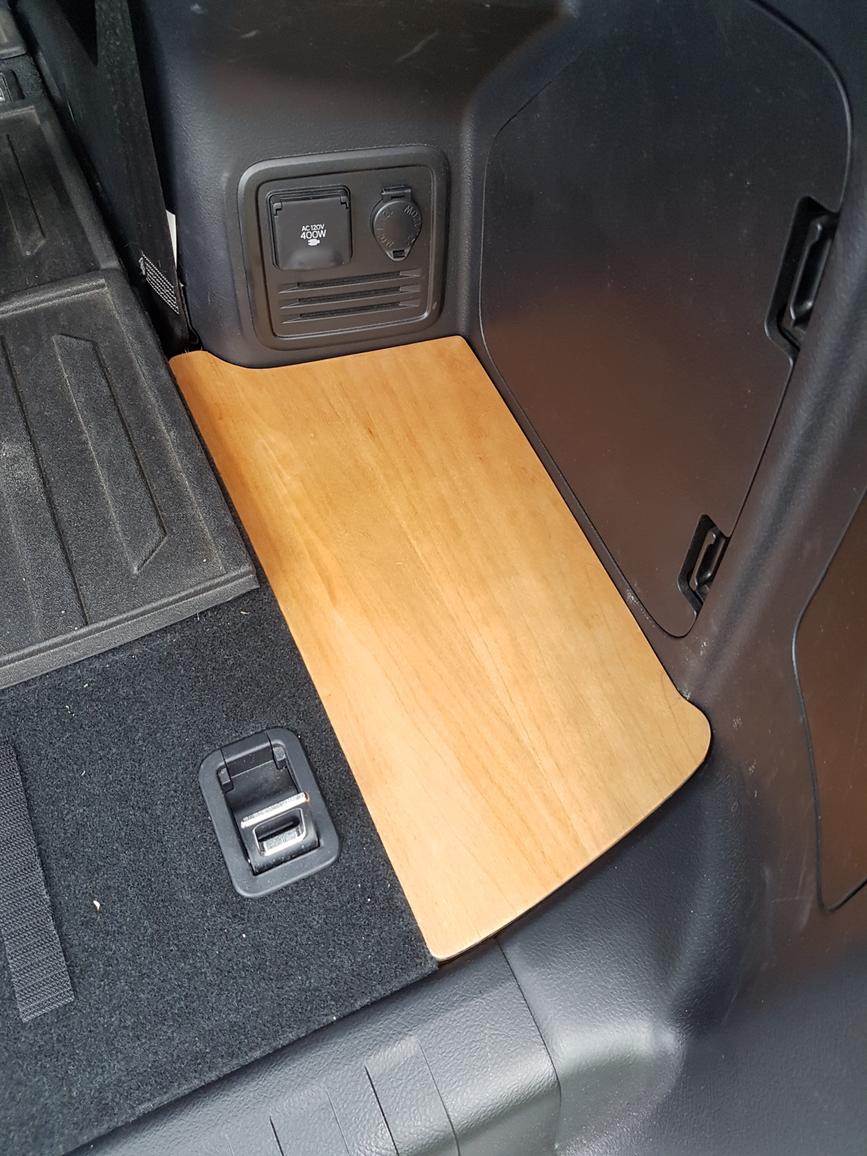

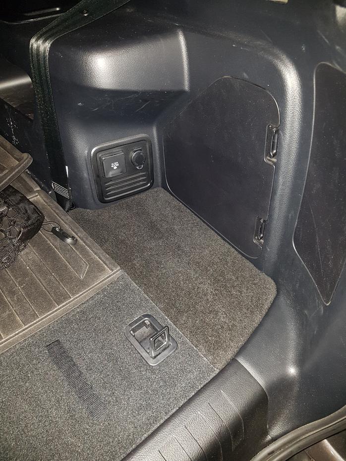

Here's my version. Removed the 2 pieces on both sides to access the opening. Traced out the shapes of the carpeted pieces onto 5/8" plywood. Wrapped in trunk liner I found at a hardware store. Colour doesn't match exactly though but it is not seen since I have the cargo liner. Fits like a glove. If I did it over again I would trim another 1/8" off around the wood shapes to accommadate the thickness of the liner.
EDIT - you need to remove the floor panel to access the pieces on both sides. See link for more details.

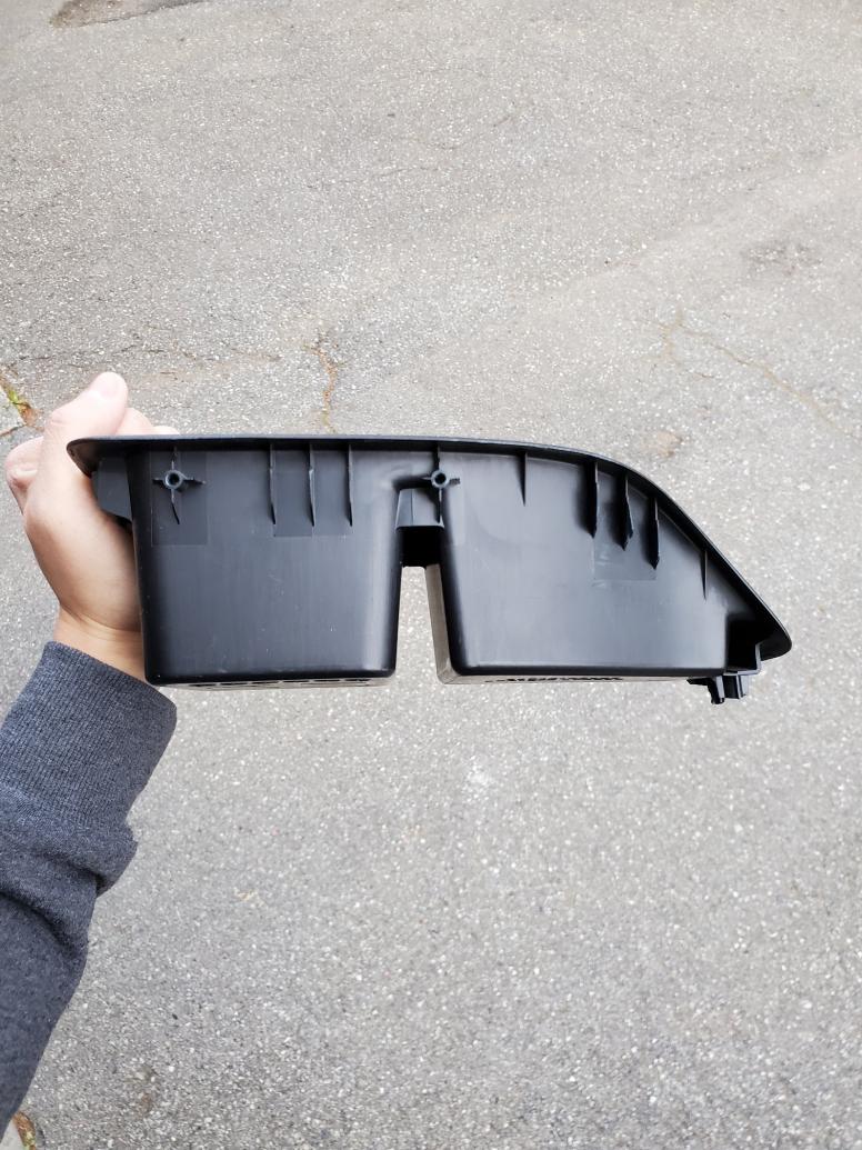

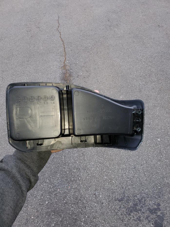

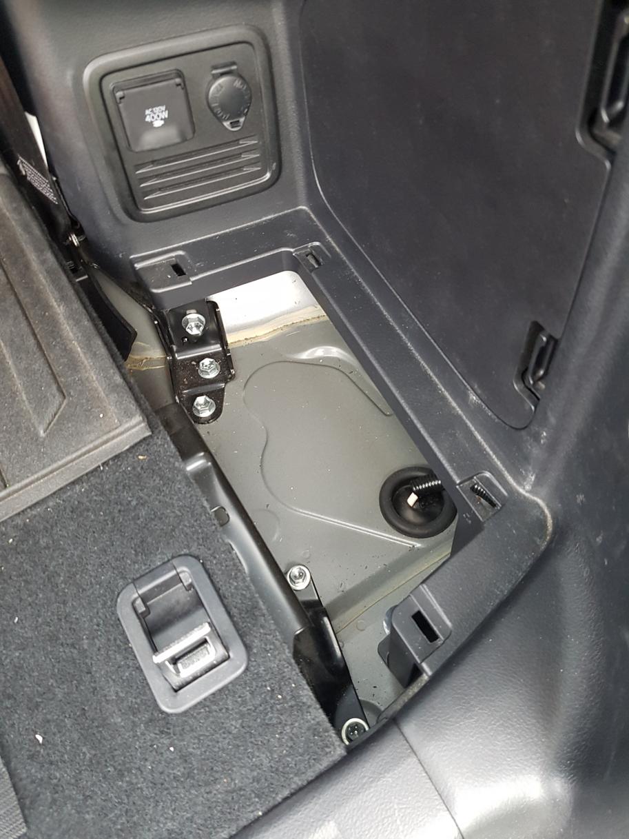

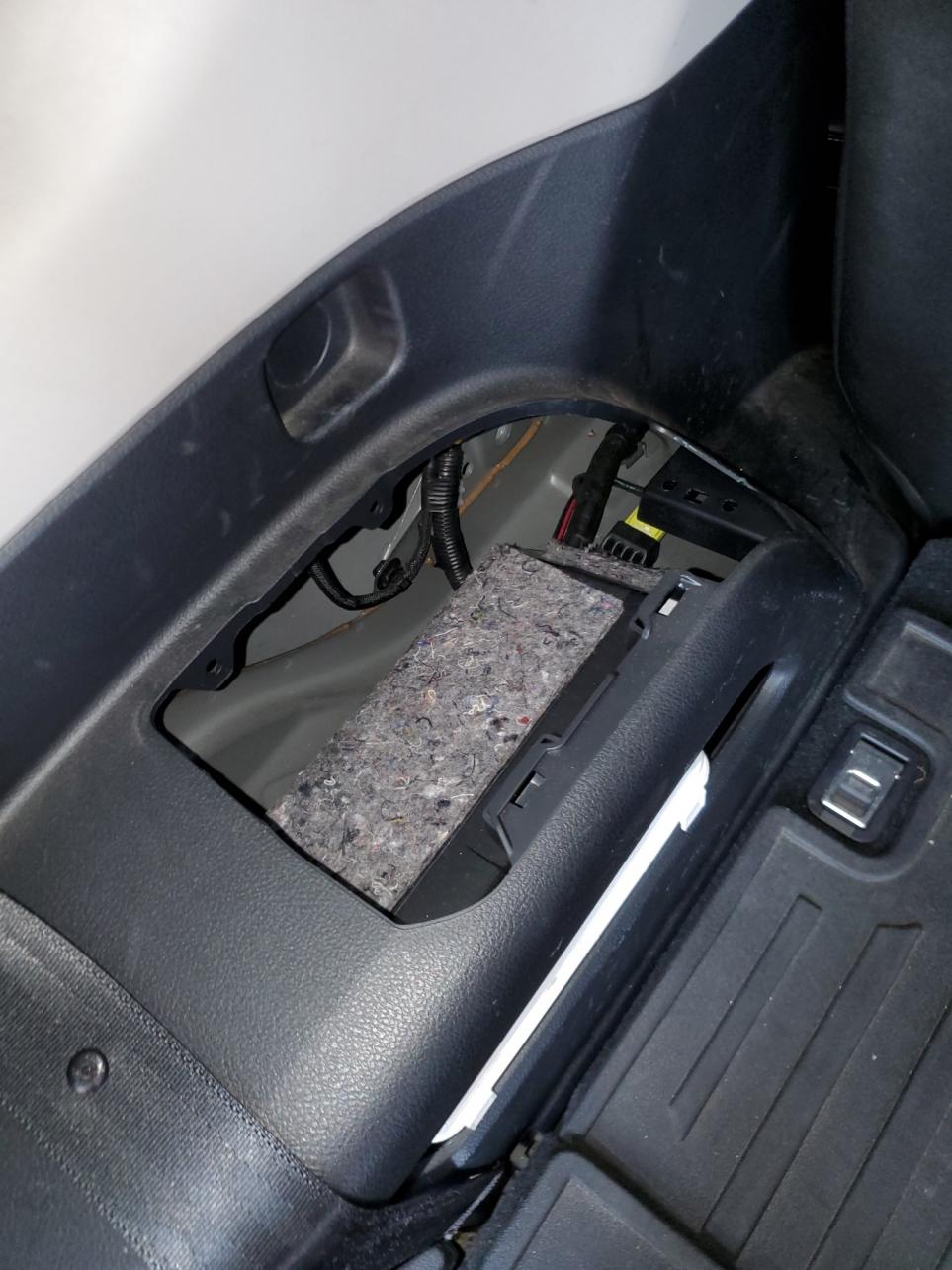

FWIW there is a lot of space in the wheel well. Once you remove the panel with the cigarette lighter you can access the 4 screws to remove the wheel well pocket.

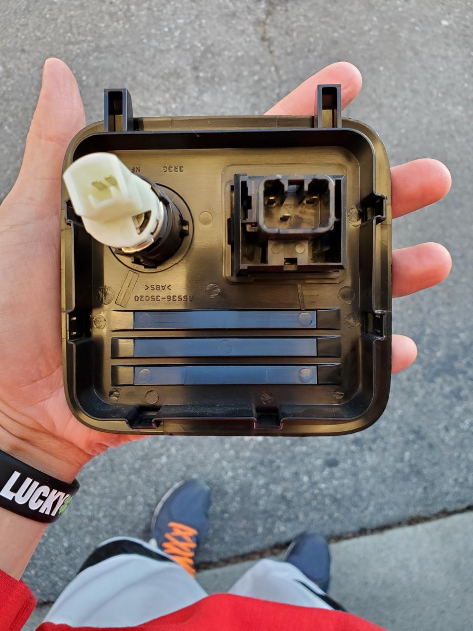

Here's what the panel with the cig lighter looks like. It just pops out.

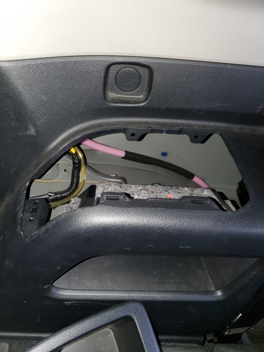

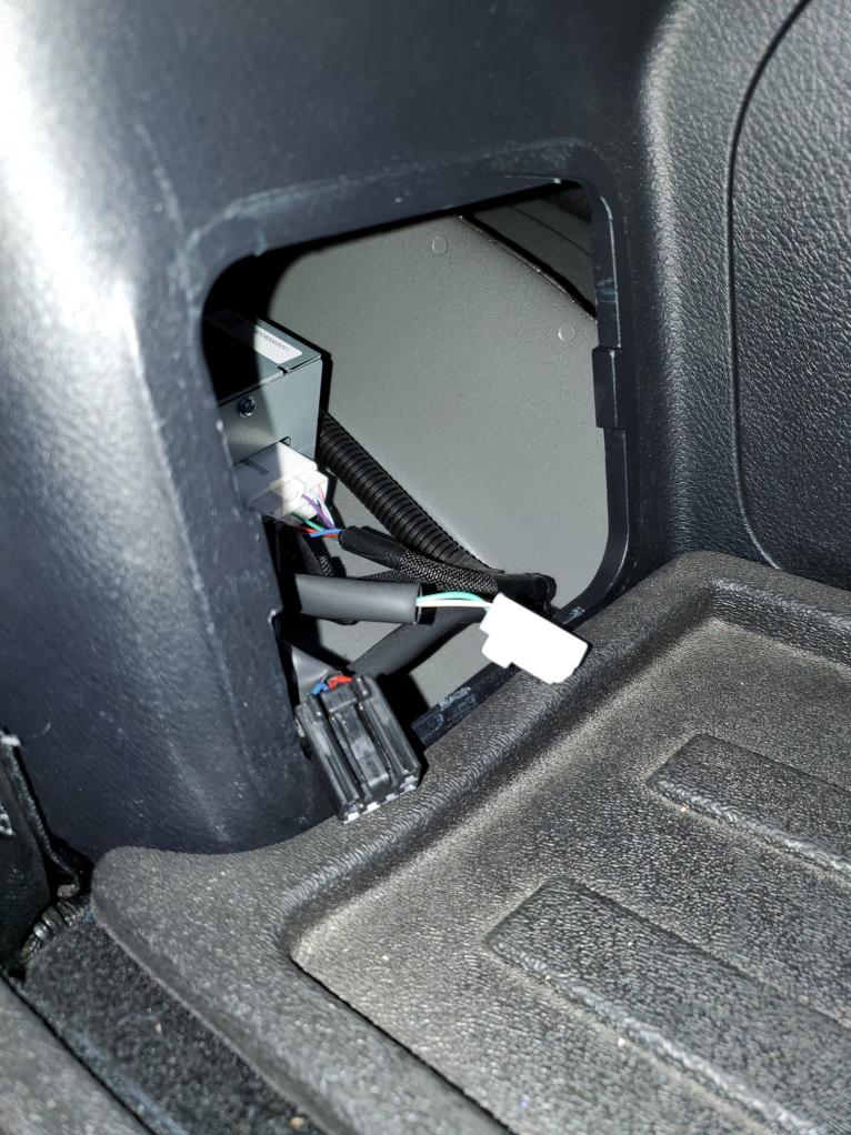

I got bored the other day and decided to take off the driver side rear well pocket as well. You can reach the screws by reaching through the jack opening.
