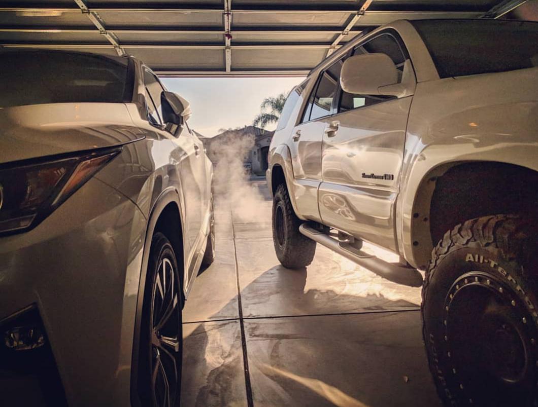

I've been overseas in India for almost 3 months already, but anticipate an additional 3 month stay here.
My 4Runner and wife's RX are both currently stored in our garage.
Prior to leaving, I did the following:
- Filled the fuel tanks completely.
- Inflated all tires to the proper PSI.
- Put both vehicles on trickle chargers.
Since the duration of the trip is getting extended, does anyone recommend doing anything else, such as putting both vehicles on jack stands?

After reading through the suggestions, it seemed like it would be best for someone to drive the cars every few weeks rather than just adding fuel stabilizer. I spoke with a buddy of mine and he said he will take the cars out for a drive every 3-4 weeks to his work which will be about 50 miles round trip.

When i was about to leave for my trip I had read through a few threads on storing vehicles and it was stated to fill the tank completely prior to storage. I didn't have much time to prep so did what I could before leaving. However since the trips literally gone from 3 months to 6 months, I figured I take additional precautions to ensure the vehicles remain in good condition.
