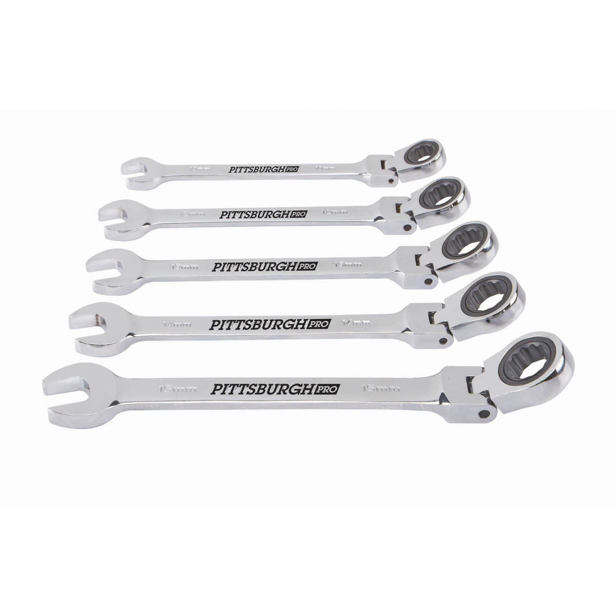

Just did this recently, I believe in the center of the 17mm nut there is a spot for an allen key, you stop the shaft from turning with the allen key while using the 17mm wrench - I use a ratcheting flex head wrench to tighten, you cant really get a torque wrench in up there i just went by feel and to how it was when i took the old ones off.....

You get a 5mm allen wrench onto the spindle and turn the nut with a flex head box end wrench. You turn the nut and get the allen wrench wedged up against the frame. The allen wrench will then hold the shock spindle steady while you use your ratcheting box end wrench. Without a ratcheting wrench, this job is a nightmare as you just realized.

I just did this a couple of weeks ago. For whatever reason, I found it easier to open end wrench than the flex head. The flex kept popping off the nut. The open end wrench was slow going, but once I got a feel for it and got into a rhythm, it wasn't bad at all. Sort of meditative actually :)

It's easy if you have one of those flexhead gearwrenches. I hope you slathered the threads in anti-seize and put a brake bleeder cap or something over the hex wrench hole because they are a MFer to get back off, the mount is perfectly designed to fill up with dirt, the drain hole gets clogged with pebbles and it's extremely awkward to keep it clean. I've always had to resort to destructive means to remove the old ones.

I found an offset box-end wrench to work the best. I used a ratchet for the allen key. You can use either/both to tighten/loosen.
