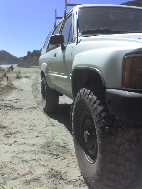

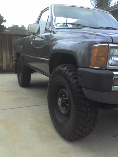

How big a tire do u plan on running? U can fit 33/10.50s on the stock rims with no lift at all. Just do the pinch-weld mod and ur good to go.

I keep hearing 33s will fit stock, but no way that's happening.

They fit in the driveway. They also fit in my wheelwells. Last trip to BigBear in April, we rockcrawled all day. Zero rubbing. That being said, no two vehicles are identical. I would get the OME in a heartbeat if I could afford it. As a heavy equipment operator, I'm still waiting for Obama's shovel ready projects to start($$$). :cowboy:
