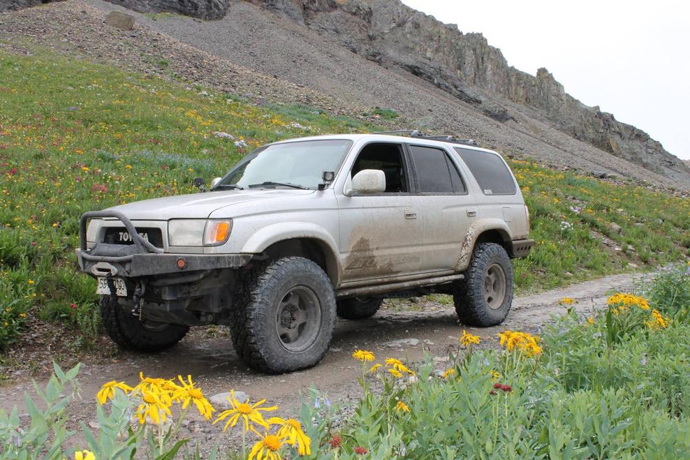

I own a 3rd gen with Toytec and Icon products on it.
