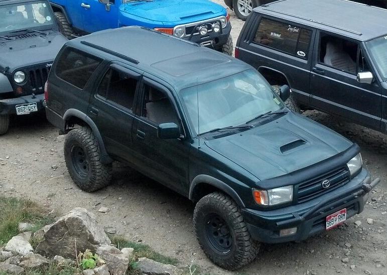

Oh and here's a pic because none of us can really read, we just look at the pics. ;)
What is the backspacing in your wheels?
Do you use any spacers?
Thanks
