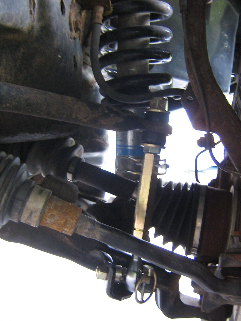

I'm using [MENTION=98153]MStudt[/MENTION] quick disco's on the front & [MENTION=18304]pearlj10[/MENTION] on the back, you can't get more solid than these. If you're lifted you'll snap OEM & definitely cheap aftemarket stuff.

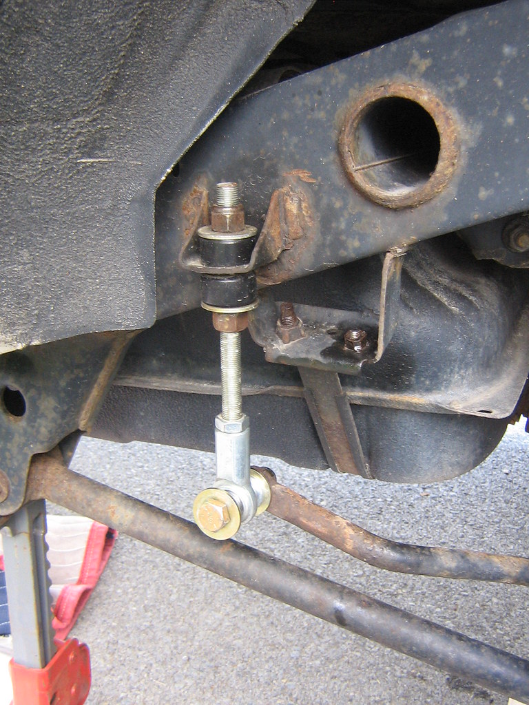

End Links, drain holes 021 by Mike Campbell, on Flickr
End Links, drain holes 023 by Mike Campbell, on Flickr
Thank you for posting this! I have been looking at replacing mine after the mild FJ lift.

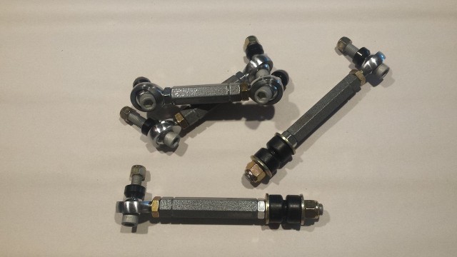

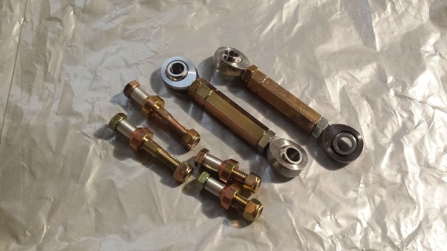

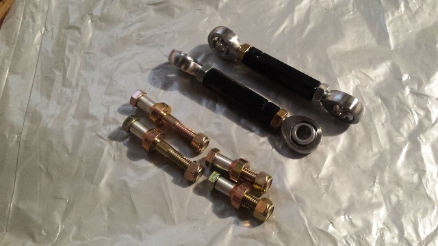

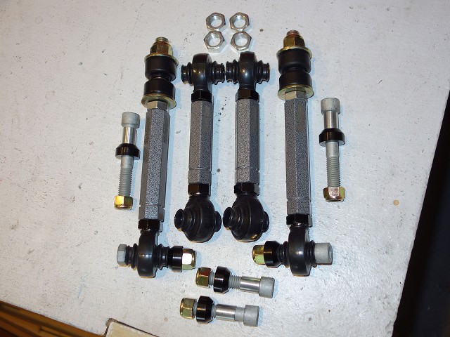

Shoot me a PM if you're interested. Here are a couple pictures of some links that I make. These are all for 4th Gen and 5th Gen, but it gives you an idea.
Mike

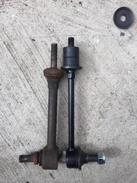

2nd Gen 4runner links compared to 3rd.. the fit is really good!

Why are these two links longer than each other, even if they are both from 2nd gen 4runner rears?
I think what you are looking at is both sets of new links are 2nd gen rears... the first pic on the gun mat is comparing to stock 3rd gen rear and the next pic is comparing them to stock 3rd gen fronts.
