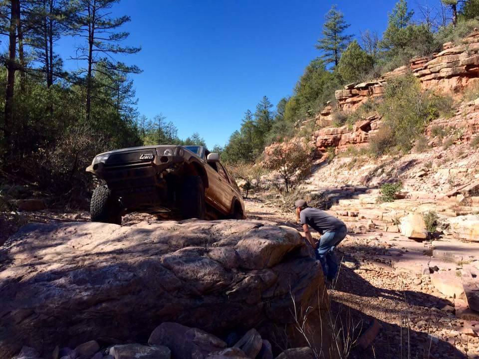

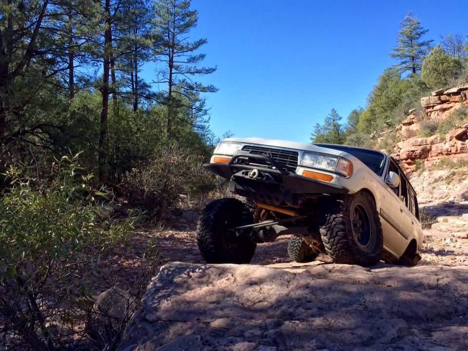

when it binds, do you mean on the pavement or offroad? also i have the shit 3.90 gears as well, and 35s. truck is fast on the street, but its slow on the highway and can be a pig going over big rocks and stuff offroad, like this.
of course the guys in the land choochers were havin one hell of a time as well with that rock.
