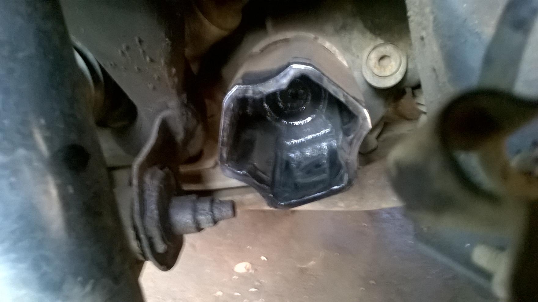

Changed front discs and brakes because of frozen calliper (drivers side). Got it "fixed" but not changed. The workshop says I should change this ( name pls? see pic attached).
The wobble still continues :-(
