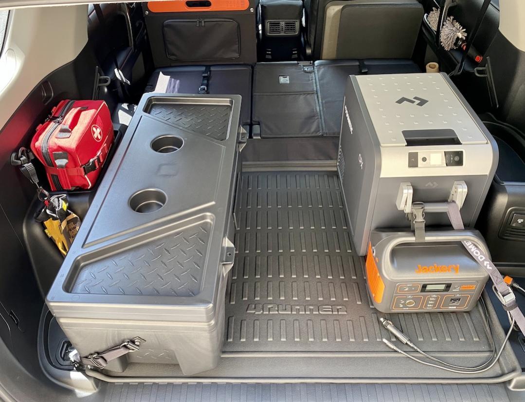

Here's my setup. Not really too difficult. can easily be moved to any vehicle if you ended up changing your vehicle in the future. The only thing you needed to do is wire the positive from the front battery to the back and the negative to the the body somewhere. DC-DC charger works great. i was able to use that battery for 2-3 days powering my 55 liter fridge during my camping trip. multi purpose as a storage of wires and some tools. it gets recharge when we go around visit places too. I have the option to connect a solar panel with that dc-dc charger which i don't need rightnow.
Portable Dual Battery using REDARC DC-DC charger - YouTube

Looks like a good setup, thanks for sharing. I might consider something similar. But the more I look at my needs the more I realize I will be needing the cooler powered all night by the battery (Jackery, etc.), and then at dawn the battery needs to be getting solar charging. There is a lot of disconnect this and reconnect that going on in my mind and I want to limit that. I am trying to imagine the needs and build around it.

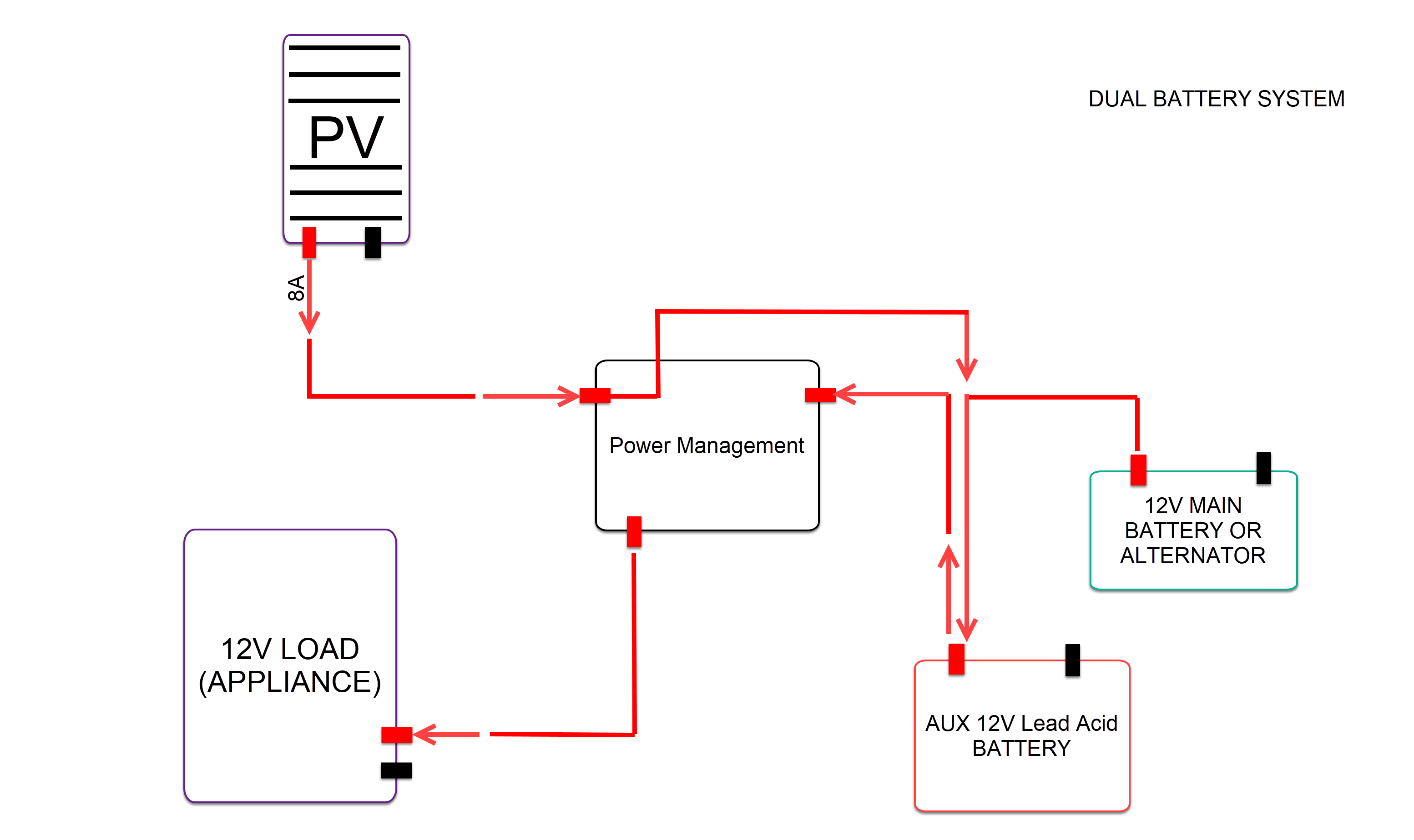

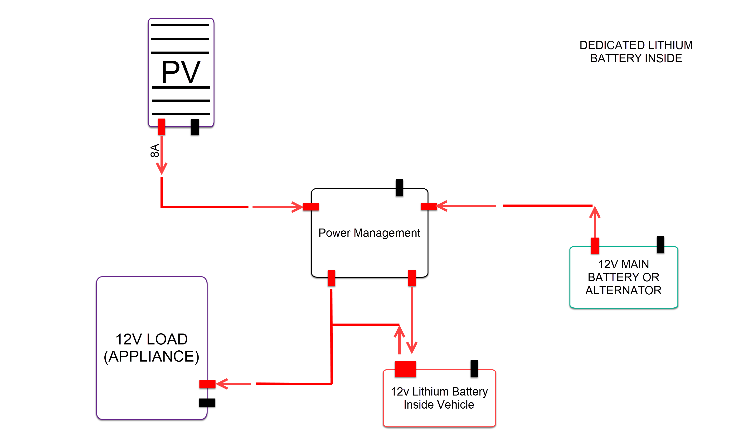

Hey, just for laughs, I have a couple of schematics of the system that I think can work and I have attached them to this message. Well, hopefully not just for laughs, and at least also for discussion.
Well those aren't exactly schematic diagrams for electrical of electronics, but they convey the idea at a high level.
