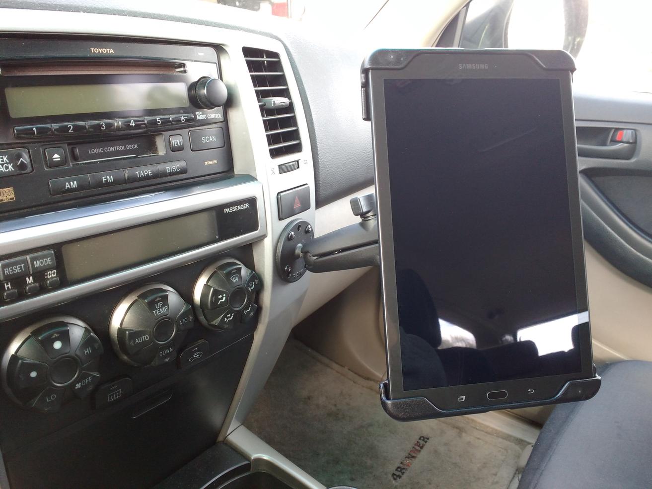

I'm currently using a Samsung Tab E 9.7" with GAIA GPS and I have it mounted to my 4Runner with a RAM Mount. I enjoy using GAIA and the RAM Mount works great on the trail. I'm OK with the Tab E, but I think I'll go with the new iPad Pro 10.5" when it comes out this year. The 10.5' will have the same external size as the iPad 9.7"
Tab E 9.7" Pros: Cheap, just paid $150.00 for it before Christmas. Built in GPS (worked better then I thought) expandable memory, 32gb of internal memory. I can split the screen and have two items open at the same time. (some apps don't support the split screen function).
Tab E 9.7" Cons: Android apps are not polished/refined as Apple Apps. (I own both so I can tell) Not all Apps can be transferred to the memory card). Cant find a lot of cases for the Tab E 9.7" at the local stores.
If you can, just go with the iPad Wi-Fi and Cellular. That way, you don't have buy the Bad Elf and worry about not loosing it or breaking it. You don't even have to hook up the Cellular if you don't want too. Check out Apple's Refurbished iPad site, you may find one you like.

That looks like a really nice set-up you have there with the RAM mounts. I want to do something very similar soon and was just wondering how you mounted the ram mount to the dash there. Did you just pre-drill some holes that were slightly smaller than the screws used? Or did you take off the dash and fix a washer and nuts the the other side to make it more secure? Also if I drill through that panel (in the same spot as you) from the front, do I need to be worried about drilling into something delicate behind it?
Thanks for the help!

[MENTION=147280]williamteichroeb[/MENTION] Thanks, I like it a lot and it works great.
I did pre-drill the holes and they were slightly smaller then the RAM mount screws. The drill bit size was 9/16". No need to remove the dash panel when drilling. You do need to remove the climate controls so you can get access to the back of the panel. I used 4 Nylon lock nuts size #8-32 to secure the back of the RAM mount to the panel. No need to worry about drilling into anything delicate behind it if you drill it in the same spot I did. There is some extra plastic behind the panel that you would want to avoid drilling into, but one you take a look behind the panel you will see what I'm talking about.
Good luck and post up some pic's when your done.

Thanks for the info. I like that you secured it with nylock nuts of the backside. I have seen people just use self-tapping screws and that seemed to hold it well. Not sure which I'll do, but your method would definitely be the most secure. I did something similar in my rear cargo area when I mounted a fire extinguisher to the rear panel. I wanted that thing secure on there, not flying in my face if I need to slam on the brakes lol
