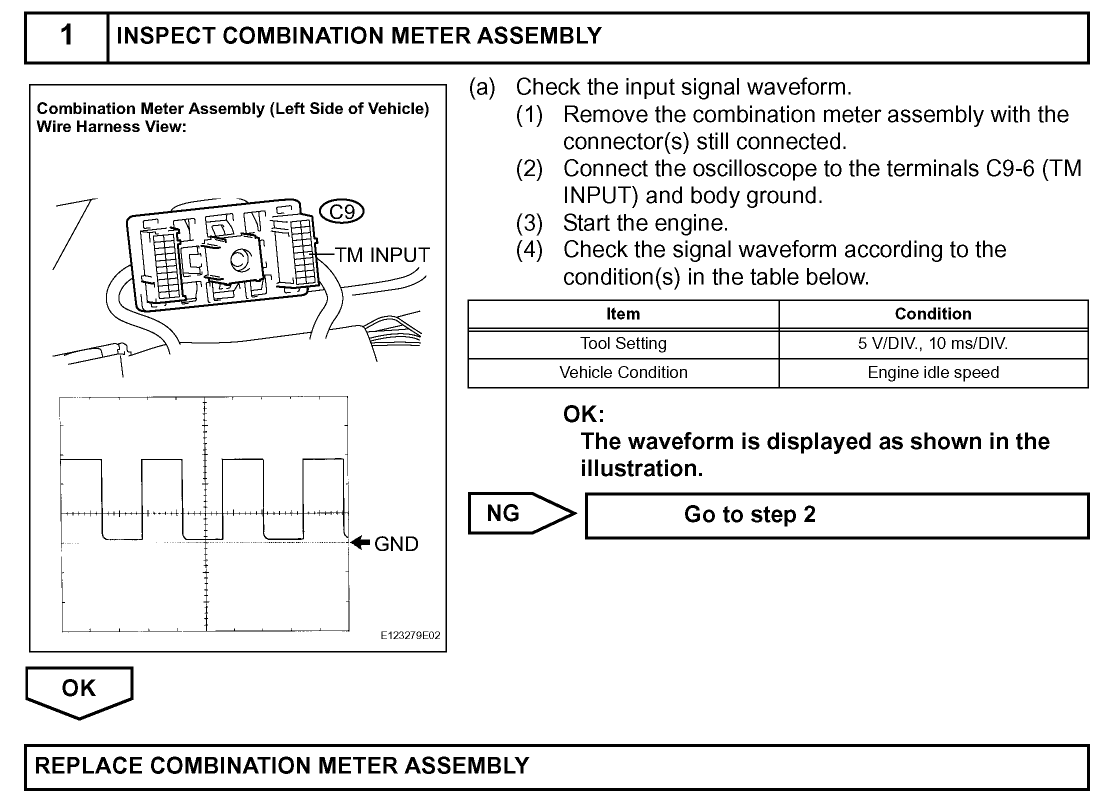

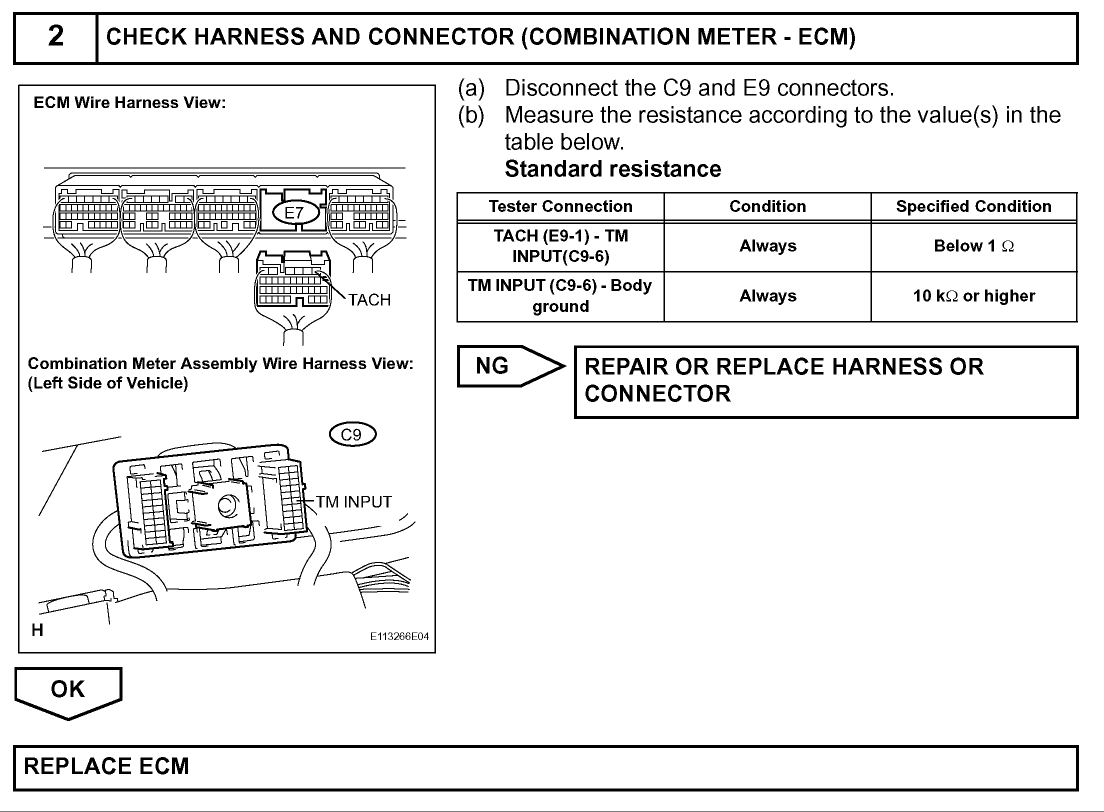

Running out and don't have time to sift through the FSM. Pulled this info from alldatadiy for a 2007 V8. Should be the same, I think.
Tachometer Malfunction
DESCRIPTION
When turn the ignition switch to the ON position, the combination meter assembly communicates with the ECM by the direct line.
GOOD LUCK!

So I dug out an old scope from my work and hooked it up. I get the squarewave form that I'm supposed to get so it tells me to replace the combination meter assembly. But then I tested the wiring harness/connectors for continuity and there is none, which there should be. So now I'm not sure if I just cannot get a good connection with my leads to show continuity. Thanks again for all the help cabowally.
Check the fuse for the gauges under your left foot. Maybe its in the wiring under there? Possibly a loose wire that sometimes gets power and sometimes doesn't?
