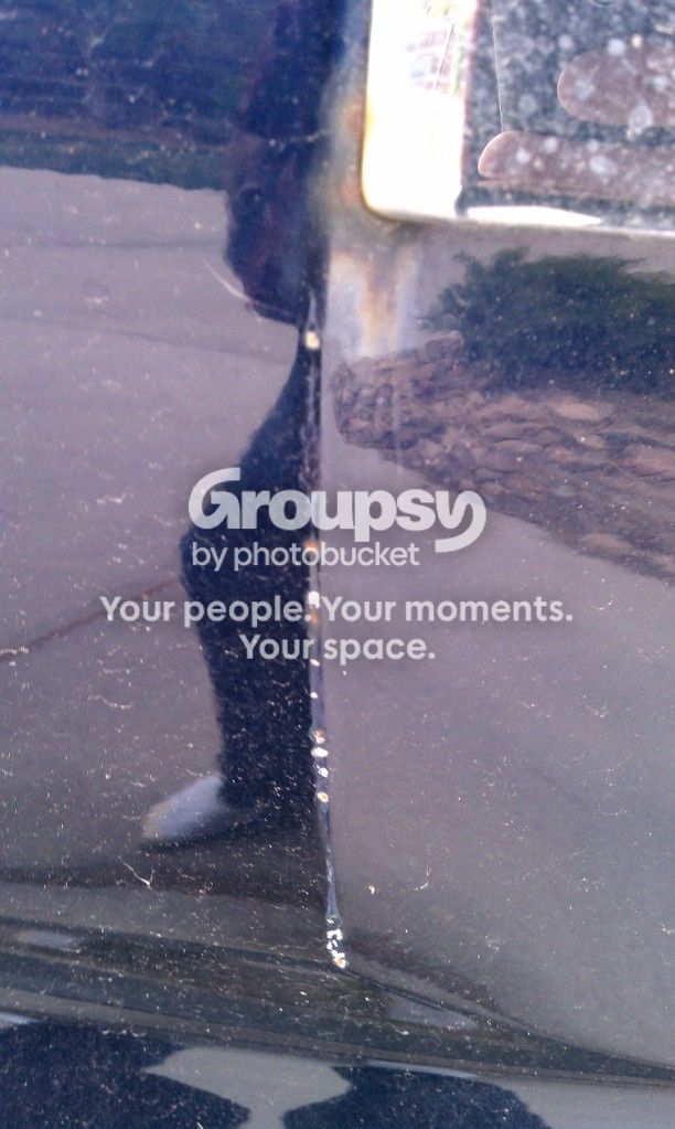

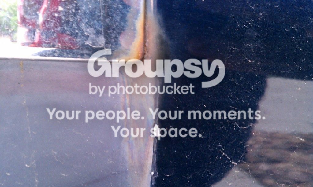

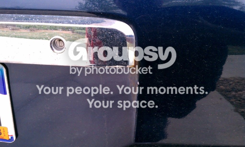

This is right at the corners where the chrome meets the tailgate itself. Is there anything I can do about this? Should I even be concerned with it?

I would remove the tailgate garnish, clean it, and touch it up. Looks like you have a lot of rock chips in your tailgate.
Yeah... I've never been all that happy with the quality of the chrome. I was thinking of plasti-dipping it and being done with it.

As for addressing my issue, I'm strongly considering replacing all of the chrome pieces on my runner... though I might start with the cheaper route of plastidip.
Does anyone have a good guide for repairing the existing rust that's already burrowed into the paint?
So I'm really hoping the rust is just skin deep. If so, I'm hoping I can just sand away the rusted areas and use some touch-up paint without having to re-prime it.
The plan right now is to remove the trim to see just how bad it is under there. Once I've got the paint fixed up, I'll plastidip the trim and re-install.
I'd like to make sure to get the plastidip all the way around to where the trim meet the paint. Does anyone know if doing this will prevent the trim from fastening correctly to the door?
I don't think it would affect the fastening by using the plastic-dip on all sides.

Not a bad plan. It sounds like you do realize that the garnish is not the rusty part, despite what it looks like. But that garnish causes the trouble none-the-less.
Wonder if rtv sealant around the edge when reinstalling could help? Either way, keep us updated on your progress. I plan to do this and then try to get up underneath and use por-15 or something on my frame/under sometime this summer.
