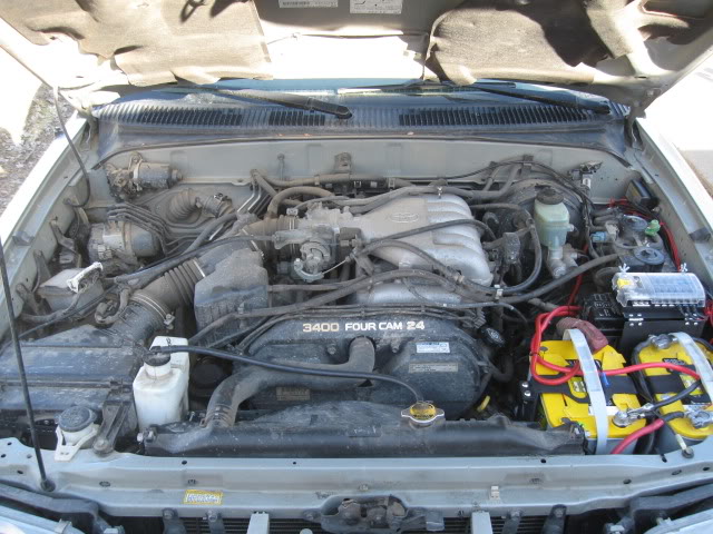

Hey guys, i am going the dual battery route and got some good advice a few days ago.. now i just took my stock battery out and found the measurements to be right around 9" tall (including post). All deep cycle batteries in the group/size i am looking for are almost 10" tall. I don't want to end up ordering a battery that wants to pop new holes through my hood. Anyone have experience going with a bigger than stock battery? thanks!
fyi this is the mounting location (i will not be using optima's)

I had my big Interstate under the hood for a bit, it's 8 1/2 inches and add some ~3/4 inch tall battery terminals on top, it barely fit, I'm talking a hair bigger and the hood wouldn't have shut at all. I wouldn't reccomend anything over 8 1/2 inches tall (to the very top) to be safe.
No was afraid that would be the case. All I can find with the dimensions that will fit (10" length, 8" height and 6.5" width) are optima yellow tops. I've heard so many horrible reviews since their chinese acquisition.. Anyone have any alternatives to an optima with those dimensions? Thanks
I used a Diehard Platinum (Odyssey AGM) 34M. It is 8" tall to the top of the terminals. I had to put the 1" plastic spacer under it so the battery hold-down would fit it. Awesome battery - deep cycle, and about $180 at Sears (usually on sale).

The largest would be 2x31s as bajataco did in the link. It makes more sense to have one large one small starter.

i think i am going to go with the optima yellow top ( 3 year free replacement ) and put it next to my stock starter battery. Just have to figure out a tray and a way to secure them. Thinking of just cutting some aluminum to the length of both batteries then bolting it down to where the stock battery tray lies. Unfortunately no welding abilities yet so it might get interesting. It looks like some people have been able to modify the stock tie down to hold two batteries.
