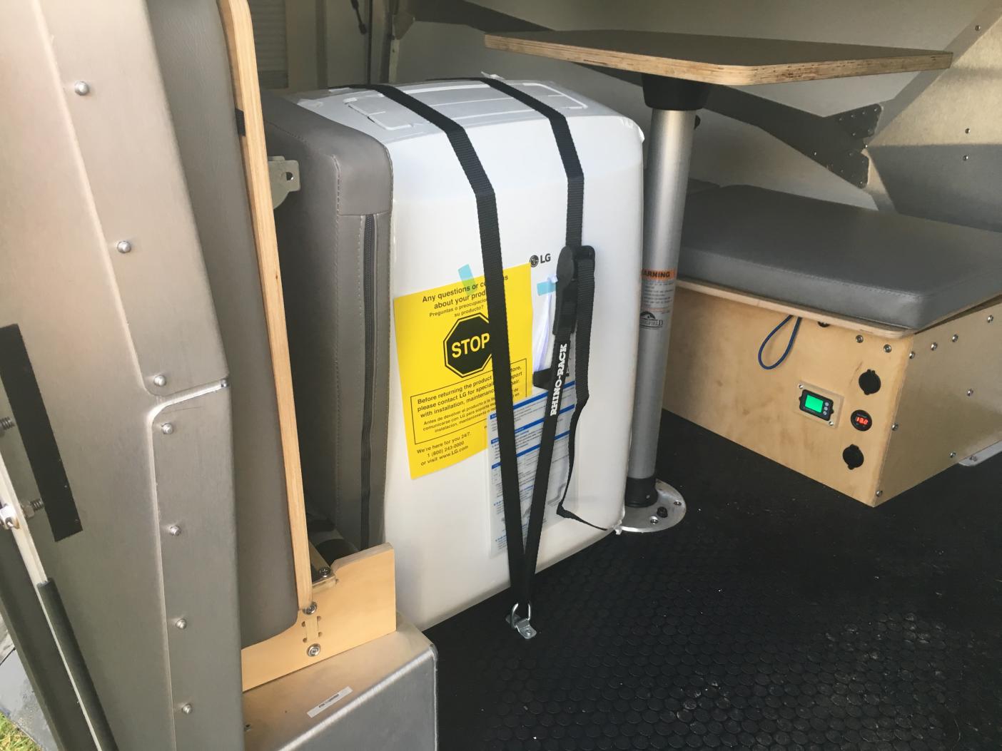

What AC vendors are these camper builders using? Climateright is out of stock indefinitely (with the rumor that a new model is being released in 2021) and alternatives are drying up.

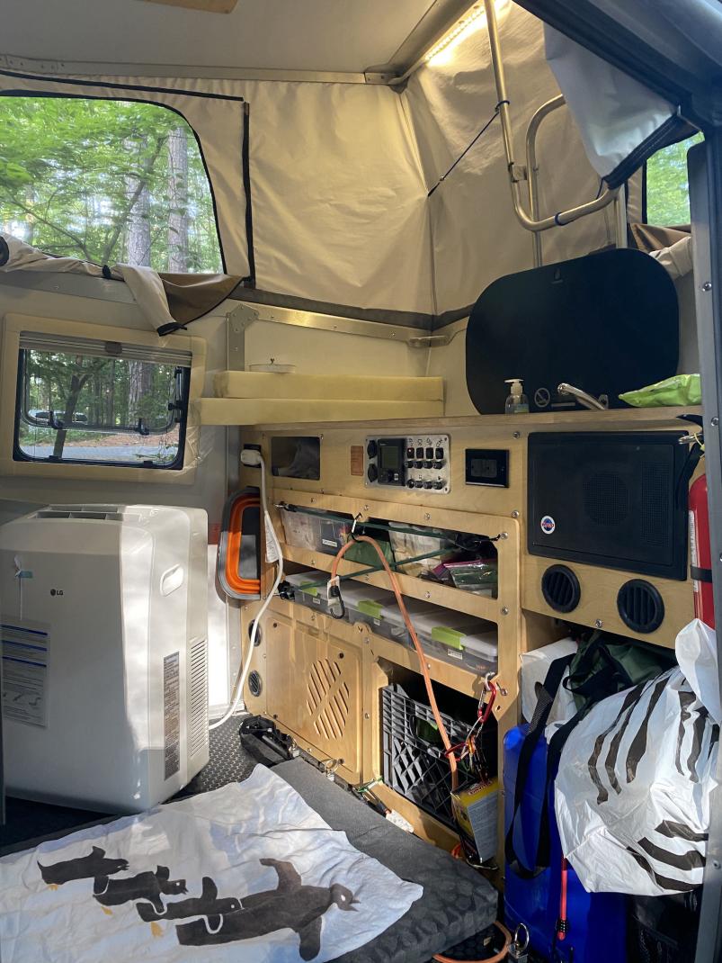

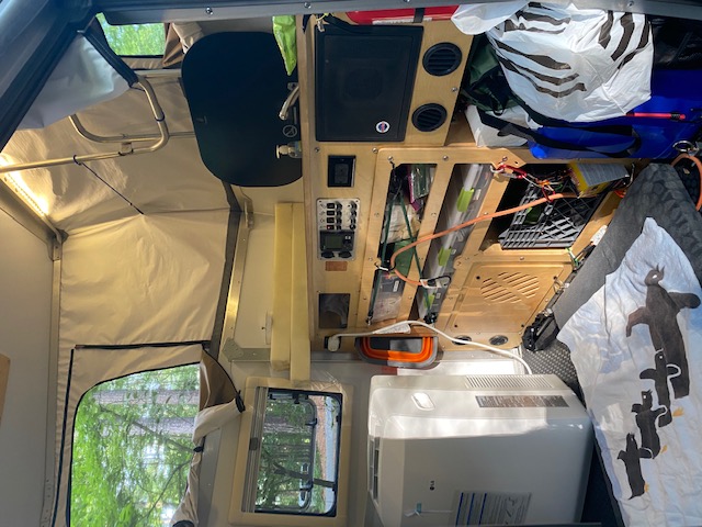

5,000 btu Portable A/C (can be found at Lowe's). Pulls about 600 watts with the compressor running. 6" vent hole cut in the side of the trailer with an outdoor 6" plastic drainage grate. Used the cut out hole as a plug. It works well in dry climates, in our humid Florida weather it takes the edge off.

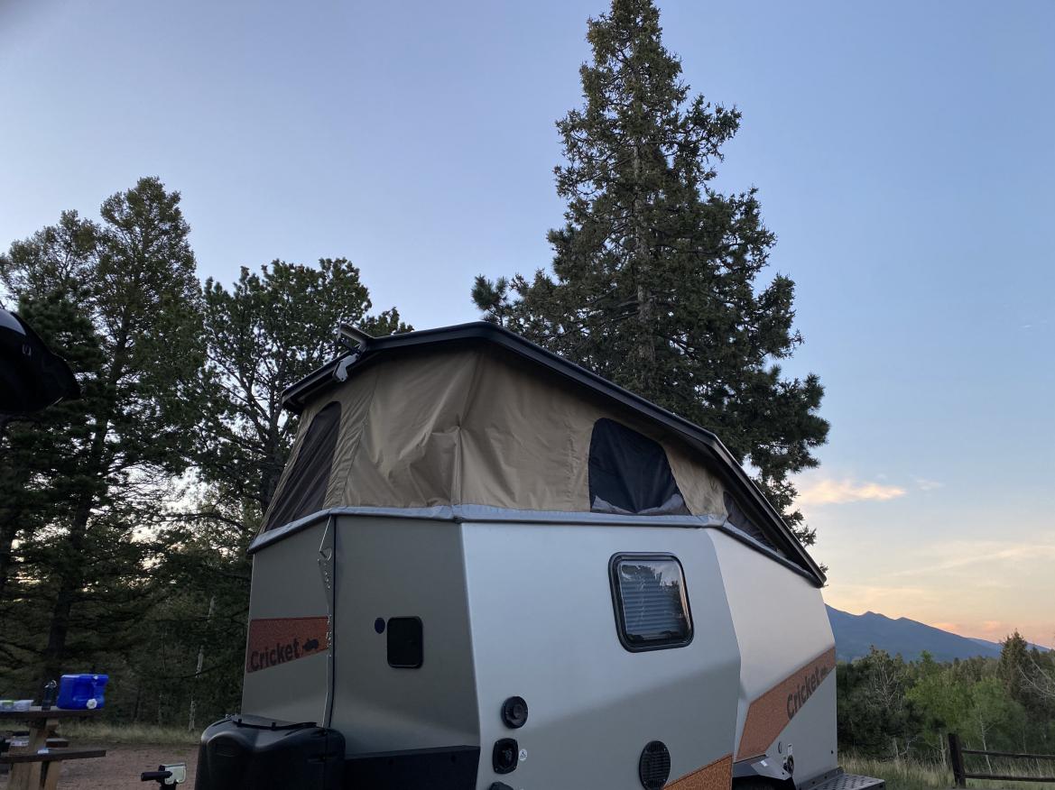

You can see the vent hole cover from the outside in the last pic.
