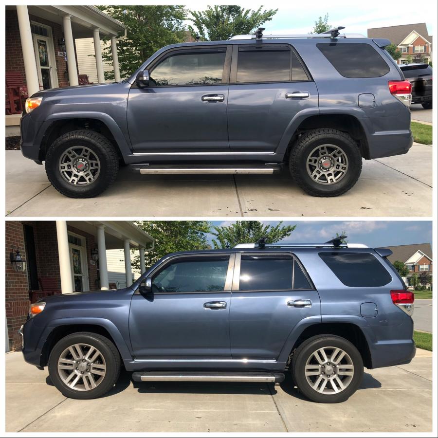

I've only been running it for a day but I had my local shop rip out the XREAS system fully and install this. All went really well, it rides way better so far that I can tell and it looks pretty tough too. I had 120K miles on the stock XREAS shock setup and they were shot. Nose dive is pretty much gone and I've slammed a few speed bumps just to see and it feels way better. I swapped out stock 20" rims to TRD Pro grey rims along with new Nitto G2's at the same time.
There was one slight issue on install for a Limited model with XREAS. My shop mechanic had to ream out the metal pieces that sit on top of the bushing as the hole wasn't big enough to fit the Falcon shaft. My only complaint with the setup is that, for the money spent on it, I'm super surprised it didn't come with new bushings like Falcon's Jeep kits. Sort of cheap, if you ask me. Stock ones are fine but just the principal.
Time will tell to see how they perform for the next few years and miles ahead!

Great ride for sure! Handled real nice on the beach.
Now I am thinking about changing my trd pro suspension....

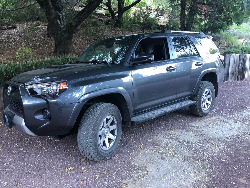

Falcon's crushed it on the 4x4 beach in OBX. I was staying about 8miles up and they performed very well. Happy with the choice and glad I went with them!
