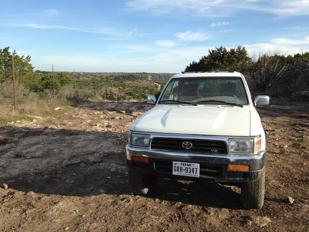

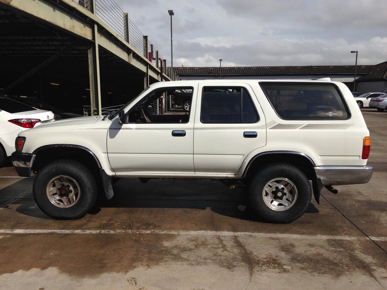

The day I drove her home:

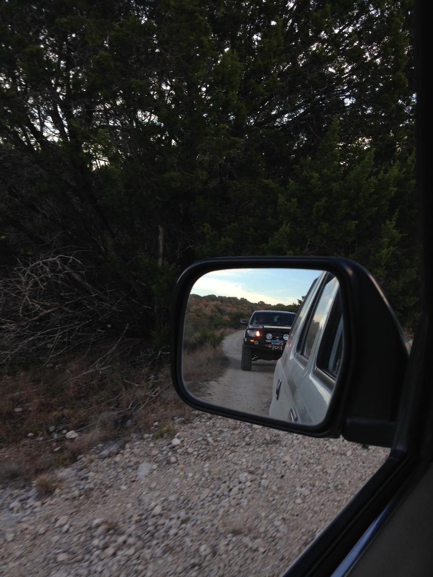

It is has been a while since I have updated this thread so I wanted to throw in a few photos of the trip I organized with two guys over on the Expedition Portal forum members to the Hidden Falls Offroad Park. This is a massive tract of trails throughout the Hill Country of Texas near Marble Falls. The land is covered in scrub and the trails are rocky and full of packed dirt.

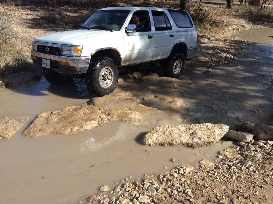

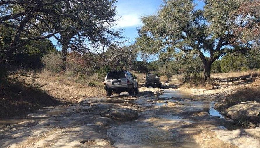

We met and headed down a park road where we eventually found a small rocky stream. After consulting the map we decided to be adventurous and head up the stream.
This was a bit of a challenge for me as this was my first time ever off-roading, especially since the small rocks made modulating the clutch very touchy.
Eventually we encountered a huge rock which prevented us from proceeding up the river. Thus we had to escape from the river bed. I had a hard time with this one. It's difficult to tell from the angle of the video but I could not see what was to the right of the front right fender. Once I backed up far enough to see that I was clear I finally gave it the juice it needed to make it up the climb.

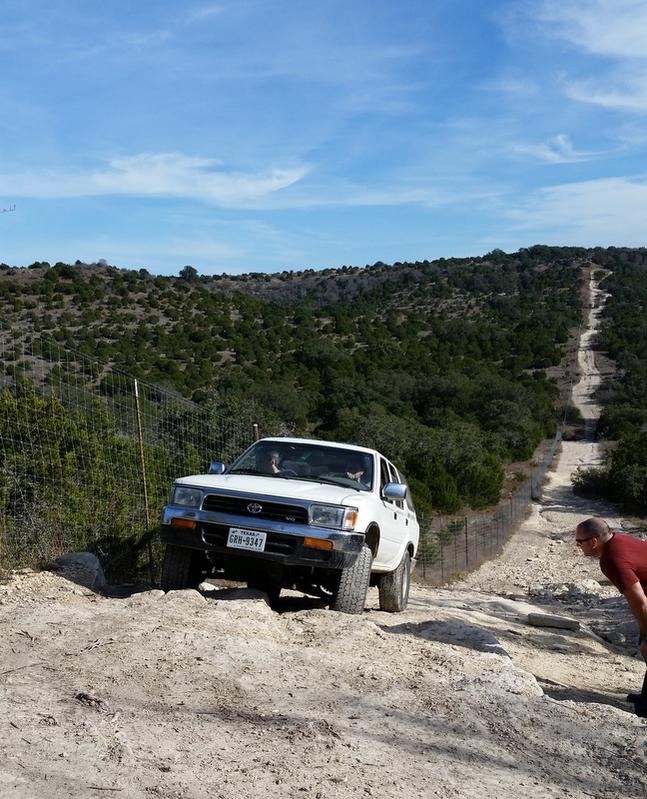

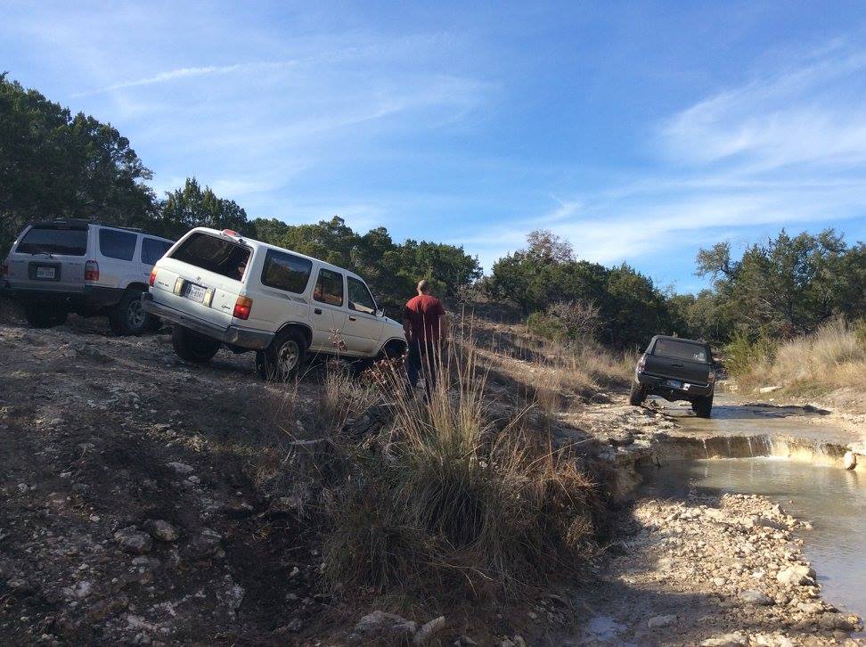

Eventually, we ended up at the end of the park along a huge hill. It was quite imposing, but we decided to do our best to climb it. Several ridges separated us from this end goal. Below is the picture of us starting our climb.
[MENTION=107308]jgilbreath[/MENTION] hit the first obstacle. As you all know things look way easier on video, but this was a huge dip. He had an e-locker on the truck but it was not working so this is all open diffs.
3rd Gen 4Runner - Hidden Falls (video)
I caught a quick video of the tacoma making it look easy here. Capable truck and good lines makes this look much easier than it should have been.
2nd Gen Tacoma - Hill Trek (video)
Finally, it is me bringing up the rear in the stock 4runner with worn tires. Here is me getting some guidance from a more experienced driver as I get guided up the ledge.
We found these awesome views at the top of the hill.
We hit a few more obstacles as we proceeded down the hilltop and I even got a chance to flex out the rear suspension. As you can tell I am pretty excited about this haha

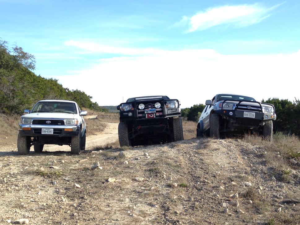

Hidden Falls - Group Trip Part 2

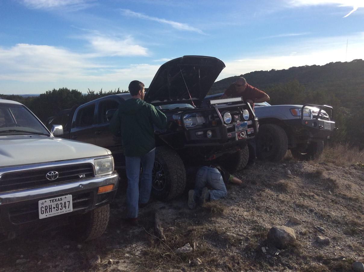

We stopped to take a group picture when we noticed some oil leaking from the tacoma of the group. Queue the group diagnosis.
Luckily it did not seem like trail damage and later on the owner discovered it was a very slow leak from his front seal. Here's the awesome group shot.
Lastly, I snagged a cool photo of the tacoma on the way out of the park.
I had a blast doing this and while not the typical overlanders outing this was a great opportunity to practice and showed my just how capable my 4Runner was out of the box.

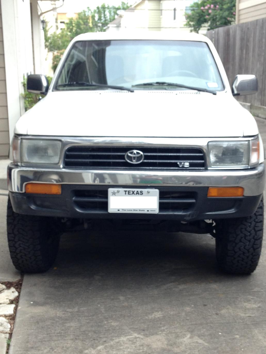

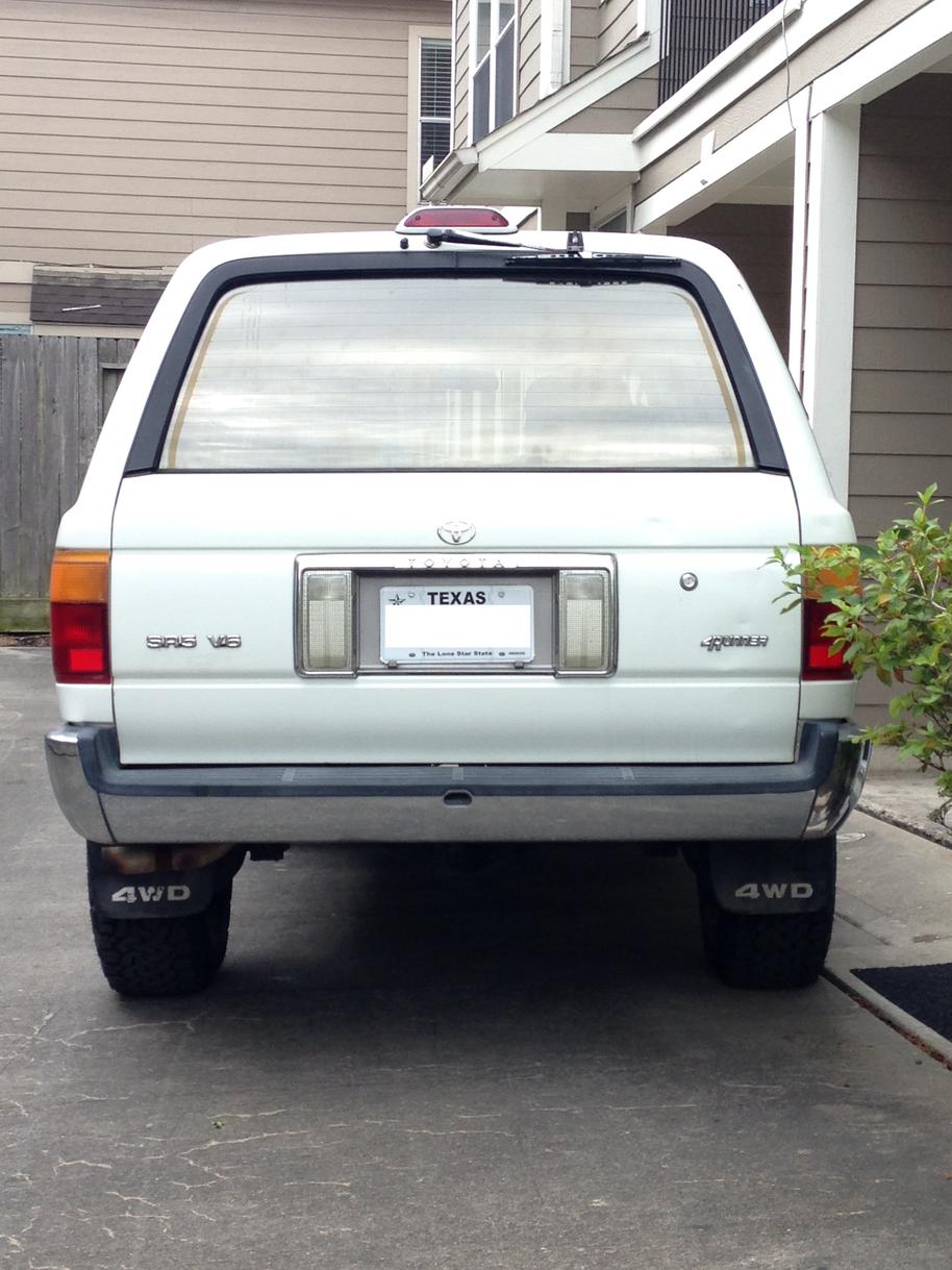

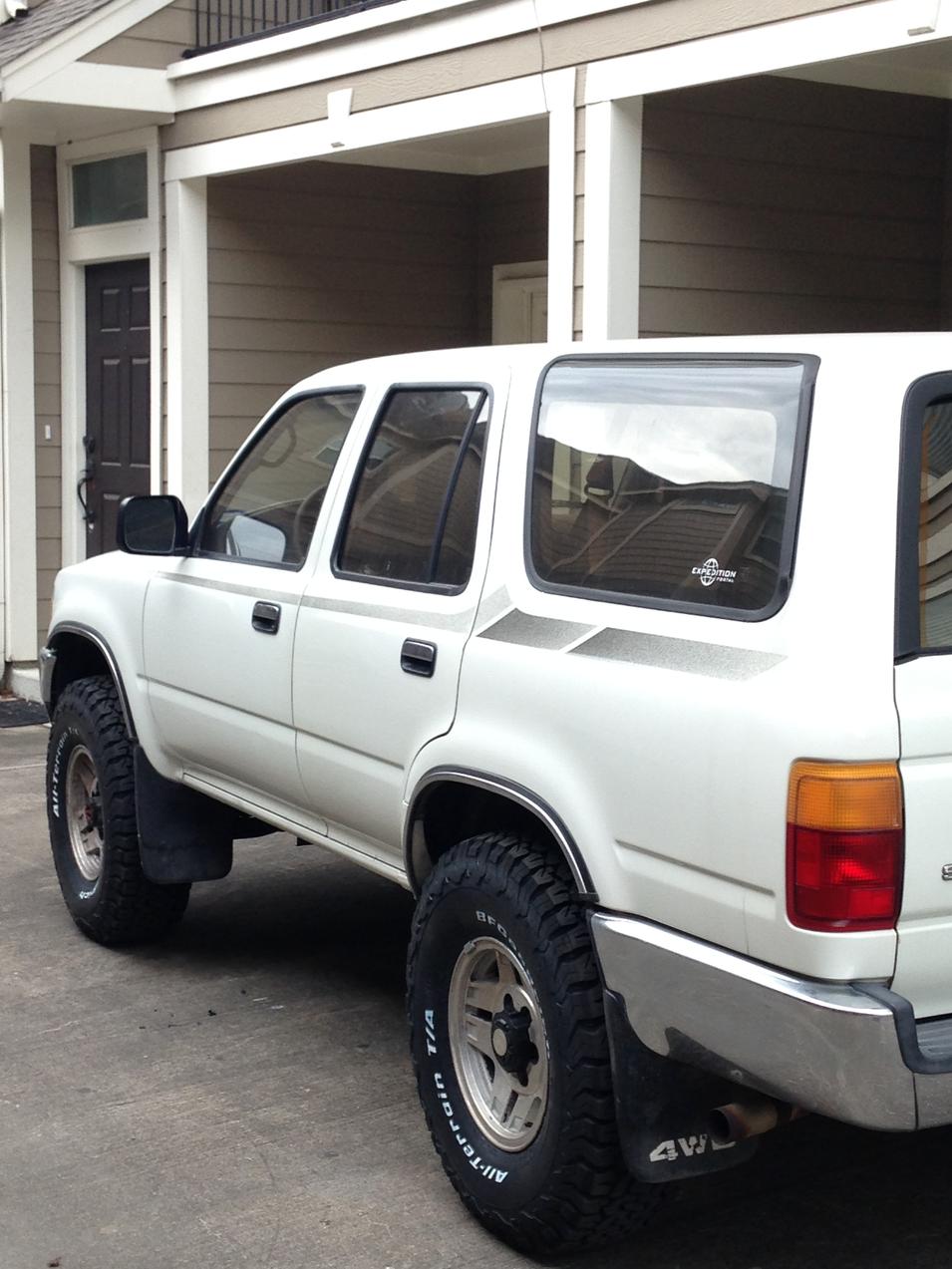

Tires update!
Hey guys,

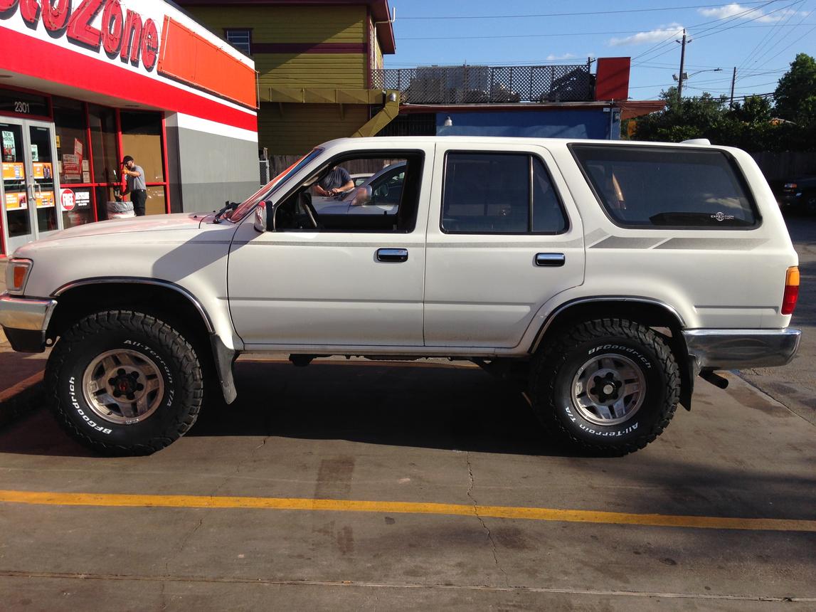

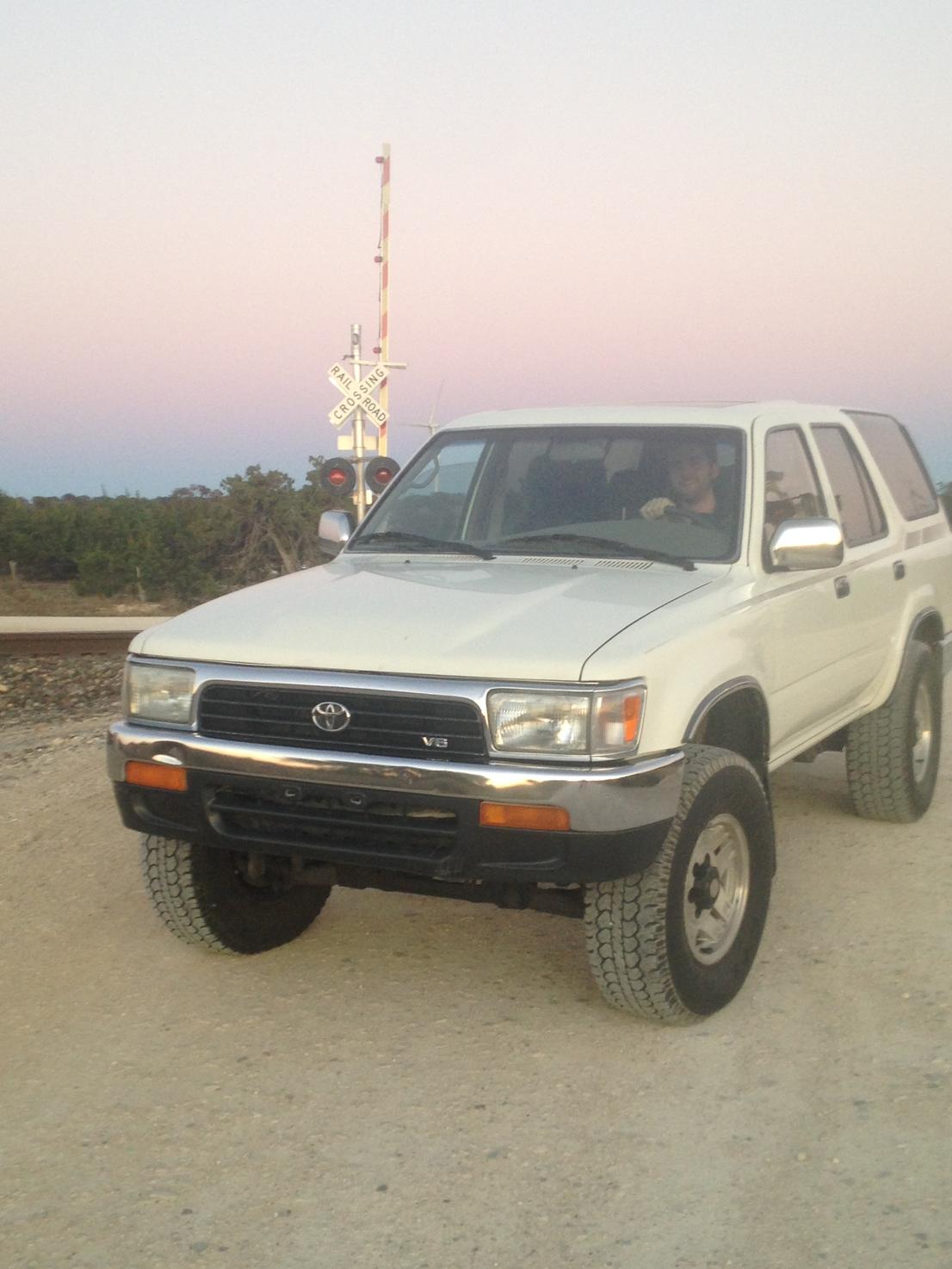

It has been a long while since I have updated this thread, but now that I have sometime the backlogged updates should be flowing in. After the last trip to Hidden Falls Adventure Park it was clear that the 4Runner needed new tires. The 31x10.50 Michelin LTX A/T tires on there were worn down badly, and were starting to show signs of spider cracks on the sidewall. I have had a tire blow on me on the highway previously in an older Acura and there was no way I was going to take a chance of that happening in a SUV. Therefore.. meet the new tires, I got a really good price match at Discount Tire for a set of 33x10.50 BFG K02 tires. I did a lot of research before purchasing these and it was really between these and one of the Cooper tires. I have always been a sucker for the white lettering. I purchased five and went with the warranty provided by Discount Tire since I read of a few issues some owners have had with these wearing strangely due to bad molds. Here are a few pictures! Keep in mind I have zero lift on the truck and that it is completely stock.
Interesting story on the picture of the truck at Autozone. I was just taking the truck home with the new tires when I took a turn a little faster than usual and I hear a bunch of noise come from the engine bay. I pull over and look for something wrong and spot some liquid dripping to the ground. Some genius had removed the battery tie down and never reinstalled it and I hadn't caught it until now. The whole battery and tray had slid from its position over into the power steering pulley which had cut a hole in the side of the battery... GAH! A new battery and a bunch of bungee cords held me over until I got a new clamp from Toyota. Learn from my mistake and make sure your battery is completely secure.
