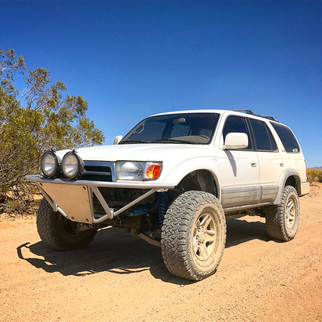

Started our second little camping/fun having rig, we had a little broncoII prior to this, it was offroad capable, but really lacked in the street manners and interior room department, sold it and got this '98 4x4 limited for $100 more than I got out of the b2.
Out with the old...
Don't think I have any pics of it 100% stock... started by lifting it with ome coils in the rear and king bolt in reservoir shocks, and started building a rear bumper.

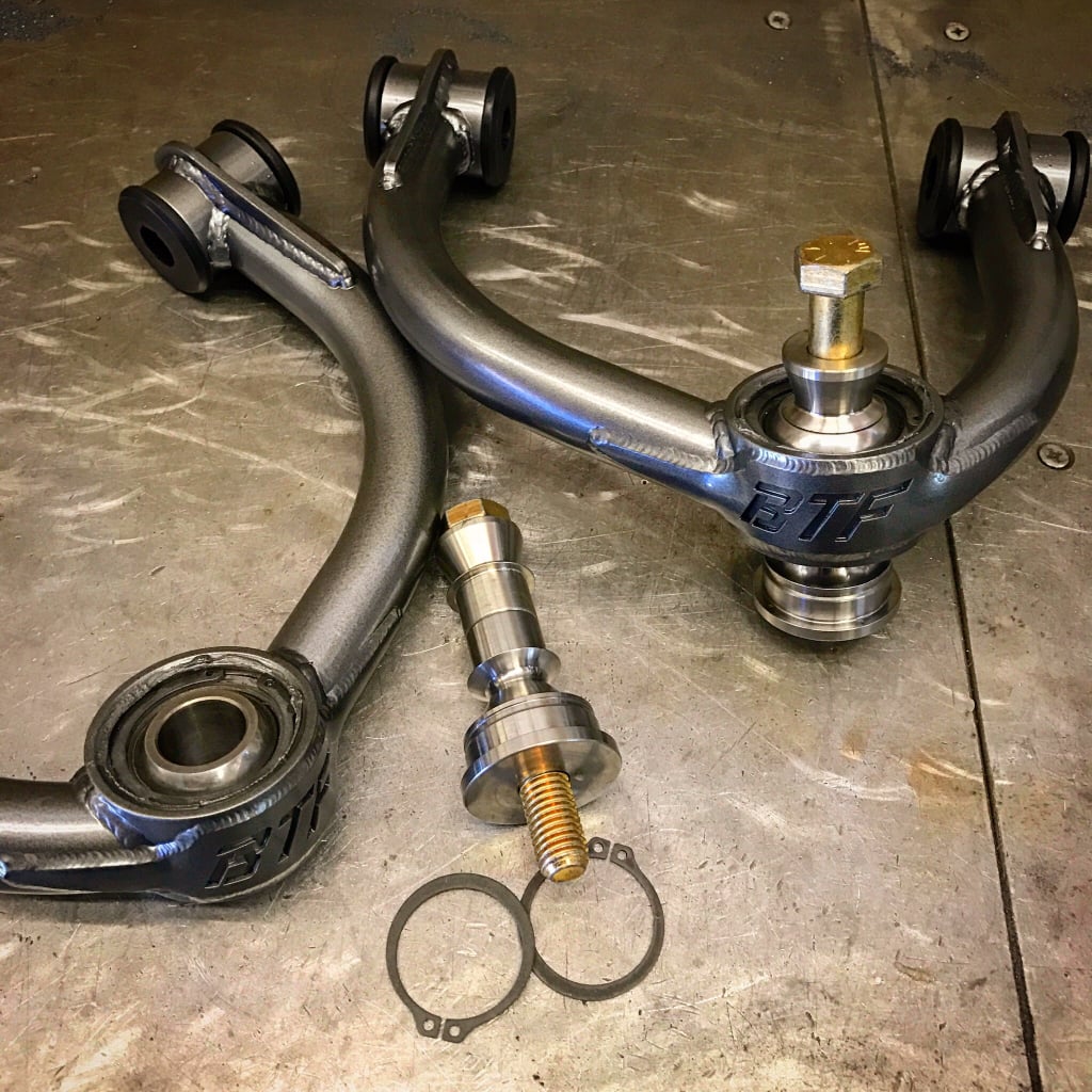

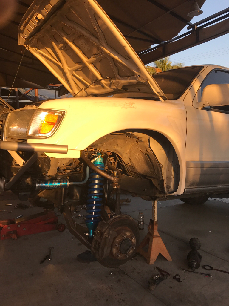

Built these upper arms and found some used donahoe coilovers for the front lift.

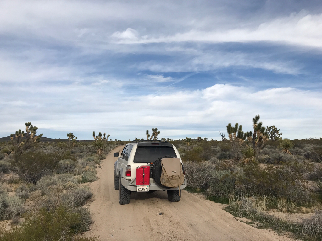

Actually used it a couple times in this configuration, ran the mojave trail from baker to Laughlin, beautiful trail, I highly recommend it!

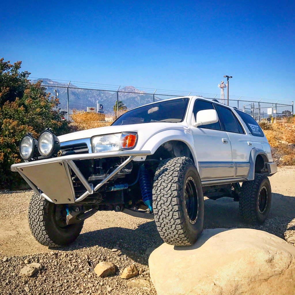

Built a simple front bumper, and put one of our Longtravel kits up front, with new king coilovers and Mcneil fenders

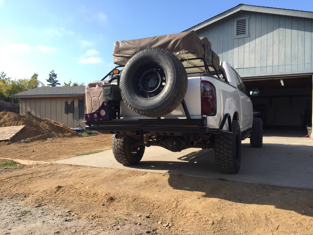

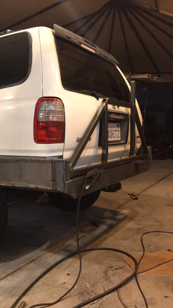

Not much else has changed yet. Sold the rear bumper to a guy, so now I'm building myself another one in my spare time...more to come.
Haha, well, this is my job, so it's going to be a little shop truck/advertising deal for us. I want to keep it relatively simple for camping/exploring type stuff. I won't say "overlanding" because I'm not that fancy. Lol

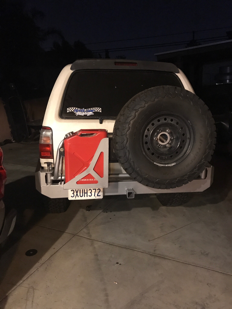

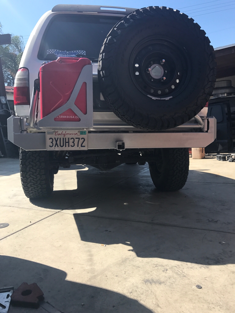

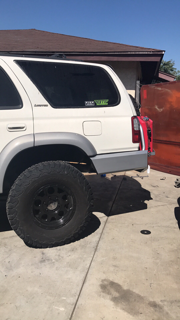

Rear bumper done, for now. Need to add a dust light still but wanted it painted to stop the rust.
I like that rear bumper. Built it, sold it and need to build another. I like the idea of being able to do that. Great job

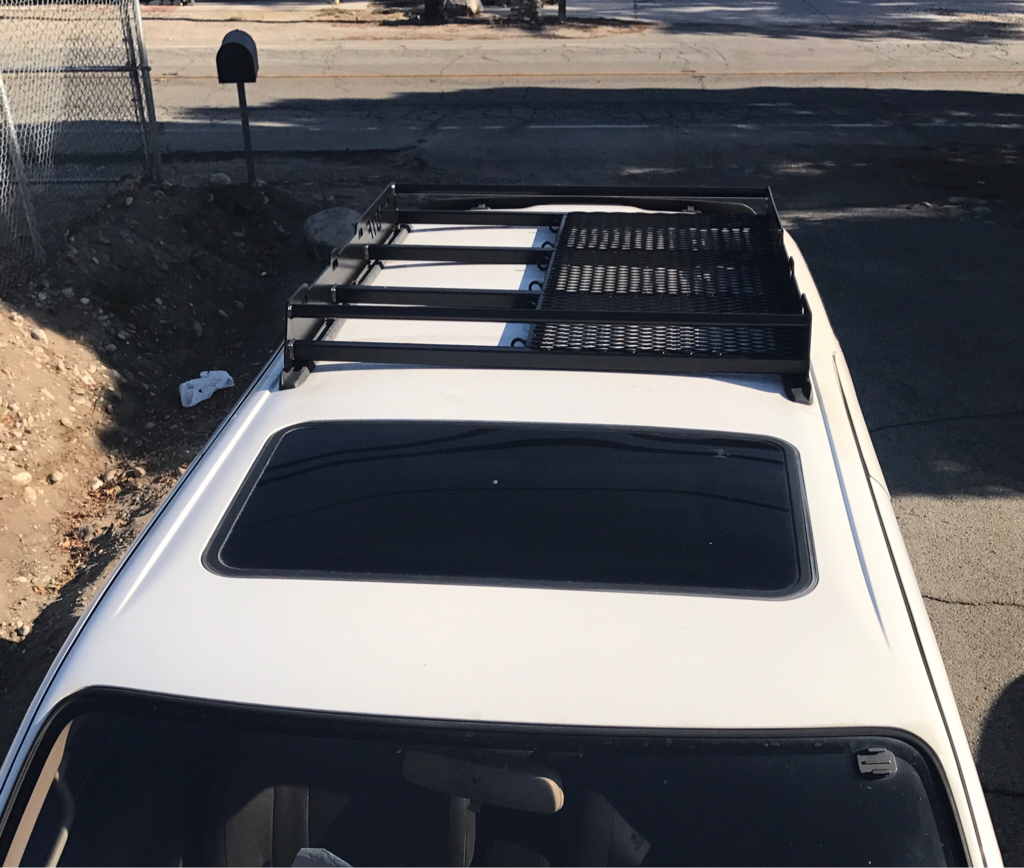

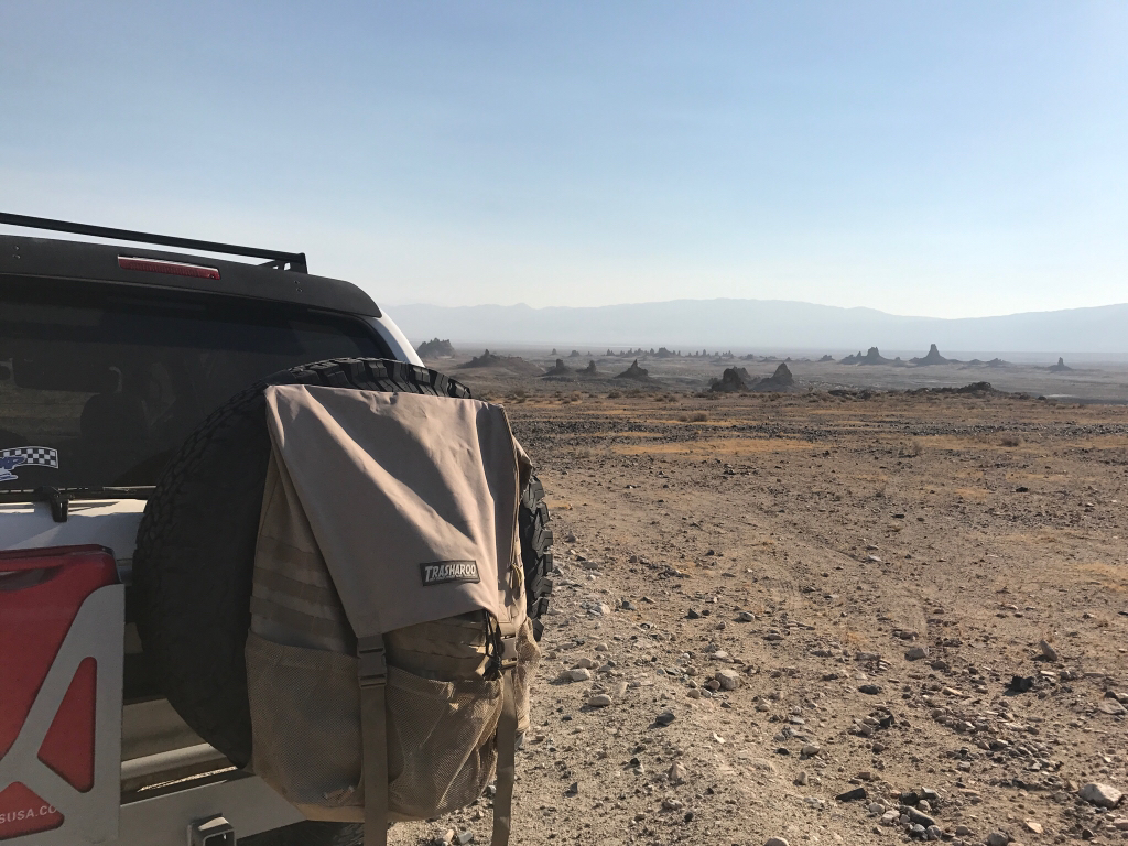

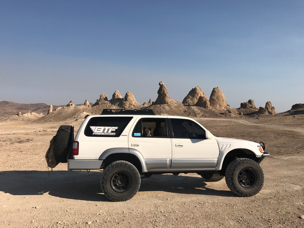

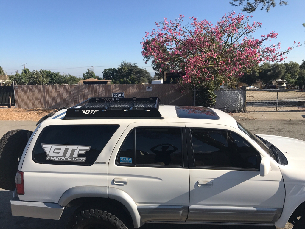

Made a small roof rack last week.

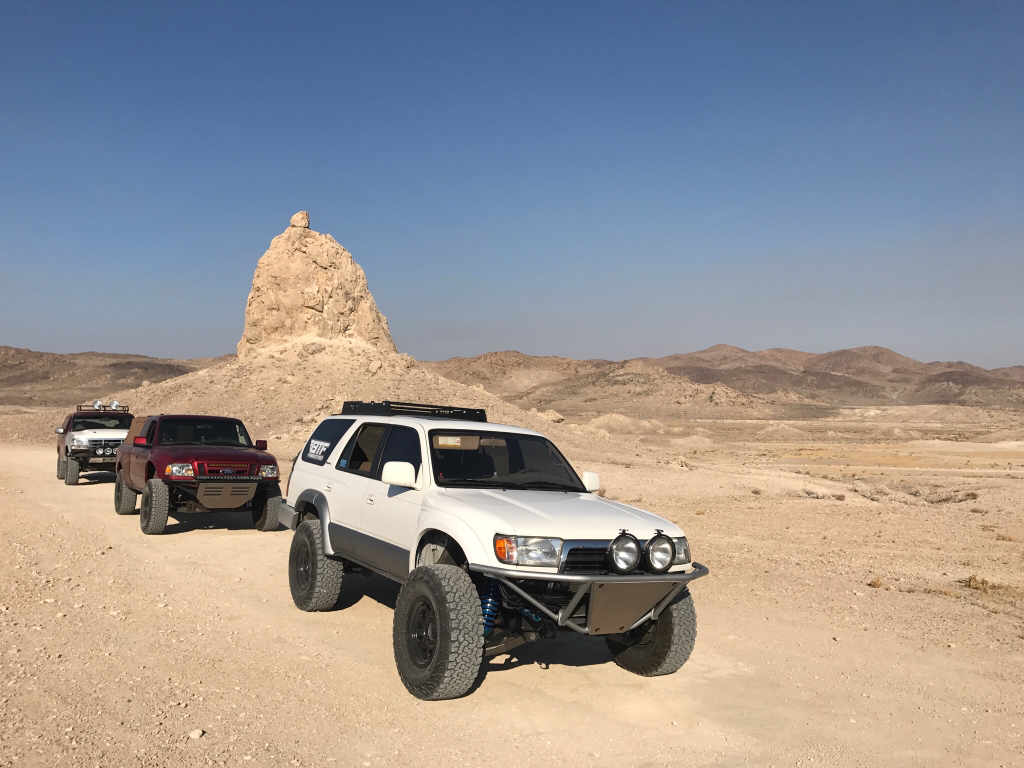

Did a quick run to trona pinnacles last weekend to watch the meteor shower.
Nice how you just fab stuff up on a whim. I just managed to mount my roof rack, my first welding project (well second if you include the broken spare tire carrier I fixed). Pretty ugly with the flux core, but I couldn't make the mig work. Maybe because I was welding to electrical conduit but I ground off the galvanizing.
I usually have ideas in my head for a while, until I have the extra cash and time to do something. It's a blessing and a curse doing this for a living and out of your own backyard shop to boot. I don't really get to leave "work" but my commute is great.
