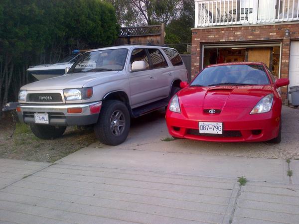

It's true, I'm not driving the 4R as much, now the Celica is my daily, but there is still plenty of things to do on the 4R, which includes a great deal of maintenance (its coming up to 310K)-- I just received a new Toyota rear tailgate latch assembly for Camelback, I had intended to install it but my sons' vehicles got in the way... This project may be a good reason to start a thread, as I consider my 4R in exceptional good condition- virtually no rust-- and if my latch is going bad I'm sure lots of others may be or, will be in the same boat, in the near future!! Not only that, whenever a 4R appears in the West Kelowna Pick N' Pull, the rear hatch is the first thing that disappears...

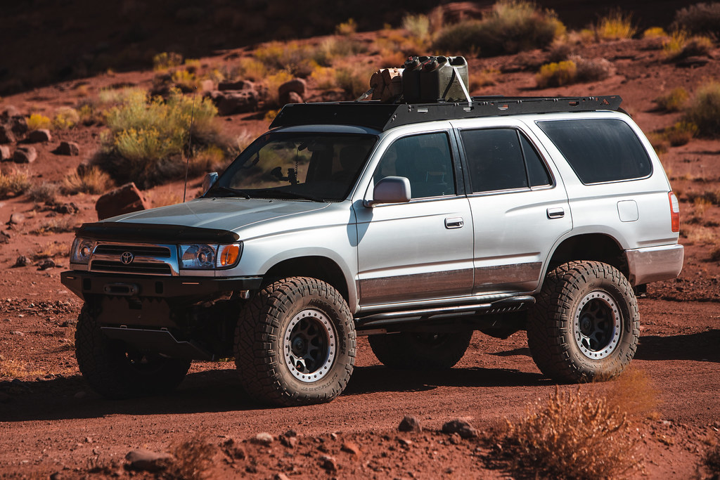

Eimkeith Rear Bumper:
This thing is a beast in it's own right. I have a full album of step-by-step photos on my iphone from building this. I should upload them to flickr and share them... they are only phone pics but it's probably a good resource, regardless.
THOUGHTS:
- have to tub rear quarters (not for everyone)
- I had to remove my sleeping platform to do the above, so that I could pull the side interior panels to tub/seal the inside of the wheel well properly (more time)
- Had to adjust body on bodymounts 2x (more time)
- lots of frame cutting, drilling, welding
- the above point made my "rust prevention" steps extra extra involving. I probably have 100+ hours into this bumper if you include all the paint prep, rinsing, priming, seam sealing, and dry times. Jealous of all you Californians who just spray paint stuff and forget about it.
- high clearance AF
- Loved all the critical pre-bent items, which make the finished bumper look nicer as a DIY job (see my Coastal Offroad bumper notes above)
- OEM running board cover really take this into the OEM+ league. LOVE THIS
- Took more time finishing it and welding it. Used a palm sander on the whole bumper after it was welded and grinded clean so help reduce the "lumps" from my shitty grinding abilities.
- Hella nice fitment with factory bodylines
- Best rear bumper on the market IMO, but be prepared for some serious time commitment.
Finished Product in the wild:
- OEM hitch receive plug. lol - its all in the details!
- Rally Armor "generic" mud flaps
_08I2358.jpg by Addison Rickaby, on Flickr
_08I6093.jpg by Addison Rickaby, on Flickr
_08I4756.jpg by Addison Rickaby, on Flickr

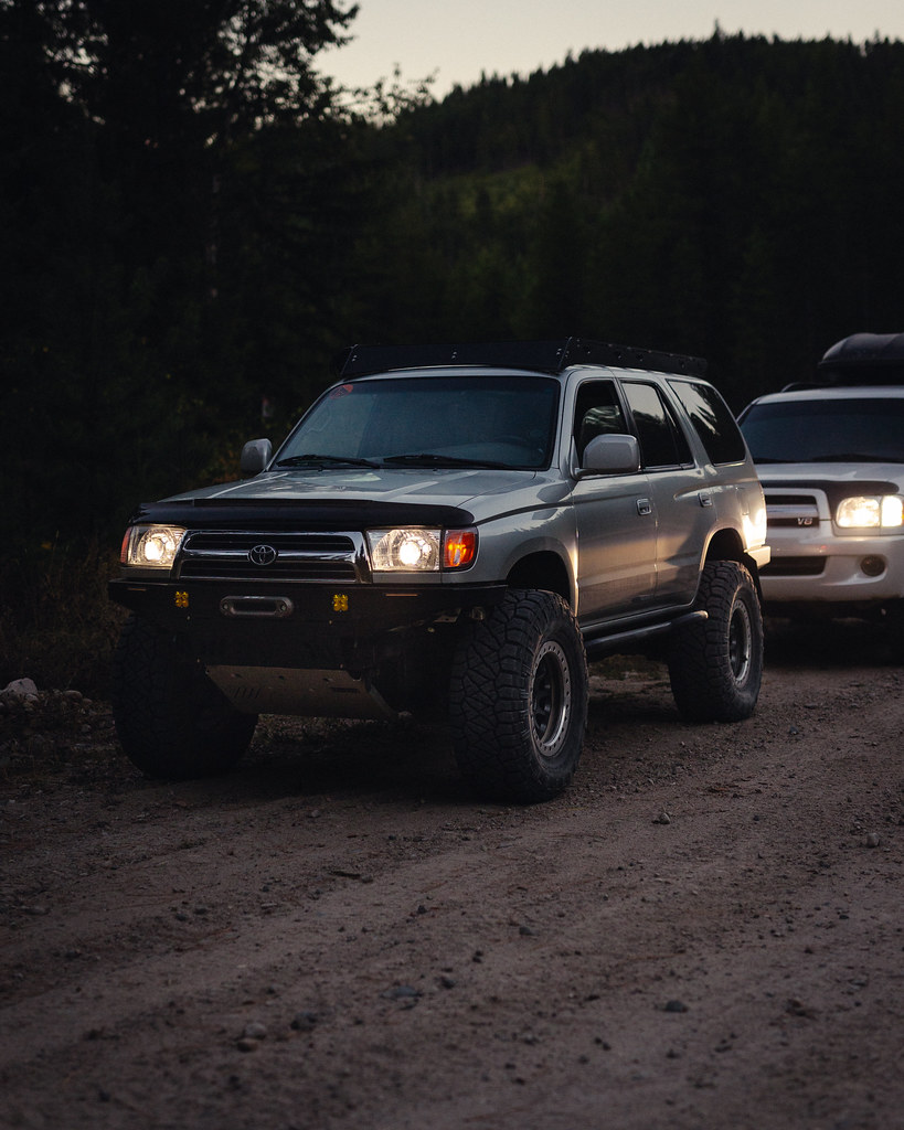

Semi off-topic but your headlights look awesome in this photo! It has that subtle "OEM+" look where a lot of people wouldn't even notice they've been retrofitted. What projectors did you use? Sorry if you listed it earlier in the thread, admittedly I didn't click back through to look. I still place essentially 100% of the blame on you for getting me into HIDs and retrofits. The WRX I picked up has factory halogen projectors so I need to pick up an HID conversion kit from DD, but I'm lusting after a full retrofit.

Headlights
Sometime last year I did a projector retrofit on the truck. I used to do this as a business when I was in University so I have done a LOT of retrofits. I went with the Morimoto Mini 5.0 D2S. I used to be kind of against these "thread in" projectors because the output quality was so much better with the OEM projectors. However, TRS and Morimoto have come a long ways and these new Mini d2S projectors are just so good right out of the box. I am running OEM Kioto ballasts (I had them professionally potted by an electronics manufacturing company to keep them moisture free) along with Osram CBI 5000K bulbs. They have been great so far and I still preach to people about how this is literally one of the best and most practical mods you can do - you use your headlights ALL the time.... way more than skid plates, sleeping platforms, and beadlock wheels ;)

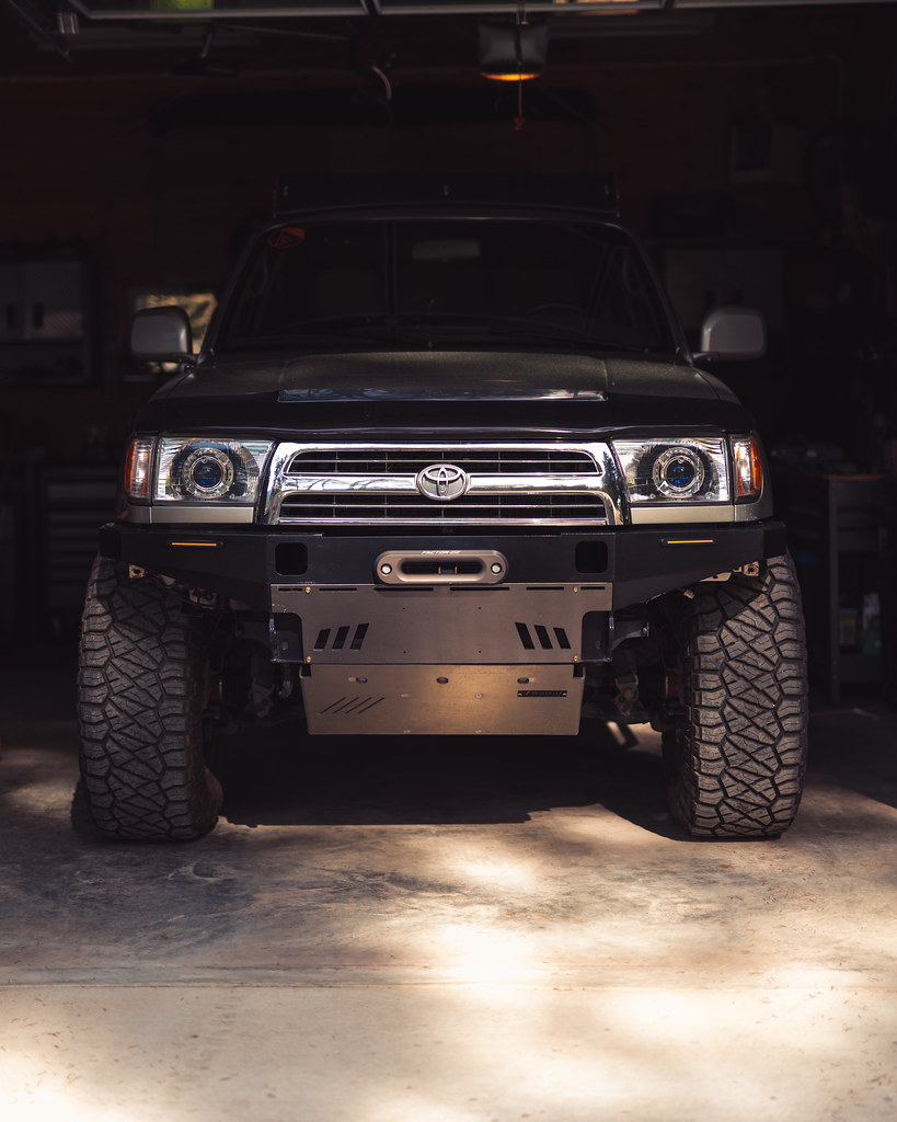

Headlights
I opted to keep them as OEM+ as I could, and kept them all chrome. Still have to think about wiring up the LED halos in the Apollo shrouds though..

Addison, I completely agree! I was initially intimidated by this mod. So I tried several 'high quality' bulbs, including some expensive LED replacements before performing this mod. And the Morimoto mini 5.0 D2S HID retro's from the TRS are such a big improvement to any and all of them. My only regret with the HID retro's is, I wish I would have skipped all the replacement bulbs and just did the retro first.
I used a video from another OG on here, [MENTION=8729]Speedy[/MENTION] as my tutorial and it made the project a breeze, even for a knuckle head like me....
