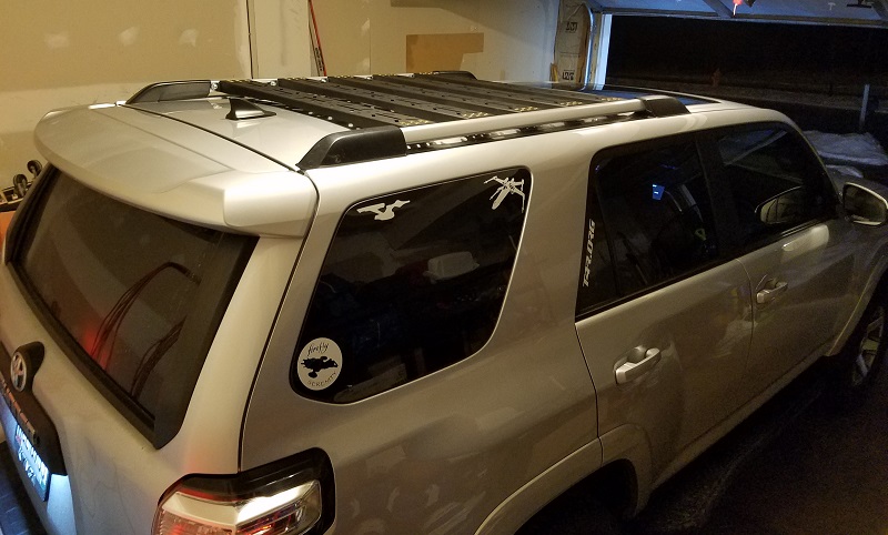

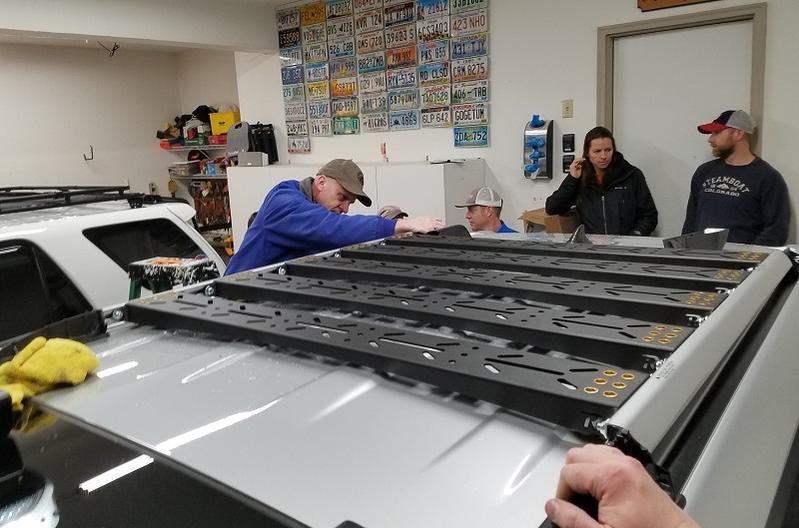

RagoRails are!
The OEM rails have an arch to them, RagoRails are flat all the way across the top so the highest point is actually the plastic cover on the sharkfin antenna. They're very sturdy and have plenty of places to anchor a tie down, or bolt accessories onto. They're also half the cost and build time of a rack.
For reference, there's a Gobi on the 4Runner in the background.

Do these generate much wind noise?

They're as quiet if not more so than OEM. OEM allow airflow under the bars and are widely spaced apart. These are very low profile, enough that I was initially concerned about them flexing into the roof. They don't, even with my not so small self on them. Mount your accessories during installation though, because even if you could get a nut under the bars after they're mounted, you'd have no way to tighten it!
