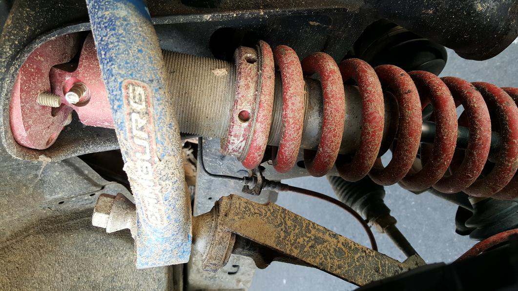

Front: ADS 2.5" Coilovers with Remote Reservoirs. 14" 650 pound coil. 2nd Gen Wheelers Bumpstops. Camburg Uniball Upper Control Arms. Ride is fantastic.

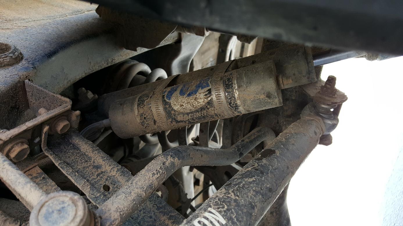

Rear: Icon 2.5" Shock with Piggyback Reservoirs and Superflex Rear Coils. Plans to link the rear in the near future.

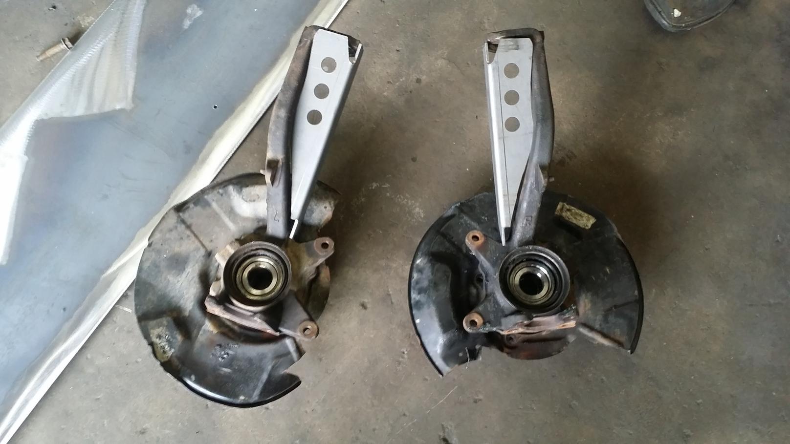

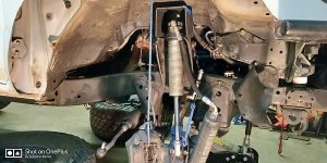

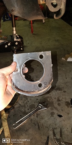

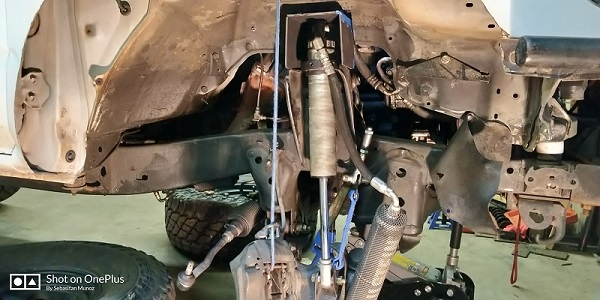

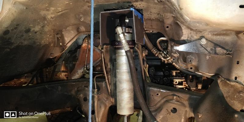

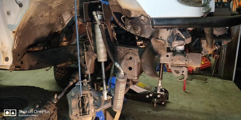

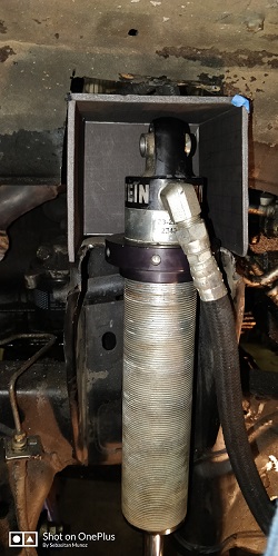

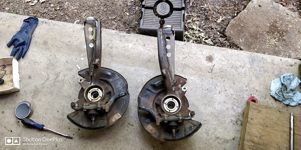

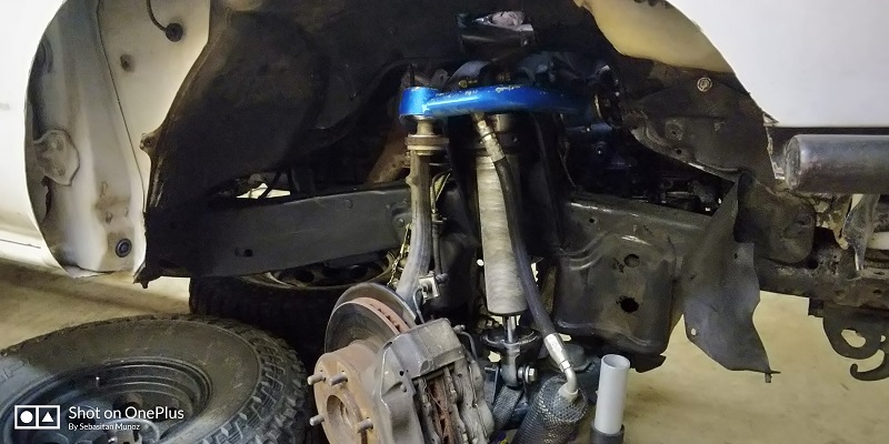

I thought I would provide some input here. I have had these coilovers in forever and decided it was time to get every mm of travel possible. IMG_20200517_211713.jpg
Since this is useless without documentation... here goes
Coil bucket cut and CO mounted back in

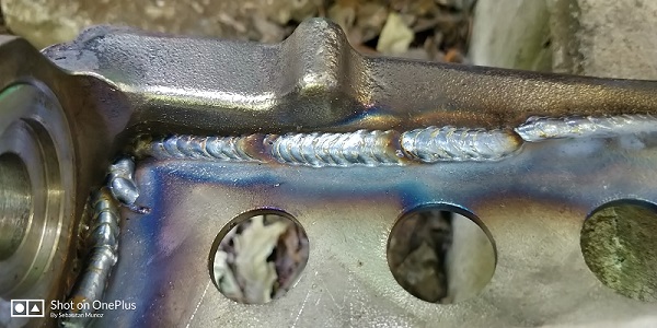

Spindle gussets welded up... I'm finally getting to be pretty consistent
All done and welded up!
The foam board is dimensioned and cut based on the CAD file dimensions, the final product will have internal gusseting, distributing the load all throughout the top of the coil bucket. Two 1.5" DOM tubes will come up from the frame to brace the coil bucket laterally.
Last, but not least I'll finally be using the limit straps that I've had for a few years :bounce:
Tabs and plates I will plasma cut out, and I am trying to find the best place to add tabs to the LCA for the straps. Time will tell!

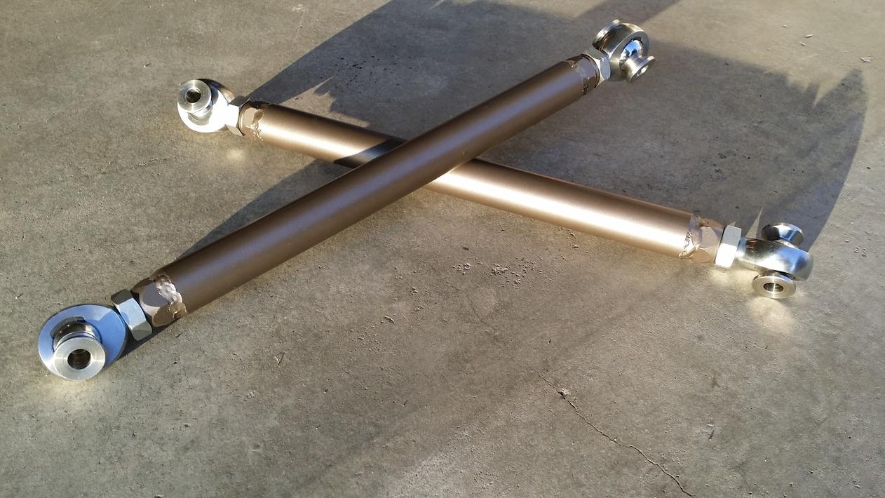

Hi,
May I know who builds the 1.5" extended LCA? Do they also build the CVs and steering knuckles?
Thank you.
For mid travel, there needs to be a 1.5" or 2" extended lower control arm kit. So you would increase trac by 3" or 4". The 3.5" kit is too much for me. But a slight increase would be cool, would have the benefit of more travel, and would also provide more stability on road. Who wants to build a mid travel lower a arm kit??
