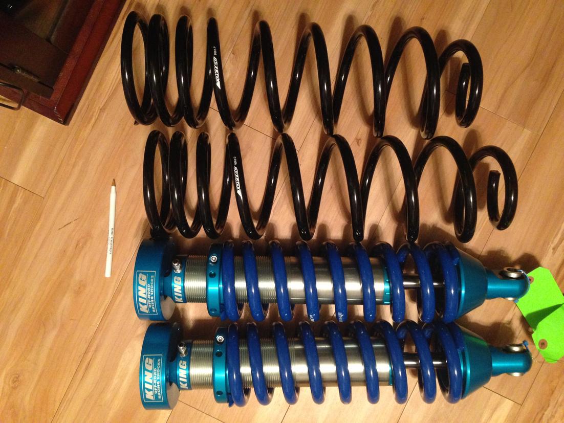

Hay everyone, so I plan on running the King OEM setup in the front and rear. And pair the rear with Toytec/Eibach 3" lift coils. Does anyone know the length measurements for the rear shock to give to King? I'm trying to avoid a lengthy break in period just to find the correct rear shock measurements.

**edit** I just noticed that the picture of springs/coilovers is in the post above yours. If you've not purchased the goods yet, hit up [MENTION=120150]TotalAutomotiveLV[/MENTION] and prepare to have your mind blown at the price they can offer you on an Icon Stage 2 (Coilovers, UCAs, and rear shocks) or similar setup from other manufacturers. I'd still be running my Light Racing UCAs had it not been for the stupid deal they gave me on Icon UCAs.
