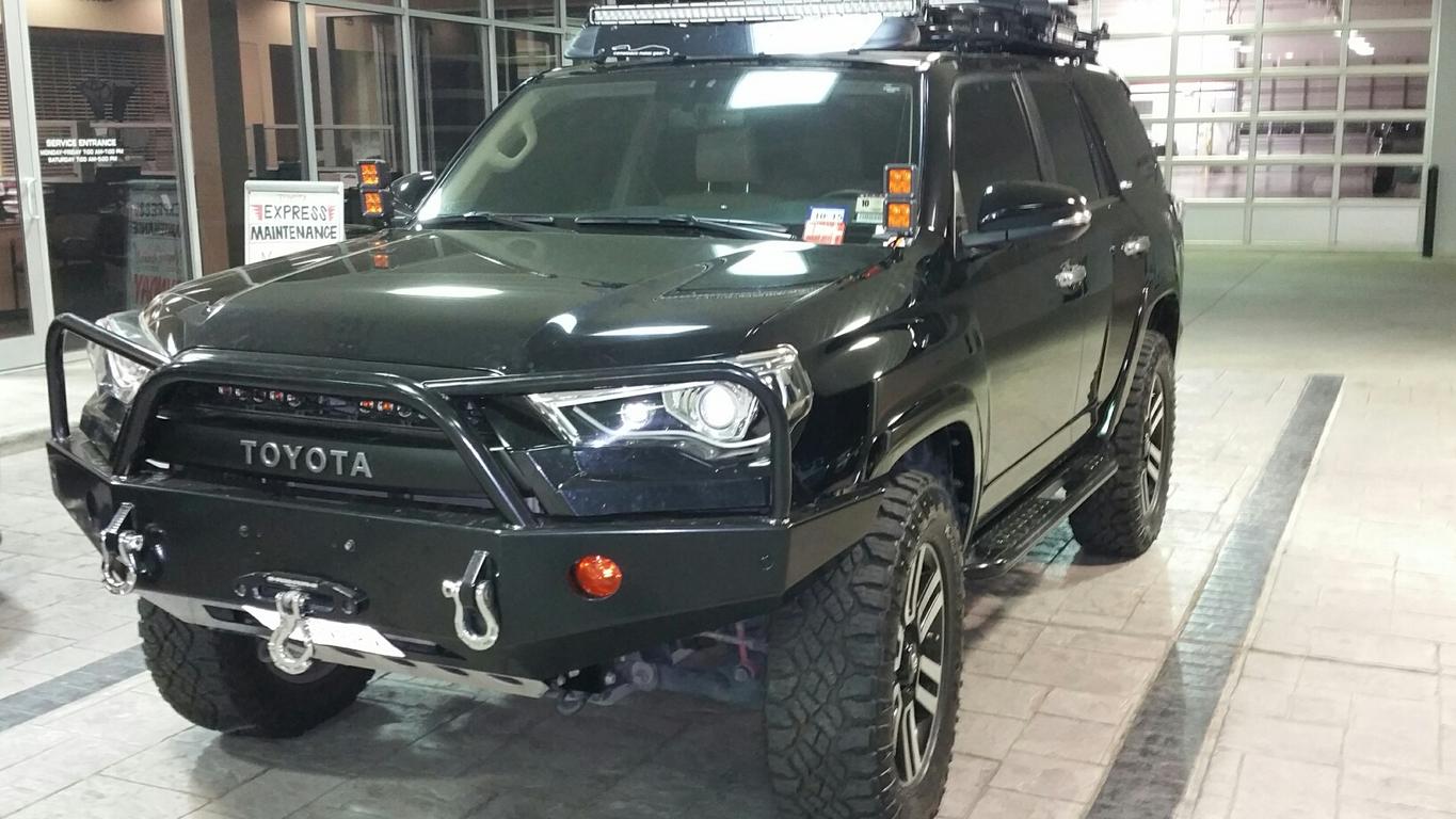

I faced the same issue and decided that it would be easier to add most anything I wanted to the Limited with 3rd row stock.
