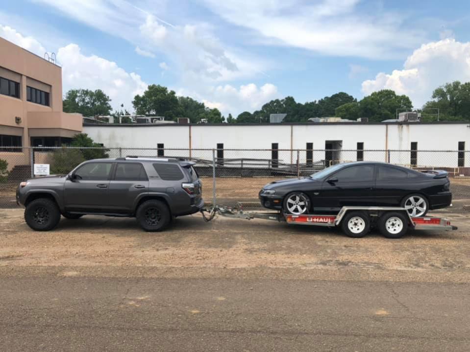

Not sure what this guy had as a setup but the car alone is 3725lbs. Definitely over the 5K limit but he said it did ok. I have a GTO and was wondering if I could tow it.

My 2011 4Runner is a great vehicle, but I feel like some of the metal is thin (for weight/gas mileage) and that concerns me when it comes to being robust for towing. I always worry more about what the hitch is actually bolted to and that makes a huge difference on what the tongue weight limitations are of a class 3 hitch. Tongue weight could be as little as 500lbs....or as much as 1000lbs. Just hope for flat smooth roads and keep the speeds under 55mph if you don't know the weight of what you're towing.
Tongue weight should be around 10%-15% of the weight of what you are towing.
If you are setting up 500lbs of tongue weight, then you are already at the max of the 4Runner's capabilities.
You should NEVER have anywhere close to 1000lbs of tongue weight. That's figuring around a 10,000lb load.
