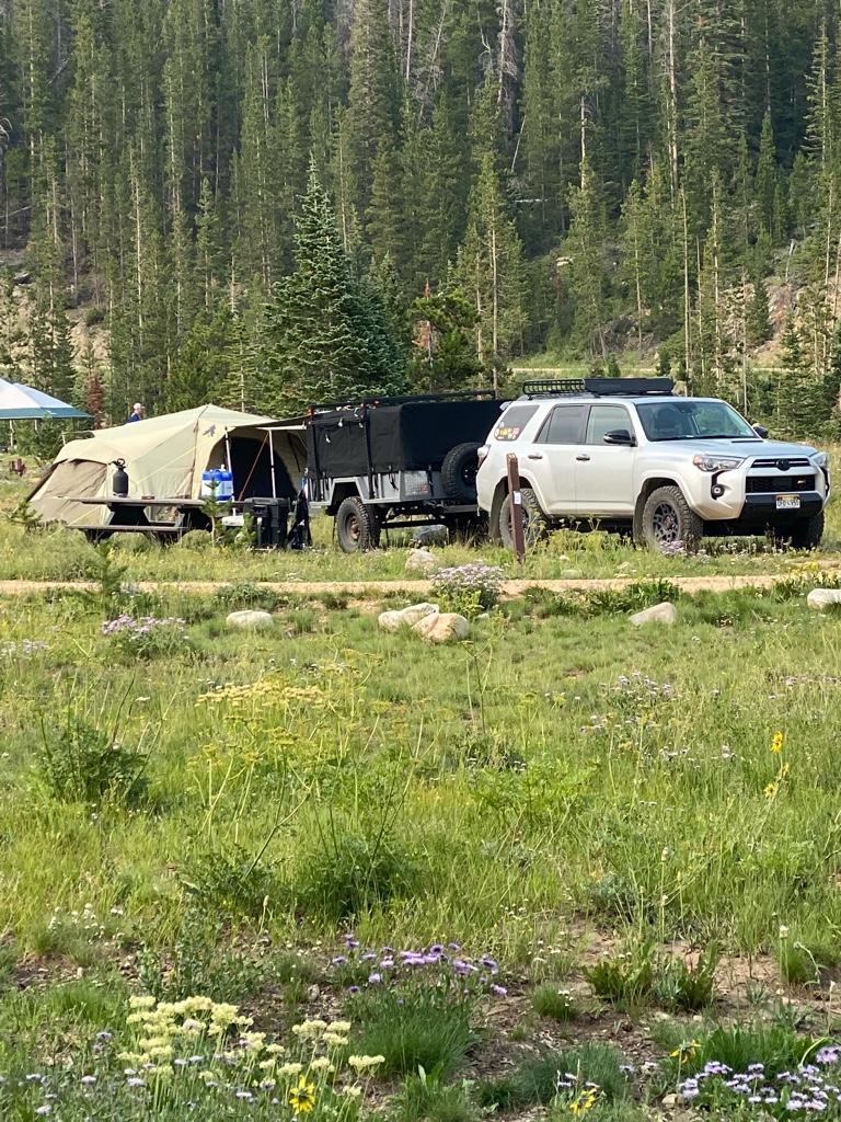

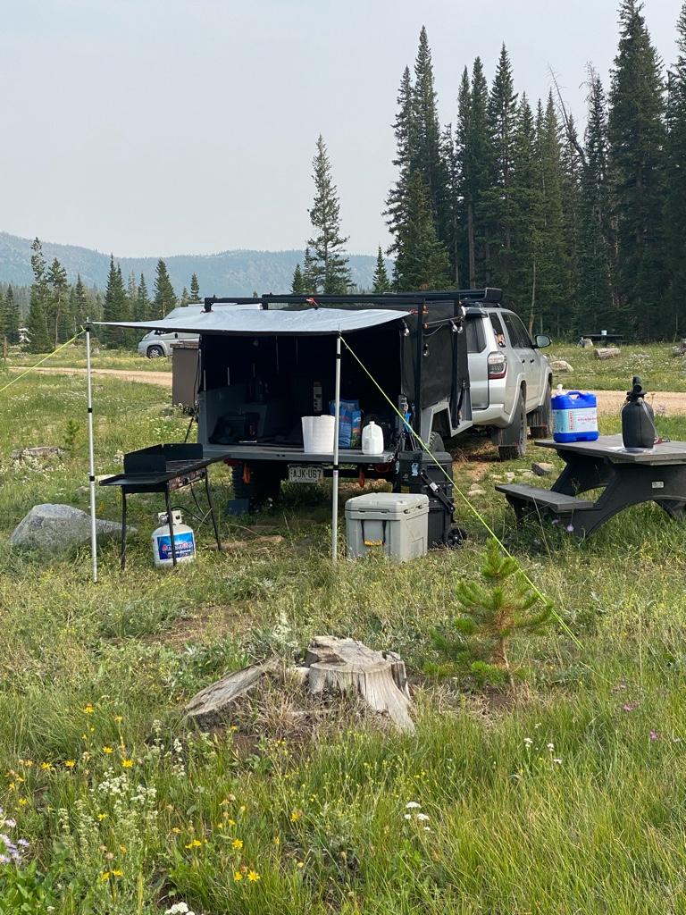

I tow an M101a2 military trailer. With all our camping gear, it’s probably 2500lbs. I’m in Colorado, so lots of uphill towing. I can say, towing with the 4Runner is not something I look forward to, LOL. Seems to spend ALOT of time in 4th, near red line when climbing up I-70 to Eisenhower tunnel!

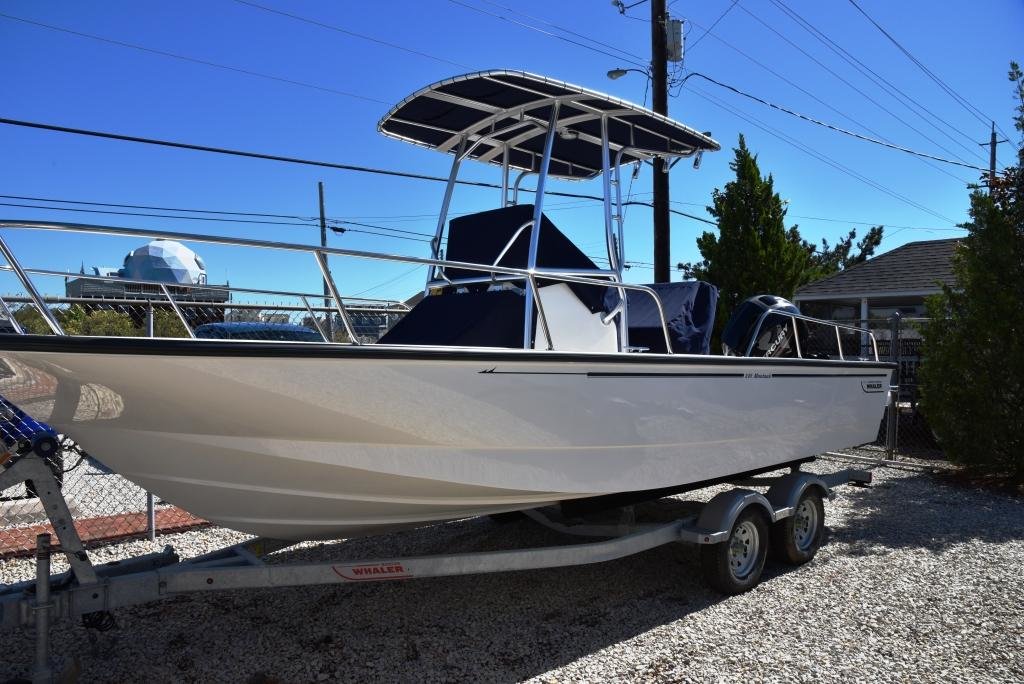

I tow my Boston Whaler 210 Montauk NJ to FL (~1,200 miles each way) and back twice a year with my 2019 4Runner Limited. My boat/motor/trailer comes in at 4,700 lbs - (certified scale), trailer has surge breaks. Tow at about 60MPH - mostly flat on I95. I never have had any issues (except gas mileage!) six trips so far. I do change the driveline fluids every 30k miles. The weak spot on the 4Runner are the brakes. The Gen 4's with a V8 where rated at 7,300lbs.

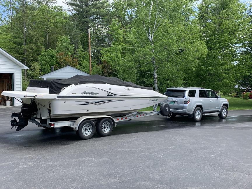

We also tow a boat with a 2020 4Runner. It is an Everglades 211. On a trailer it weighs in about 5000 lbs. We have been towing this with a 4runner since 2015, originally with a 2012 4Runner with 165K miles on it. We are in Florida and we keep in at 65 on interstates, less on back roads. Other than some rear end sag, which does impact low beam headlight aim, it tows without difficultly. We had no ill effects on our old 4Runner and none so far on this. Only had to replace brake pads once on our 2012. Interstate towing is not hard on the brake pads. Just a note. Do not estimate your load, go to a truck scale. I would have estimated our load at 4400 lbs dry, but with batteries, gear, cooler and a full tank of fuel, It can get to 5400 lbs. (I do not tow long distance with a full fuel tank on boat). Throw in 4 passengers and a lot of luggage and you can start approaching the GCVWR.
Towing to tow limit - it works but...
We've towed two boats with our 4Runners (2 4th gens and now a 2021 - the first was a 20 Bayliner on a single axle. It has a big V8 (the boat) but it all came in around 3,000 pounds. No problem anywhere, anytime. Our current boat is a Hurricane deckboat - comes in at about 3,800 pounds, 1,000 pound Venture trailer. The 2021 has, as you know, just under 30 hp more than the 4th gen but another 900 pounds of Toyota. Still, I find the extra hp overcomes the weight. Torque is solid.
Starting from a stop up a hill, it's a push - but it gets there - patience helps. Once at speed, no problem. On the highway, I have to watch out as it wants to go over 70. Up hills she slows a bit.
I keep her in 4th on most secondary roads unless it's a downhill slope, on the highway I keep her in 5th and either let the transmission do the work or put her in 4th on uphills.
What I like is that if I tow the boat a dozen times a year - it may not be ideal but it works nooooo problem but I love the 4Runner (over a big V8) for every other trip. I also tow a fully loaded 10' utility trailer with 1/3 cord of firewood, and all sorts of other lighter towing with absolute joy.
