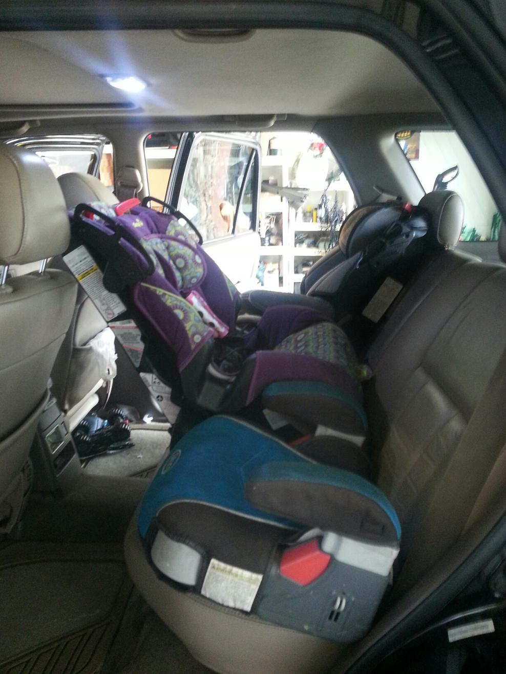

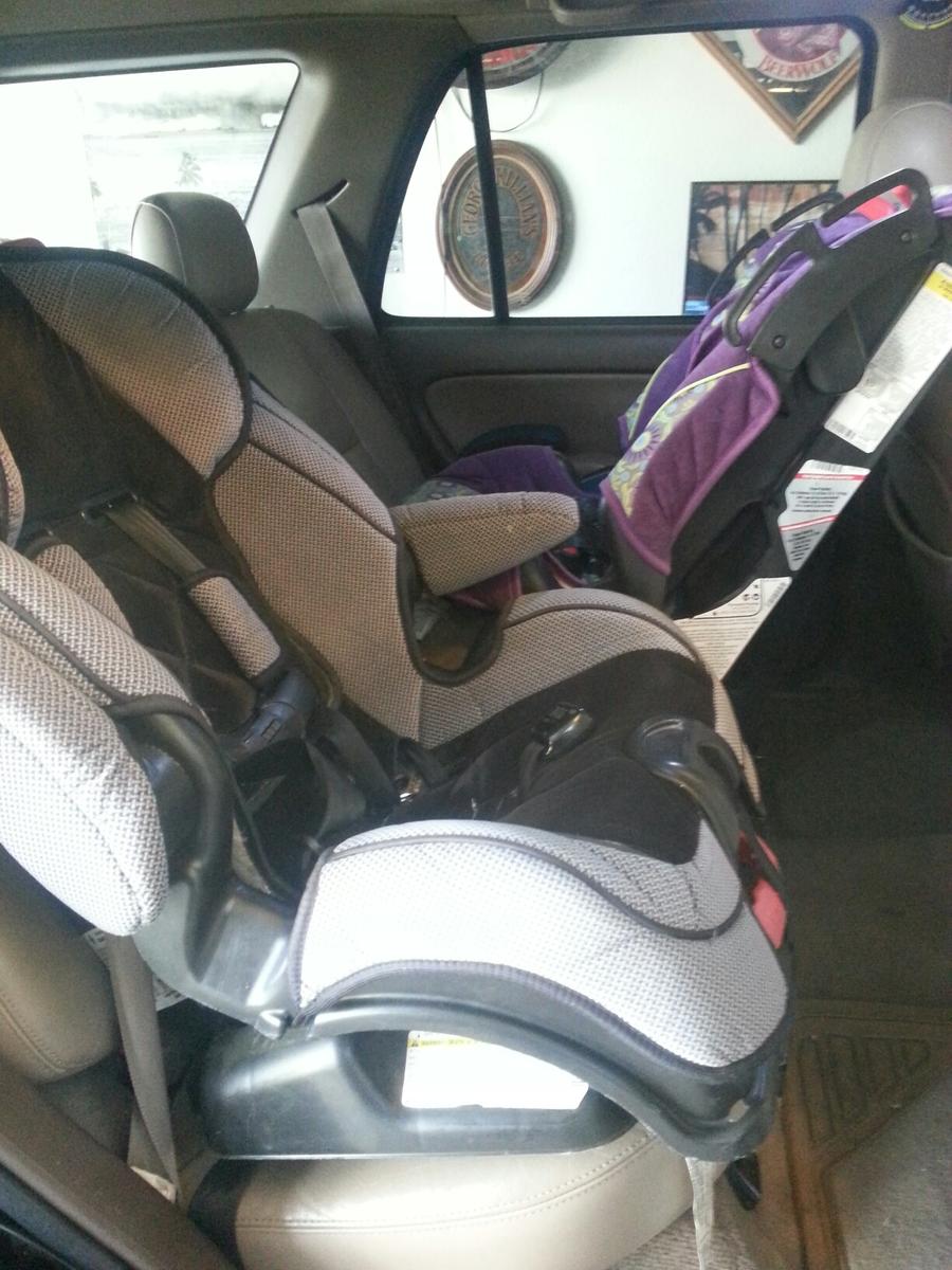

Here's a couple of shots of my backseat- it's a tight fit, but it works!
I looked but all I could find was this of the Sunshine Kids Radian 65. The girls were both out of seats by then, they just sat on either side, weren't squeezed and could easily get to the seat belt latch.
