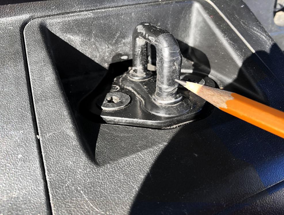

Try adding some electrical tape to the lift gate hook/latch on the rear bumper.
This did the trick for me,
but just to add-- the electrical tape doesn't go on top of the striker as you would expect, but on the rear-facing side of the loop, where the door latches.
Also the second time I added electrical tape, I noticed that the striker was loose. I used a torx bit, and tightened it down.
I was losing my mind prior to that. The rattling was driving me mad, and I stripped everything out of the cargo area.
I will check that out (loose striker) and add some electrical tape. Fingers crossed!

Any pictures of this? I think I've been having the same issue.
It's filthy right now, ignore the mess please. I go a little overboard with the white lithium in the wintertime.
the rear-facing surface is what the liftgate latch grabs on to. Tape goes where the pencil is pointing. Don't start with too much or your liftgate may not let go very easily when you press the button.
Thanks, I'll give that a shot today and see if it helps on my ride home. I did check the "striker", but it was not loose.
Well. Forgot to grab some tape before I left. But had some thin cardboard. Put it over the striker and.... seemed to work! Striker was tight.
So thank you!!!!
Is there a way to tighten/adjust the latch mechanism?
