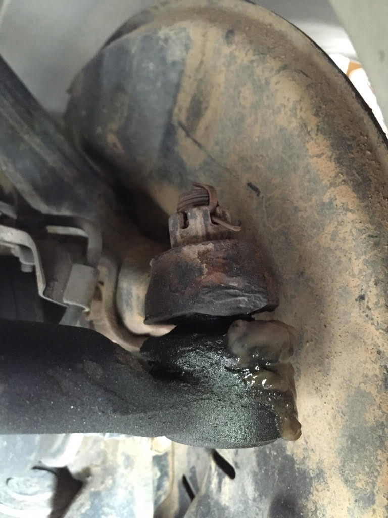

After only 26K miles on the T4R, I noticed this evening that the driver's side tie rod end is completely busted. I vaguely remember a loud clunking noise this morning on the freeway but I didn't think anything of it at the time. I know the repair is super easy, but I have a few questions I am hoping yall can help with.
1.) Any chance this is covered under warranty? Or does this fall under "normal wear and tear"? It's pretty obvious by the dent shown in the picture that it was struck by something.
2.) Do I need to worry about the dented hub damaging the new part? Particularly the small boot that sits right under it?
3.) Do new tie rod ends come pre-packed with grease? I don't see a way to lube them up if not.
4.) Is this an immediate concern, or is it safe to drive on a few more days?
Thanks!

It appears that someone has had your tierod end off at one time. That is what caused the dent and most likely causing the grease to leak. At any rate due to outside influence "the dent" this will not be covered under manufacture warranty. Yes it is a easy repair if you can perform an alignment. Lastly just because it is leaking grease doesn't mean there is any play in the joint. The rubber boot should be repaired to ensure proper lubercation of the joint but may not need replaced.

I would replace that TRE - OEM one is only like $55. Appears that someone disconnected yours in a very hamfisted way, causing the dent in the spindle and tear in the TRE boot.

Take it back to whoever "installed" the 5100s and have them buy and install a Toyota OEM TRE, and have it aligned. No, don't use a Napa one or skip the alignment.
Stand over their shoulder during installation to make sure they don't use a BFH in a stupid way, again. Loosen the TRE nut and hit the nut with a BFH, use a 2 jaw puller, or at this point use a pickle fork, as that boot is destroyed already.

I doubt someone who knocked it up like that will stand by his work. but OP Can try. if it was recent and he doesn't stand by his work cancel payment by the amount the dealer would charge to fix that under your CC.
