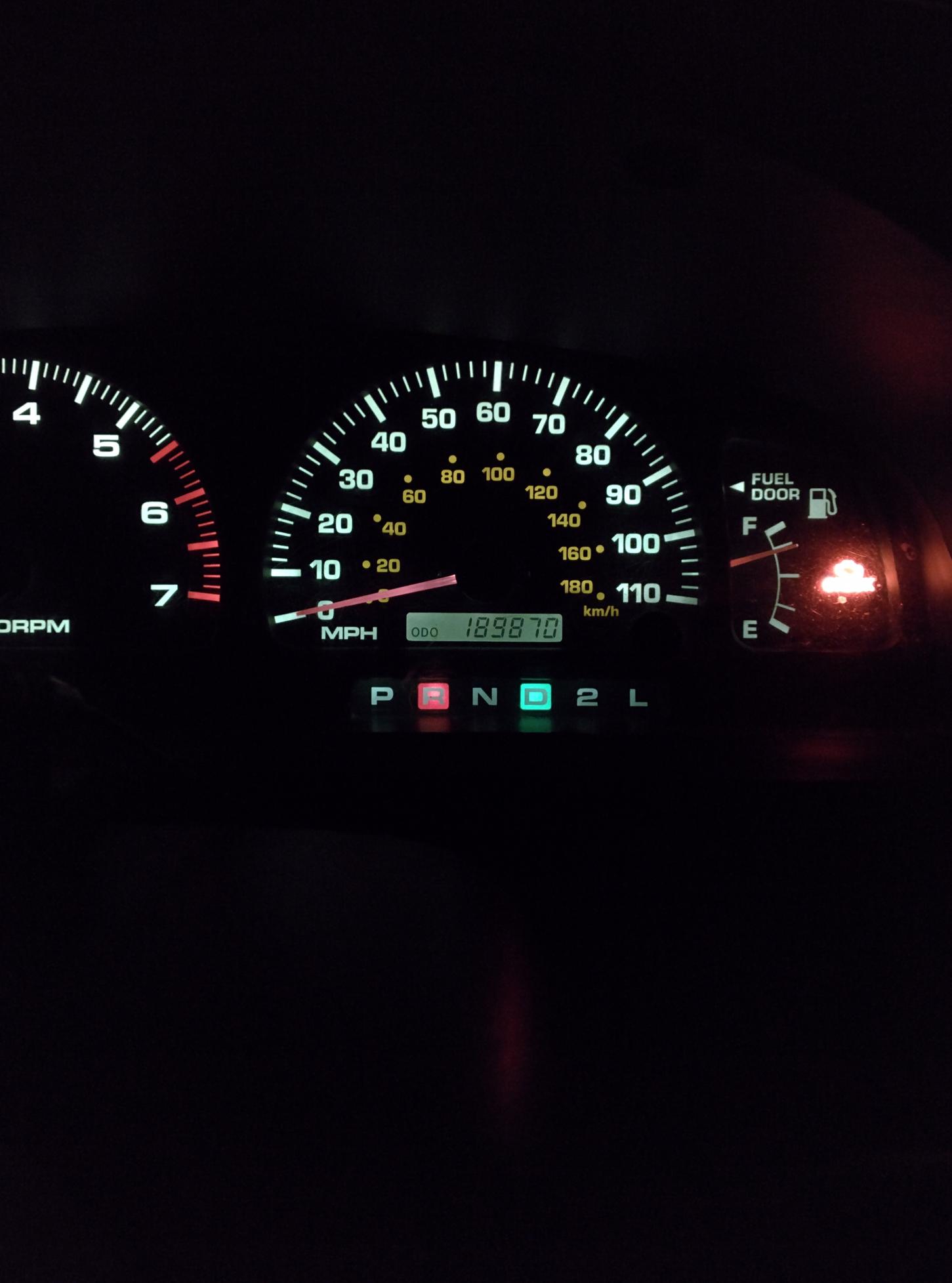

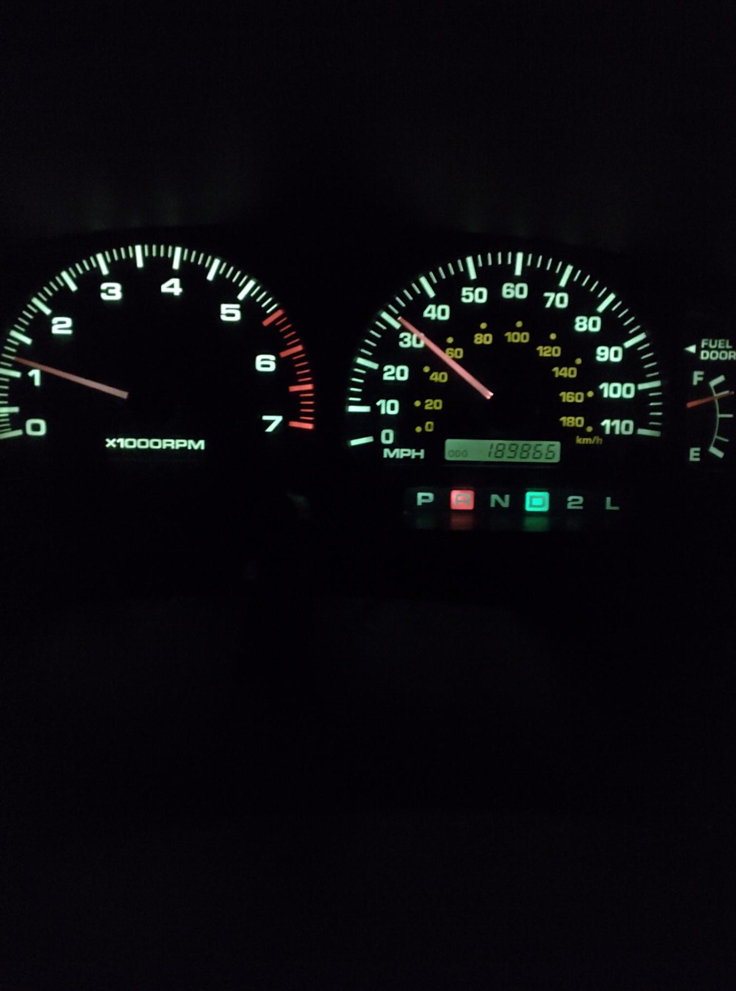

3. Strange CEL situation - I have an intermittent CEL (P0705 I believe is the code) that appears to be related to the PRNDL sensor. It only occurs on occasion, but on such instances, if I hit my Hi-Beams
it will kick my down into first until I turn off my Hi's and shift out of drive to neutral, then back to drive. I have read that this could be related to a printed
circuit board on the gauge cluster. It's not a huge concern, as I rarely use my Hi's, but it is still annoying regardless.
