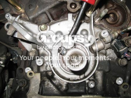

They are easy to change, it's much harder to put the new timing belt on, and to put a new tensioner in. There are Lots of ways to change the seals. I personally used my homemade crank pulley holder to hold the engine still, and while the old belt was still on cracked the cams loose using a breaker bar. Can also use an impact. After that it's easy. A seal puller is worth it's weight in gold, I bought the one from Lisle on Amazon. Takes 10 seconds to remove the old seal, use clean oil on the new seal and push it in. Most of the time I can get them flush with my fingers.

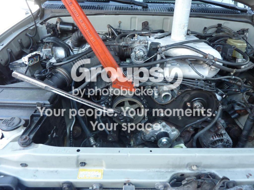

The cam seal removal way with a chain wrench:
297_zpsk0ko0hqu.jpg~original
Hmm a chain wrench is something i might not have, might have to ask some of my heavy machinery buddies. Ill have to get that seal puller too. Cool. Thanks for the info guys. Much appreciated.
