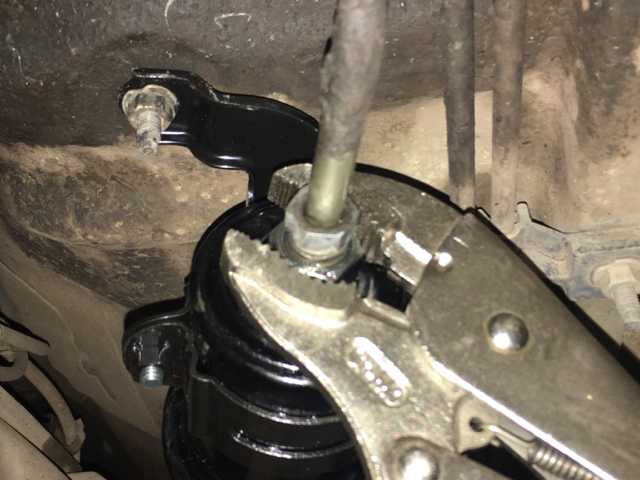

Finally replaced my fuel filter. Went to start it and fuel sprayed everywhere. Went back down and tightened up the fittings more. The back one is dry now but the front one has a tiny leak still. I can't figure out why I can't get it tighter. Thoughts?

Seems similar to my predicament. I'm going to try and re-do the front with the proper tool (flare nut wrench). I'm going to check the threads and then check the flare itself I guess (which I'm not clear on, but it's the flared part of the fuel line inside the compression fitting?)?

Just out of curiousity on your choice of wrench? why not use an open end wrench that would fit?
i used an open end wrench to hold that and another wrench to tighten the flared nut insert if that makes sense.
possible you got a bad filter.
Yeah, I don't have a 19mm open ended wrench anymore. Must have lost it back when I used to still lend out my tools. Lessons learned!
I'll pick one up when I go get a flarenut wrench tomorrow while I'm at it.
So much for a half hour job!
Edited: I couldn't stand it so I went back out to get the flare nut wrenches tonight. Sure enough, I got another 7th of a turn out of it with the right wrench and voila, no more leak (I think). Hopefully it stays that way!

Those flare's like to leak a TINY bit if you don't really crank them down. I loosened and reset mine like 5 times before it stopped leaking. I just kept the fuel filter loose, meaning out of the holder in my hand, so I could thread the fitting all the way in by hand. This ensures it is seated properly and your not crooked and ruining the flare at the end of the hard line.

Yeah, the back one was easy enough to thread by hand and then tighten the last few turns with an open ended wrench.
I'm guessing I cross threaded the front one. I recall it needing to be wrenched a lot earlier than the back one. Ah well, leak is done. I'll keep an eye on it and replace it if needed.
