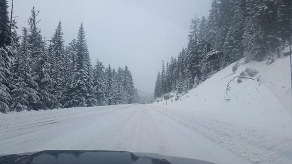

You may not need chains. I have a set of cable chains but have not needed them on roads with packed snow. Our 4WD system does fine. If you are going off road or on icy roads, then regular chains or even chains with V bars for ice may be needed.
No chains needed in this photo last winter:
