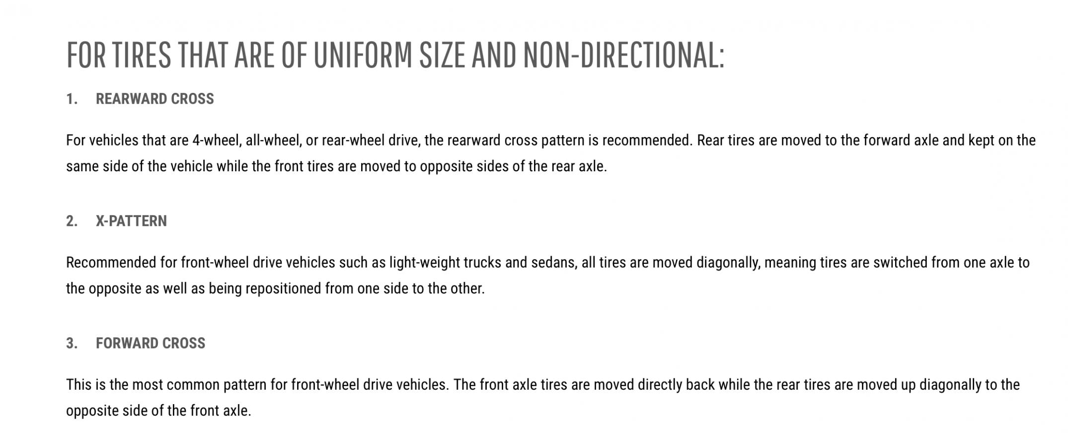

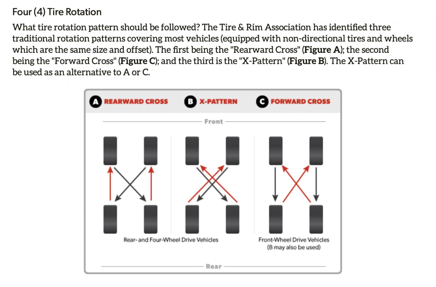

Tire Rotation - How to Do it
RichinRidgewood

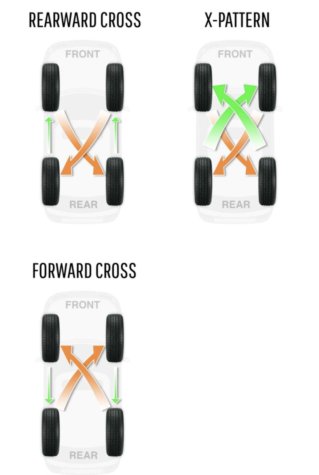

I used the X-Pattern since the biting front edges of the tread blocks are reversed on both the front and rears when the rotation is done.
Since most of the time our 4Runners are operating in RWD mode, the "biting edges" of the rear tires are to the rear of the vehicle due to acceleration and the biting edges of the front tires are to the front since the greatest forces are from braking. The biting edge will get rounded as it wears and the opposite side of the block will be sharper due to less wear forces. On the rear tires, the rotational leading ("biting") edge of the tread blocks will be rounded and the trailing edge will be sharp. On the front tires the rotational trailing edge will be rounded with the leading edge sharper.
So, by using only the X pattern, you are basically continuing to wear the blocks on the same sides with the rounded biting edge continuing to get worn vs. the front to back rotation that would alternate the biting edges of the tread blocks on each rotation. The front to rear part of the forward/rearward cross rotation patterns compensates for the condition I described and the cross part of the rotation pattern compensates for side-to-side differences in wear causes.
How much difference it makes... who knows?
The biting edge of the front tires is the front of the tread block (braking and steering) When in 4WD the rear of the block is the biting edge.
The biting edge of the rear tires is the rear of the tread block (acceleration)
That's what I said but thanks for simplifying it. I get a bit too wordy sometimes. Regardless, using only the X rotation keeps the same edges getting worn whether on the front or rear. This is because you are turning what was the back of each rear tire to face forward when it goes to the opposite side front and vice versa for the fronts moving to the rears.
I've always used the rearward cross.
That way each tire gets to ride in all corners before it returns to its original position.
This lets the tires recover from the front to back tire wear difference (middle of tire wear on rear and edge tire wear on front). Also, this lets each wheel ride in each corner with the different tendencies of each locations shocks, springs, etc.
Just my .02!
I always do the rearward cross rotation pattern on my SUV's, which are all Full Time 4WD (AWD) drivelines, not that it makes a difference.
Just my .02!
I can see how that’s a good idea. I can get the same effect by doing the following:
1st: X-cross
2nd: Front to back (edited)
3rd: X-cross
4th: Front to back (edited)
I think I will do that
1st: X-cross
2nd: Reward cross
3rd: X-cross
4th: Reward cross
You won't get the same effect by doing that.
Just follow one tire for example when you do X-cross first then rearward cross as you mention.
Lets take the left rear tire. Alright so it starts on left rear and on the first rotation (X-cross) it will go to front right. Now time for 2nd rotation (rearward cross) the front right goes to the left rear AGAIN. That's why I always did rearward cross as I mentioned earlier. When you only cross one set of tires (rear or front) you can get each wheel to every corner before it returns to its original spot in the rotation.
Ah crap.... I messed up .... I fixed my post
