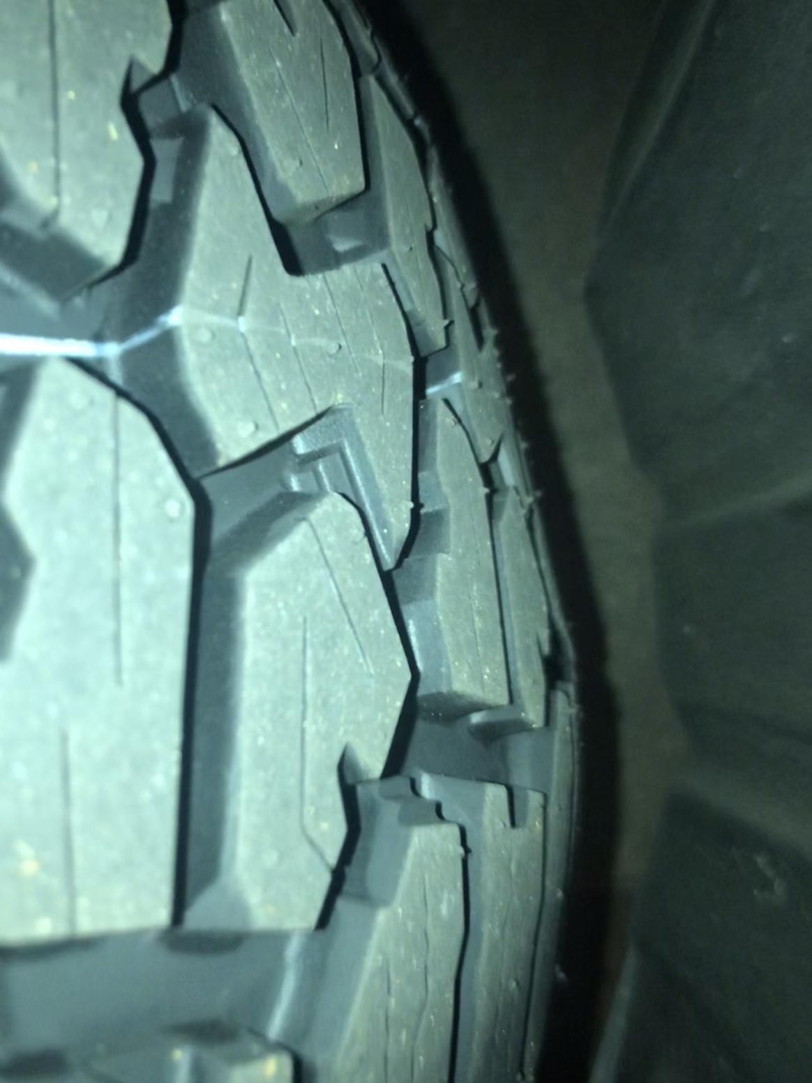

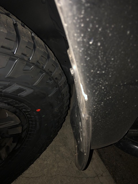

Yes, this is one of the considerations I made just stepping up from a 275/70-17 to 285/70-17 AT3W's this weekend. You can get a 285/70-17 anywhere and that size fits in the well. But, the bigger concern I would have is the performance. I can tell my shift points are a little longer now. The 285/70-17 is just about at the limit of turning my 4Runner into the gear hunter and I live in the hills and don't want that. I had a 1.5/1" cornfed spacer lift prior to the 285's and with light to moderate articulation I have no rubbing on my flaps or fender liner. I have about an inch in that position. Large image is the front fender turned to the closet contact on the fender liner with the right tire being pushed up with a view looking straight down inside the fender well. The second image is the left(driver) tire being pushed down off camber with about an inch from the mudflap. I know these trucks vary, but it does seem that the Pros have less of a clearance issue than the OR & ORP's. I know they come with the fender liner mod and I wonder if they have a different caster setting.

Oh yea Im not sure Id want to go up to 34 without regearing. For my line of work, Im driving up the 395 alot and boy with 285s one, you could tell the difference when driving up from Bishop to Mammoth. I just stick it in 3rd and cruise at 55ish mph lol.
Also, this is the Falken M/T (E) 285 when fully compressed. Had to remove the flaps but its still CLOSE!

I love the drive up 395. I haven't been up that way for about 8 years now. Would always go to Parchers Rainbow resort back in the day. The Sherwin summit, as I recall going to Mammoth from Bishop, is a long steep grade. Nice to know you are good when fully compressed. Suprised you couldn't pull 65 up that grade.
