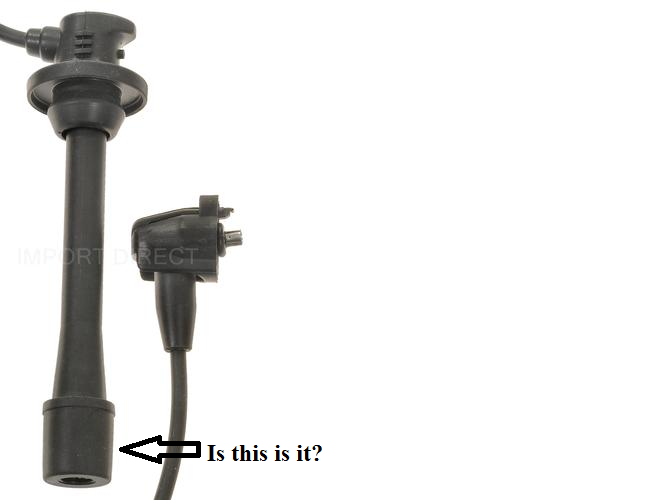

Are you talking the rubber plug end of the three spark plug wires? New wires come with these.
Or are you talking the three coil pack to sparkplug rubbers?
Are these replaceable without buying new coils?
Do you have a part number?

Hey Gerdo,
Not the rubber capping "thingy" that you place over the spark plug when you get new wires, but it is a sleeve that slides into the block of the engine. It is actually what the spark plug slides into when you change your plugs. Once they get old and dried out they tend to crack and the spark plug will arch off the block through these nearly invisible cracks. I will see if I can pull up a part #.
The tell tail signs are a tapping sound from the engine and if you inspect your spark plugs, there will usually be black streaks running the length of the spark plug on the porcelain.
So they are the tube that is in the valve cover, right?
Do you have to remove the valvecovers to replace them?
Nope you dont need to remove the valve cover. And yes, the tube that slides down into the valve cover.Once you remove the spark plug, you will notice that there is a sleeve that it sits in, just take a flat head screw driver and slowly work it out of there. I believe that they might only be on the side with the coil packs... which I believe is cylinders 1,3,5. My CEL code was for a misfire in cylinder #3 when I discovered it.

i think he is talking about the actual sleeve thats inside wall of the valve cover after you pull those out during a spark plug change.
^ Yes. And nope, that comes as part of the new wires like Gerdo mentioned. Like I said, I think they might be only on the passenger side of the engine when looking into the engine bay. Or the side that the coil packs are on. I wish I had a camera when I pulled mine, but it was broken.
The dealership list it as a 'spark plug boot' part # 702450. As stated above it believe there are only 3 since they are on the side of the engine with the coil packs. Hope this saves a giant headache for someone, it def would have for me.

I'm confused. Are you talking about the rubber boot that comes with a new set of wires or a coil pack? That doesn't go nowhere near the block as you originally have said. You actually bumped your own thread because no one responded to it?
You don't necessarily need to buy the whole wire set or coil pack to get a spark plug boot. They sell them seperatley you know. 5 bucks at Vato zone or even 12 bucks for NGK at Rock auto. Heck, Rock auto also has a pack of 3 Denso's if you a brand snob. http://www.rockauto.com/catalog/raframecatalog.php?carcode=1388707&parttype=10150. Just think. you could of replaced all 3 for what you paid for one. I'll hold on to my cents.
