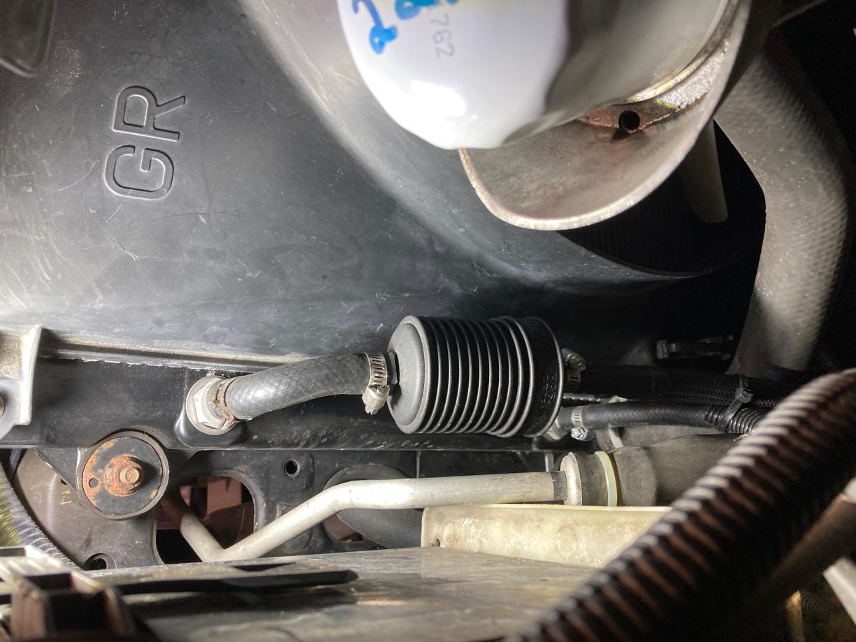

I bought my 2007 with 220,000 miles. Did a full fluid exchange with Amsoil and it made a big improvement in shifting. I now have 232,000 and still shifting like a new truck. Im pretty sure the fluid had never been changed before that. But I do go the extra step and add a Magnefine inline filter to the cooler line. New fluid will dislodge old crud and the filter will keep it from recirculating. Its $25 and gives me peace of mind.
