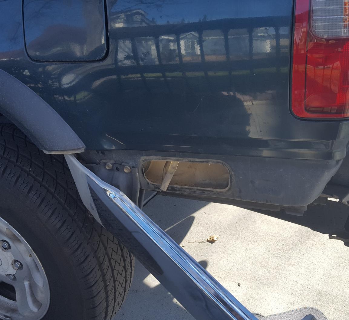

I'd start by checking that rear vent. It is right behind the driver rear wheel where there is a lot of dust. You should be able to reach up behind the bumper to feel for the flap.
If you are on 'fresh' air, it might not suck in dust, but if you are on recirc, it definitely will. Also, cracking the front windows will suck dust/air back in to the cabin from the back if the flap is missing.

I got a lot of dust from the rotted feeble rubber flap on that rear flow through vent, so I plugged the rear vent on mine. I replaced the door rubber with new OEM. I still get noticeable dust collecting around the rear door seals(both sides), particularly at the bottom.
I'm sure the foam on the fresh/recirc blend door has degenerated also.
