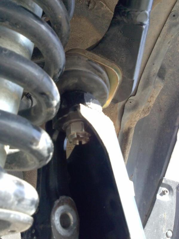

Anyone running the TC spindle gussets (the sway bar ones) with ball joint UCA’s such as SPC or JBA? I got in on a group buy on TW and learned afterwards that they need modification to work with a ball joint. Any help is appreciated.
No issues with mine and the icon delta joint UCA.
Thanks. I guess the issue is they’re meant for uniballs not ball joints. So the plate that goes on the bottom of there the UBJ meets the spindle doesn’t let the nut and cotter pin be installed correctly. Just looking for what types of fixes people are doing to run them.

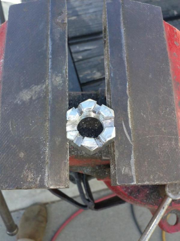

Had this problem yrs ago. Had SPC upper arms, and then did the TC gussits.
The SPC BJ length with the gussits installed was taken away.
Photos of the problem, and then my adapt and over come, (solution).
