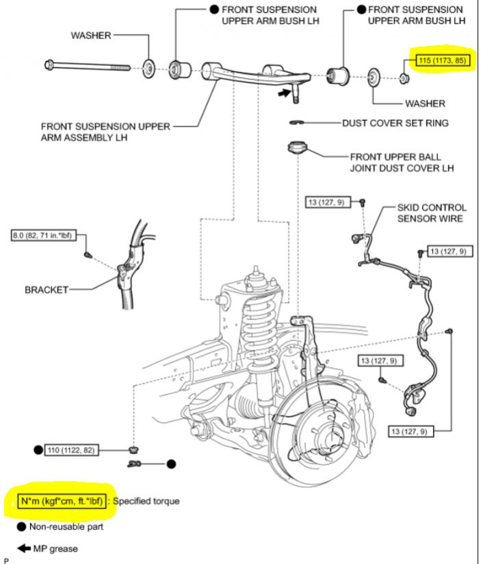

85lbf it is the same as OE. You are looking at Newton meters (which is 115) not foot pounds.
