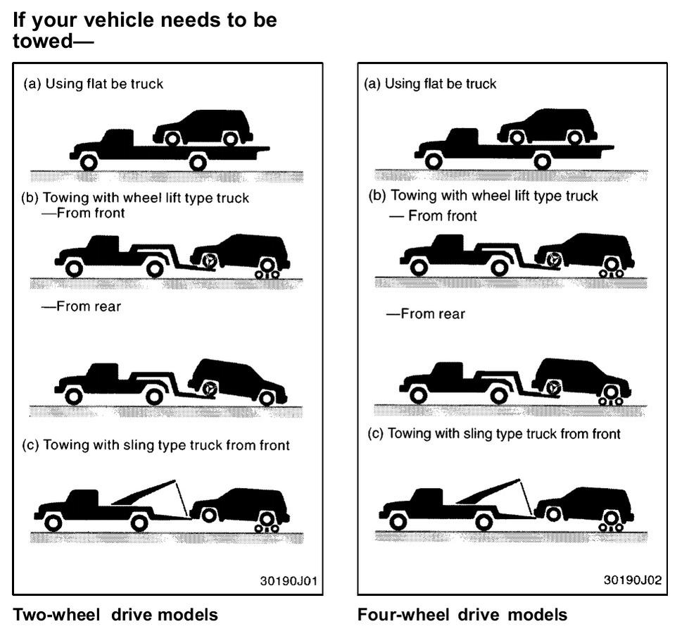

Is it 2wd or 4? Toyota says 2wd you can leave wheels on the ground, 4wd no.
I'm confused by all this. If I have a 4WD T4R and I need it towed, but I only have the 2WD engaged, can't I tow it like a regular, 2WD only vehicle?
If my 4WD T4R can drive on pavement without stress on the drivetrain in 2WD, then why can't it be towed?
The difference is when the engine is running it is turning/lubing things that don't get lubed when the vehicle is being towed. I don't know all the engineering behind it but apparently from the chart I posted above Toyota thinks 4wd models should not be towed with wheels on the ground.

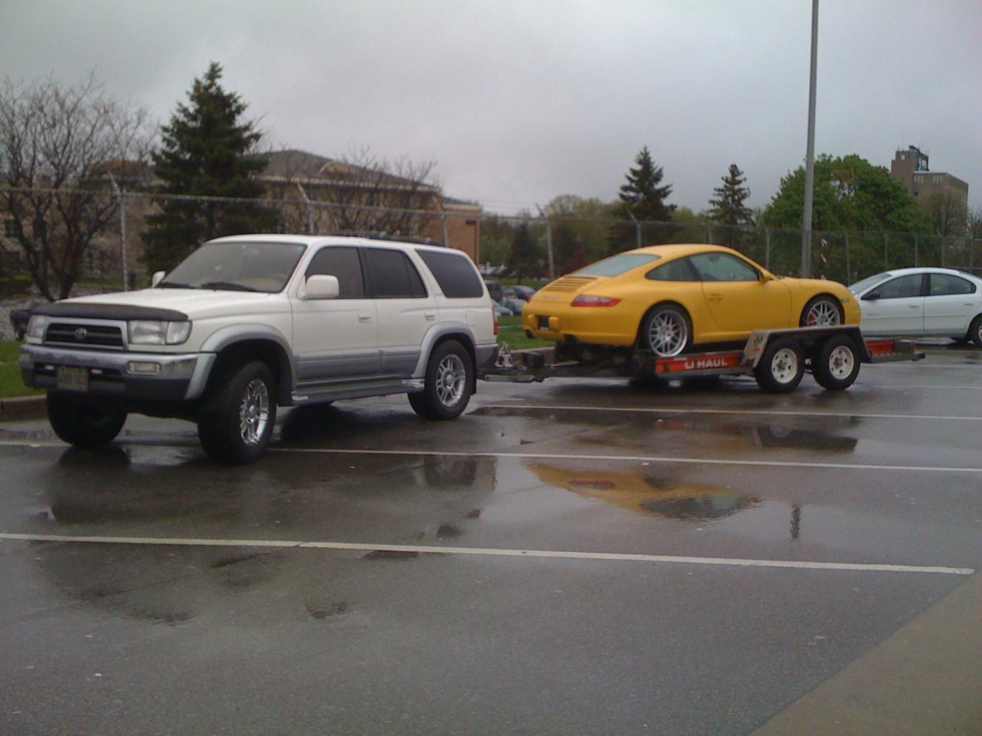

Pretty much at the limit but towed this without issue.
Check out the squat.

yooo..is this stock suspension?
