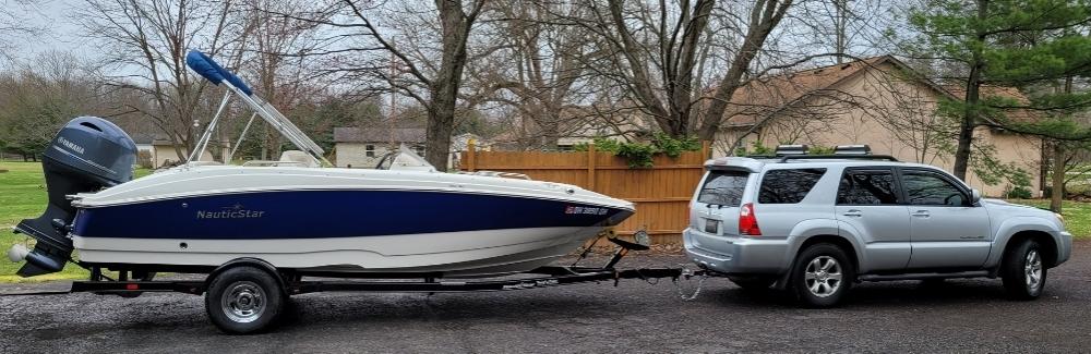

Picking up a 19 foot deck boat that I would guess weighs around 4000lbs total with trailer, and only vehicle I have is my 07 v8 4runner. I know the 4runner should be able to tow it but being a 15 year old vehicle I wanted to see if there is anything I should check before I tow? I have kept up on the maintenance and currently has 121k miles on it. I was going to check the brakes to make sure they are still good

Respectfully, the first thing you have to do is determine what it truly weighs. That's the only way to judge your vehicle's suitability. V8s have a higher rating than V6s so that's good.
If you plan to tow often, in hot weather, and/or in hilly terrain, you might consider an external transmission cooler. My build thread has some info on my cooler install though I'm unsure whether the transmission line setup is the same on the V8 4Runner.
You can look in section 3 of your owners manual. Which hitch do you have on the vehicle? Weight carrying or weight distributing? One will allow you a 500 lbs tongue weight, the other one will allow 700 lbs.
So you need a very precise weight of that 19 ft boat, or you might put some serious wear and tear on that Runner and ruin it.
I think I should be good as far as weight, of course I won't know for sure with out getting it weighted at the scale
2100 boat per mfg
377 outboard per mfg
186 gas tank 31 gallons
1200 guessing on a single axle trailer
Total estimated weight 3863lbs
I tow my Rinker 21’ IO with my V6 2007 Tr4 and I added a tranny cooler to help with heat. I also swapped ATF with Amsoil synthetic to better handle heat on those hot days. My 21’ boat is 3,200 Lbs. Google your boat specs. Its out there somewhere. Get a good hitch and ball. Make sure its rated @ 5,000# or better. I had a cheapie 5,000 hitch and bent it while launching the boat. Spend some money on safety items. Your trailer should have brakes at that weight. Make sure they work and also change your brakes on the truck. I have the sport which has bigger brakes from the factory. If you dont, consider upgrading the caliper and rotors. Think about a new radiator if you still have the original. Its cheap and easy to do at $100. Lastly, drive in 4th gear. This keep the heat down in the tranny. The V8 is a great power plant for towing. Enjoy, summer is almost here
That V8 should have a weight distribution hitch and an external transmission cooler already but you should double check. Add some airbags in the back if you are squatting with your load.

Made the hour and half trip back home with no issues. Majority of the time I just kept it in 4th gear with a few times going down to 3rd just so I could pass people. Kept the speed on the interest between 60-70. I did notice if I went over 75 I would get a little more sway but nothing crazy

Nice boat. Just be careful doing 60+ mph with a single axle trailer. Get a blow out, and the trailer will be driving you. :angel:
