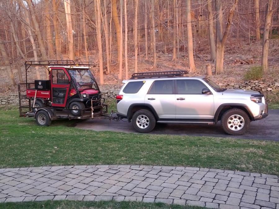

Towed a Mule with a full cab a few of times prior to the airbags...just interject some common sense..
