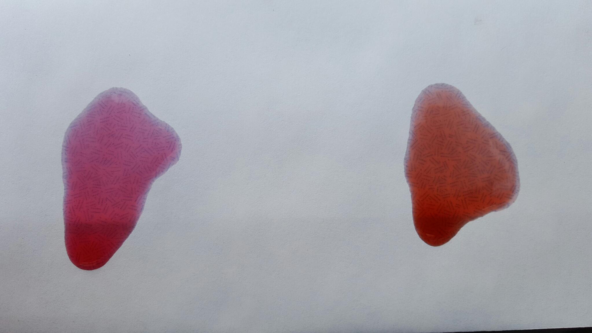

I've read the threads on the board about using MaxLife ATF vs the Toyota WS fluid and seen sides for both. Yesterday I did the 4 quart drain and fill with OEM WS Toyota Fluid (Pic Attached-new on left old on right). I am trying to understand from the community if you have MIXED both during a fluid change? I have 4 quarts of new MaxLife and was considering using that in about 100 miles to do the 2nd 4 quart drain and fill but am somewhat hesitant due to other threads talking about the conditioners or additives that MaxLife may or may not have when compared to the OEM WS fluid. So was asking if anyone has had success or not when mixing the two during a fluid exchange and what if any issues you may have had. Some context on my v8. At 100K...did full OEM WS fluid exchange. At 150K did another full OEM exchange, at 220K have done a 4 quart exchange with OEM WS fluid. Thank you for your input

I did it. Almost 2 years and about 38k miles later, nothing to report other than all is good. Here's my blurb I wrote on it in my build thread back when I did it.
Hope that helps. Oh and I accept no liability for whatever you decide to do lol. Good luck!
Thank you for the thread, very interesting to read. Sounds like you did a mix when completing your WS and MaxLife drain and fills. At this point 2 years later are you still running a mix or are you completely filled up with MaxLife at this point. Any issues you can note?
I guess you could say it's still the "mix" in there. My thought was that I would do a number of drain and fills with MaxLife to dilute or flush out the old, but on my last fill, I used WS only thinking that would be the majority of what remained in the case, if that makes sense.
Nope, like I said, no issues at all regarding the transmission. Still probably the best automatic transmission I've ever driven.
