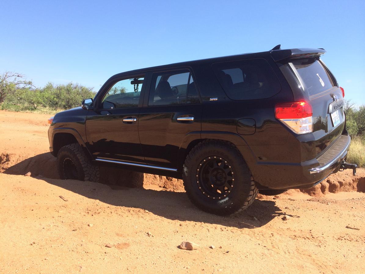

Ive talked with cmlesschwab in depth (Thanks Buddy) about his 35" set up and he is very happy with his rig and says the rubbing is minimal, he has been running this set up for awhile. He has some pictures with his rear completely stuffed and it looks like it works quite well. Im not saying 35's are optimal, but it can be done on a dialy driver no less.
Please please post a picture of 35's on a 5th gen 4Runner after cutting and without any rubbing.
PS: Those front body mounts only get in the way right?
PS PS: Since suspension goes up and down the tires will have to fit into the rear wheel well at full stuff too. No cheating!
Here are some stuffed 35's... This is cmlesschwab beautiful rig, I hope you dont mind me uising your pics...
